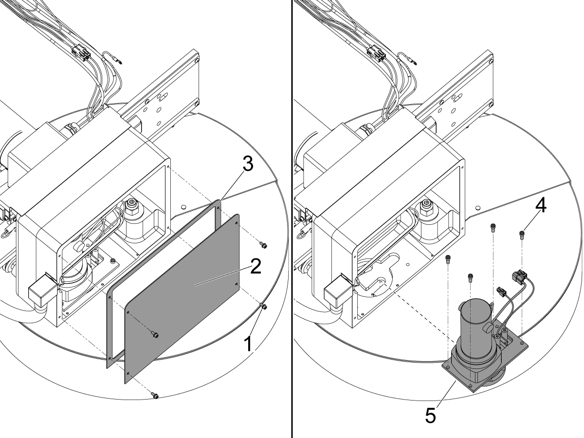

Remove the (4) 10-32 X 3/8 bolts [1] that attach the enclosure cover [2] and gasket [3] to the carousel motor enclosure.  Remove the enclosure cover [2] and gasket [3].
Unplug the sensor and motor cables.
Remove the (4) 1/4-20 X 5/8 bolts [4] that attach the carousel motor assembly [5] to the carousel motor enclosure.  Lift the carousel motor assembly [5] up and out of the carousel motor enclosure.

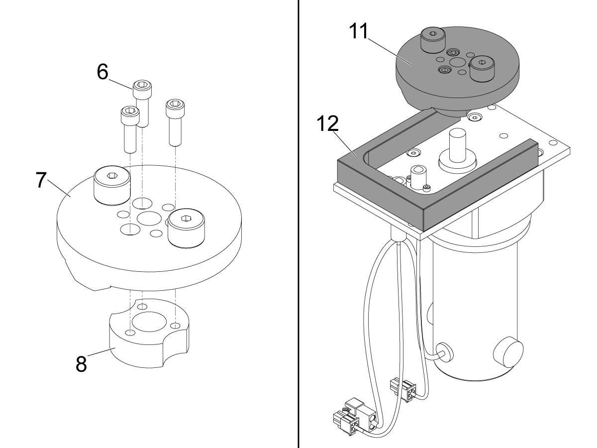

Prevent the geneva driver [7] from rotating by placing a screwdriver between the cam followers.  Break loose and remove the (3) 1/4-20 X 3/4 bolts [6].
Screw the (3) 1/4-20 X 3/4 bolts [6] into the threaded holes on the geneva driver [7].
Evenly tighten the (3) 1/4-20 X 3/4 bolts [6] until the geneva driver [7] and collar [8] unclamp from the motor shaft.

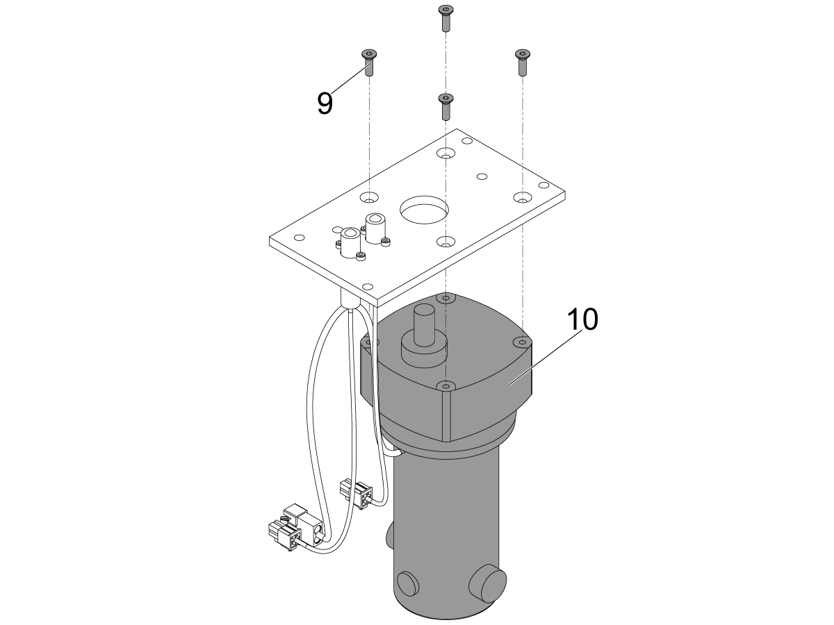

Unscrew and discard the (4) 10-32 X 5/8 machine screws [9].  Discard the broken carousel motor [10].
Note: The (4) 10-32 X 5/8 machine screws [9] are secured with red loctite.  Use an impact driver to remove them.

Install the new carousel motor onto the the mounting plate.
Place the (3) 1/4-20 X 3/4 bolts [6] into the counter bored holes in the geneva driver [7] and screw them into the collar [8] a few threads.
Set the 2-Pin Geneva Drive Spacer Tool (T-2662)  [11] on the motor mounting plate as shown.
Install the geneva drive assembly [12] onto the motor shaft and orient it so that one of the flat sections at the top of the ramps is directly above the TT Clamp sensor.  Press down on the geneva drive assembly [12] until the flat sections at the bottom on the ramps are flush with the 2-Pin Geneva Drive Spacer Tool (T-2662) [11].
Prevent the geneva driver [7] from rotating by placing a screwdriver between the cam followers.  Torque the (3) 1/4-20 X 3/4 bolts [6] to 12 ft*lbs.
Remove the 2-Pin Geneva Drive Spacer Tool (T-2662) [11] and spin the geneva drive assembly [12].  Make sure it does not interfere with the proximity sensors.
Reinstall the carousel motor assembly, gasket, and enclosure cover.
