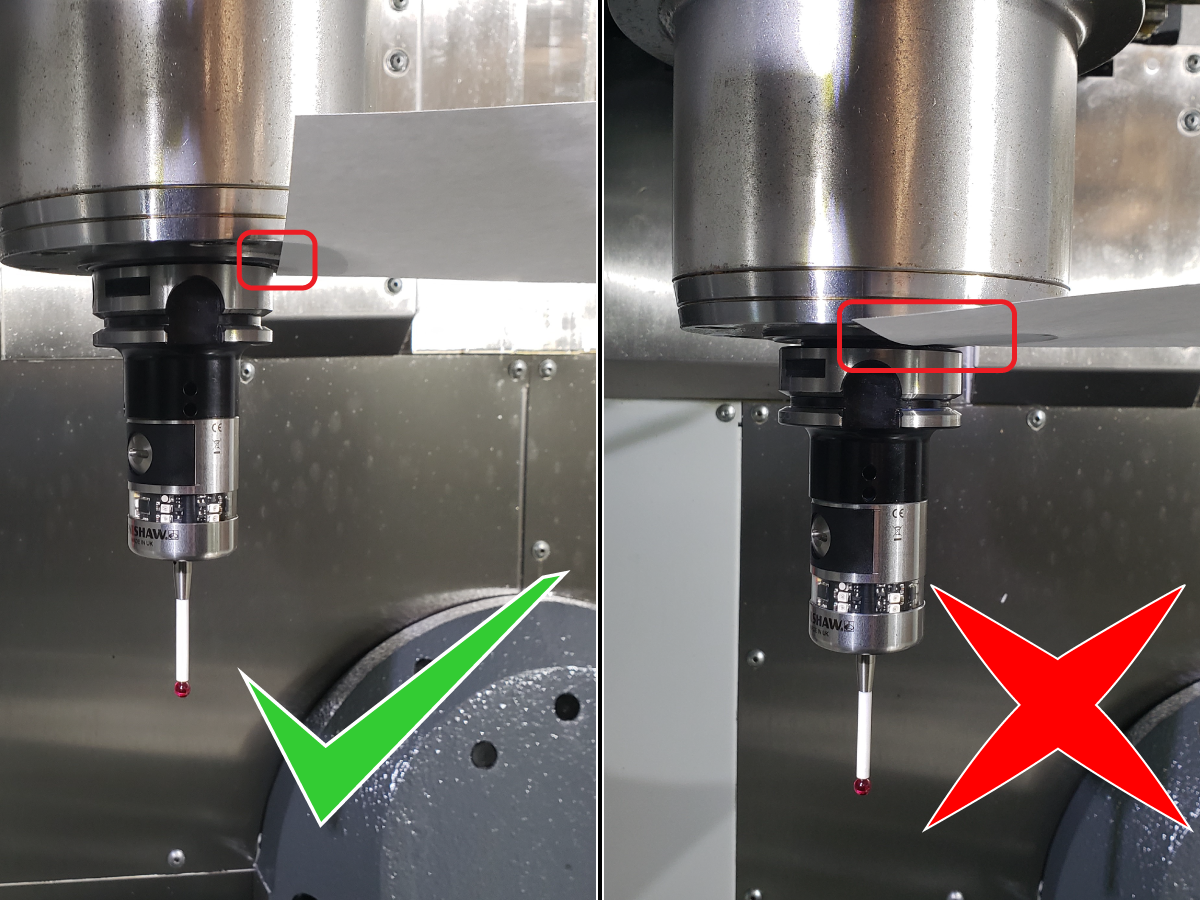

HSK - Spindle Probe Seating
When the probe is inserted into the spindle, it is possible that the probe may not be seated correctly. This will cause z-axis positioning errors for the cutting tools and may result in a scrapped part.
To avoid this problem, do the following:
  • Perform a tool change so that the probe is inserted by the double arm, not by hand.
  • After the probe has been loaded into the spindle check with a piece of paper that there is no gap between the probe and the spindle taper (see image to the right).
  • For Haas HSK A63 Spindle: If there is a small gap, refer to Set TRP Clamp Switch section in the HSK-A63 - Spindle Drawbar - Push Out procedure and adjust the clamp switch as described.

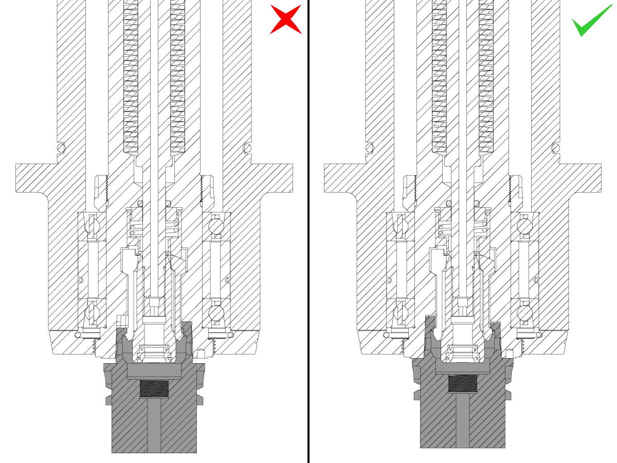

HSK tool loading
Push tool release.
Insert the tool holder into the spindle and if the face of the tool holder does not mate flush with spindle face the tool is not oriented properly.
Remove the tool holder and rotate it 180 degrees.
Reinsert the tool holder and confirm the faces mate.
 WARNING: If a tool is inserted 180 degrees out the spindle will not rotate, however a tool change can be commanded which could cause a tool change failure or the tool to be dropped.

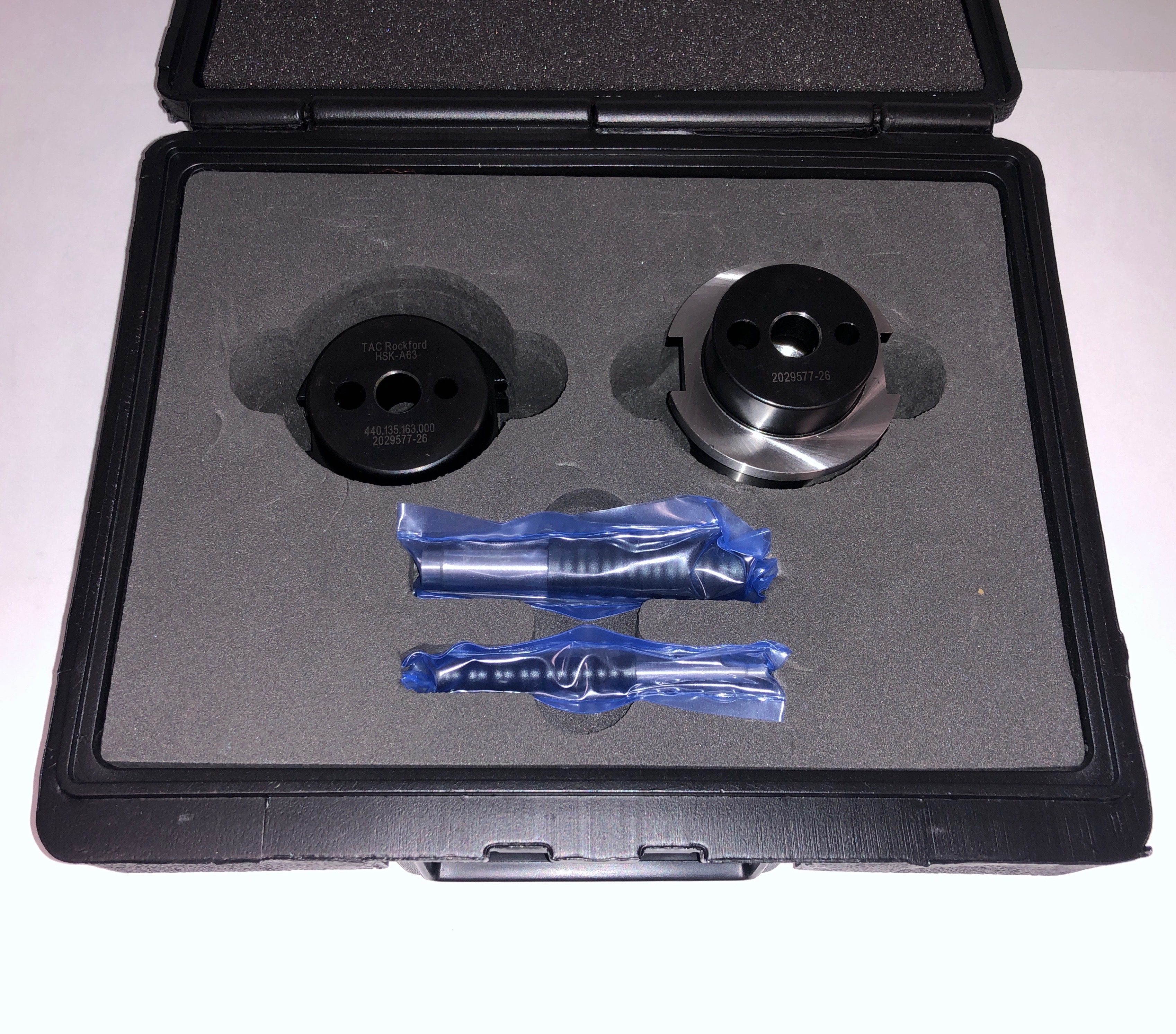

Special Tools Required
        All of the following tools need to be purchased in order to properly maintain and service our new HSK spindles.  These tools can be purchased off-the-shelf.  You can aquire these tools from anywhere you like, links are provided to give an example of the less common tools.  TAC Rockford and Advanced Machine Engineering Co. have good options for HSK tooling, and they also sell sturdy cases with different kit options to keep all of the tools together and protected. All tools need to be purchased in 63A and F versions or with adapters for each.  Keep tools calibrated and clean.
  • T-0118 HSK-A63 O-RING MANDREL TOOL W/ PACKING (Purchase only available through Haas Automation)
  • Clamp force (pull force) measurement tool to check drawbar and clamping unit clamp force
  • HSK-63A/F test bar (arbor/mandrel) to check taper accuracy
  • HSK-63A/F ER 32 collet for the ball bar test
  • HSK-63A/F balanced tool holder (plug) for running vibration tests
  • HSK-63A/F tool changer alignment tool (split tool) to align the spindle to the double arm
  • 5mm metric hex socket bit to torque the locking screw when adjusting pushout -  you want this to be long enough to put through a tool holder - see the HSK-A63 replacement procedure for details
  • M5 T-handle hex wrench for the locking screw
  • 24mm wrench for grabbing the flats on the clamping cone
  • HSK spindle taper wiper for cleaning the spindle taper
  • HSK spindle tool taper wiper for cleaning tool holders
  • METAFLUX paste 70-8508 only Warning: NEVER MIX GREASE TYPES
  • Dedicated re-greasing brush or METAFLUX spray can.  Keep clean and allow absolutely no contamination.
  • Hooked pick for removing o-rings
  • Pliers for removing the lip seal and spacer unit

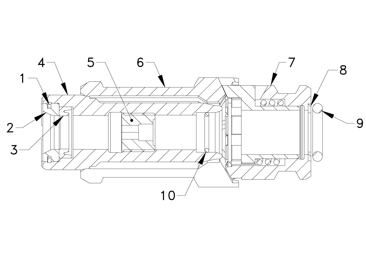

HSK-A63 Service Parts
ITEM HAAS P/N
1 Requires Replacement of the Complete Clampling Unit (59-1695)
2 Requires Replacement of the Complete Clampling Unit (59-1695)
3 93-3137 (LIP SEAL COOLANT TUBE HSK-A63)
4 Requires Replacement of the Complete Clampling Unit (59-1695)
5 93-3139 (LOCKING SCREW HSK-A63)
6 93-3141 (GRIPPER FINGER SET HSK-A63)
7 93-3142 (SPACER GRIPPER FINGER HSK-A63)
8 93-3143 (RING BACK UP HSK-A63)
9 93-3144 (O-RING LARGE DRAWBAR HSK-A63)
10 93-3148 (O-RING SMALL DRAWBAR HSK-A63)
