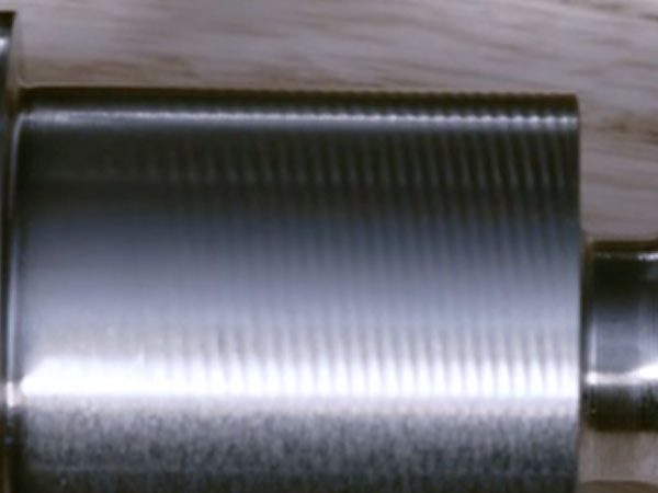

Part chatter. Tailstock Advance button or handle jog, used to put pressure on the part.
Use M21 or the foot pedal to maintain pressure on the part.
Spindle Speed Variation not in use.
Use SSV to control part chatter.

Do not use the TS hand jog keys to enage the tailstock when you cut the part. Pressure applied by the TS hand jog keys is not always consistent, and can result in chatter marks on the part.
Always use M21 or the foot pedal to maintain pressure on the part.

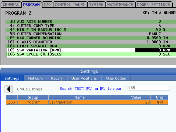

Spindle Speed Variation (SSV) allows you to specify a range within which the spindle speed will continuously change.
This changes the frequency of the machining process, which helps to suppress chatter.
M38 turns SSV mode ON and M39 turns it OFF.
Setting 165 specifies the amount that the spindle speed changes above and below the programmed speed.
Setting 166 specifies the SSV duty cycle in 0.1-second increments. The duty cycle affects the rate of spindle speed change.

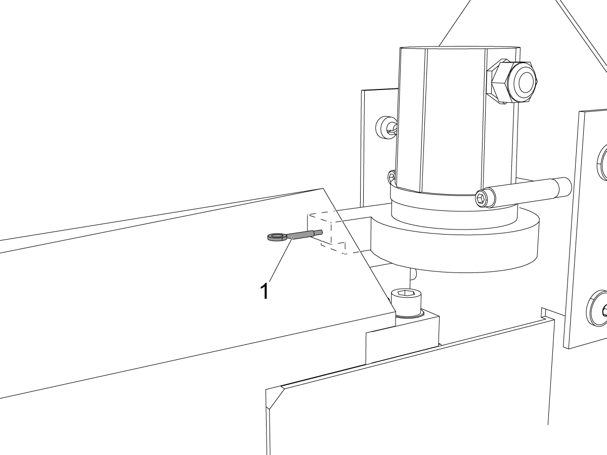

When handling the encoder, never let go of the string allowing it to retract under its own tension, damage may occur. Carefully pull the string out and let it retract slowly.
Make sure the string [1] can move freely in and out of the encoder housing.  Make sure the encoder string is not pinched or touching the way cover at anytime during its travel. The B-Axis position on the screen should change as you pull on the encoder string. If there is no change in the position display check the encoder connection in the cable trey behind the Z-Axis.
Inspect the encoder string for contamination or damage (cuts or fraying).
Inspect the encoder housing for signs of damage or contamination.

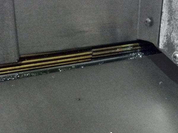

Way Cover
Corrective Action:
Clean the lower way cover rails.
Make sure the way covers move smoothly on the rails, and do not bind on each other.
