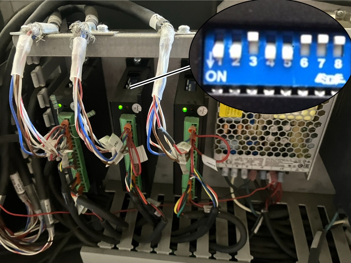

Reduced Axis Travel
Corrective Action: Dip Switches 1-4 on the stepper motor driver establish the step/revolution and must be changed to their correct configuration.
Switches 1-4 MUST be set as:
SW1 ON (down)
SW2 ON (down)
SW3 OFF (up)
SW4 ON (down)

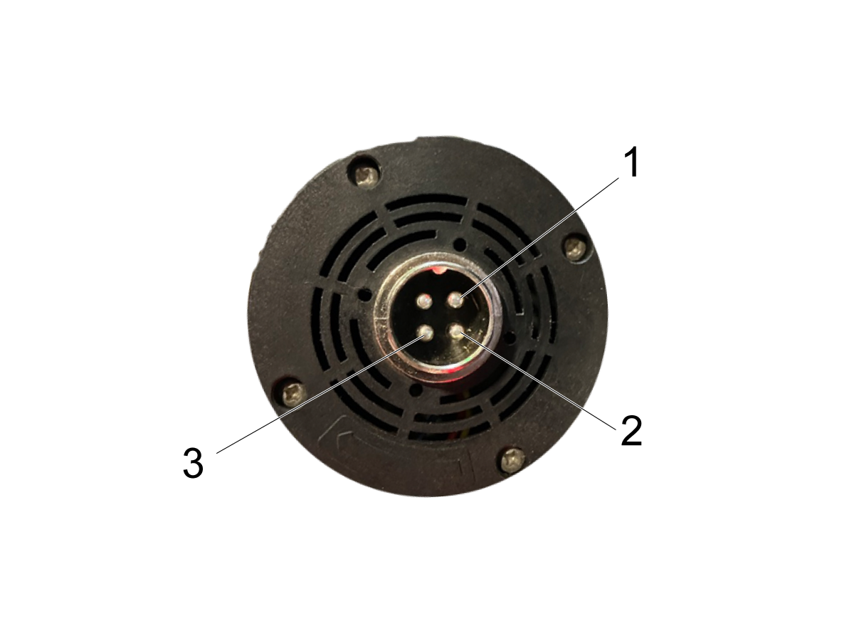

Desktop Mill Spindle Resistance Test
Corrective Action: Use a multimeter to measure the resistance between the pins on the Desktop Mill Spindle.
Remove the Desktop Mill Spindle Power Cable.
Take the following resistance measurements on the spindle:
1 to 2.
1 to 3.
2 to 3.
Note: Resistance between each pin should be approximately the same value.
Note: If the resistance measurements between the pins are noticeably unequal, it indicates that the spindle must be replaced.
Important: In the case of a spindle replacement, machine software must be updated to version 100.24.000.1120 or higher. Please refer to the symptom table above for additional details regarding this update.

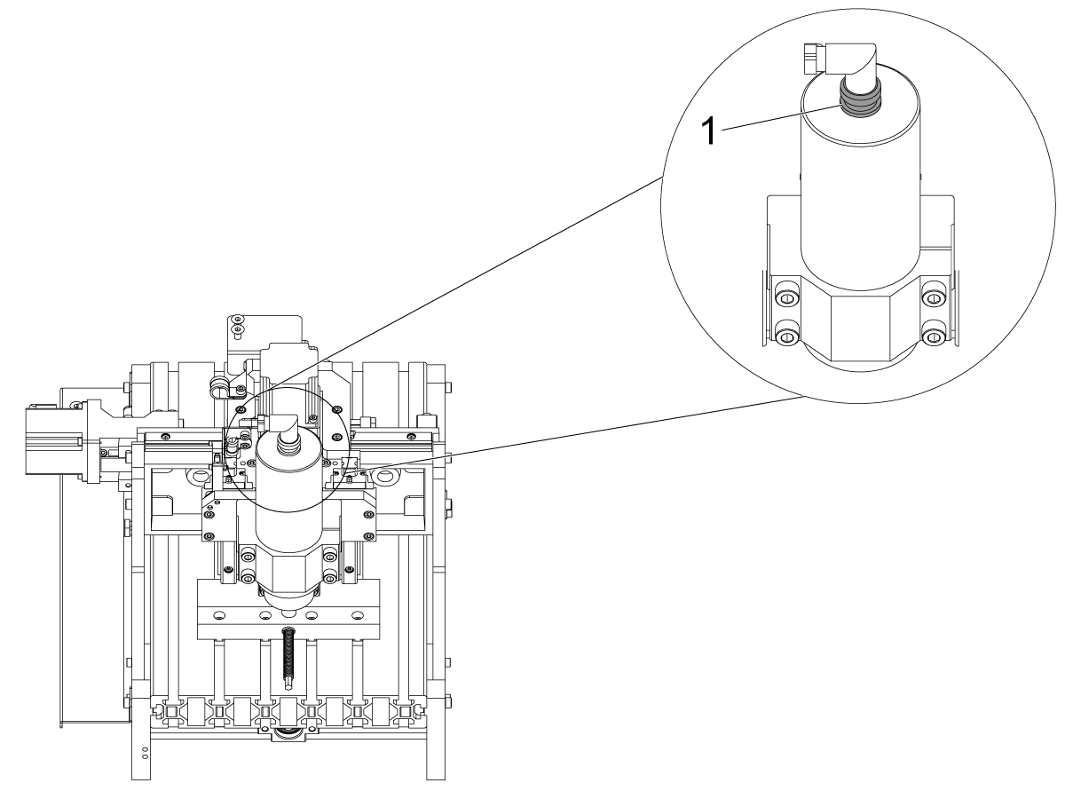

Loosen the thumb screw that secures the spindle power cable to the spindle [1].

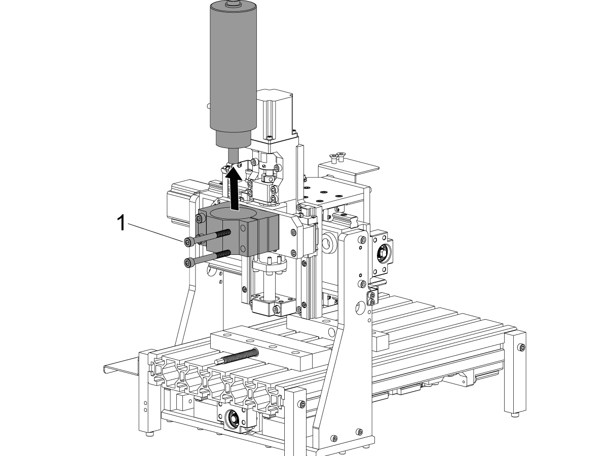

Loosen the following socket head cap screws [1] that secure the spindle to the spindle clamp.
Remove the desktop mill spindle from the spindle clamp and place it aside.
Spindle Installation

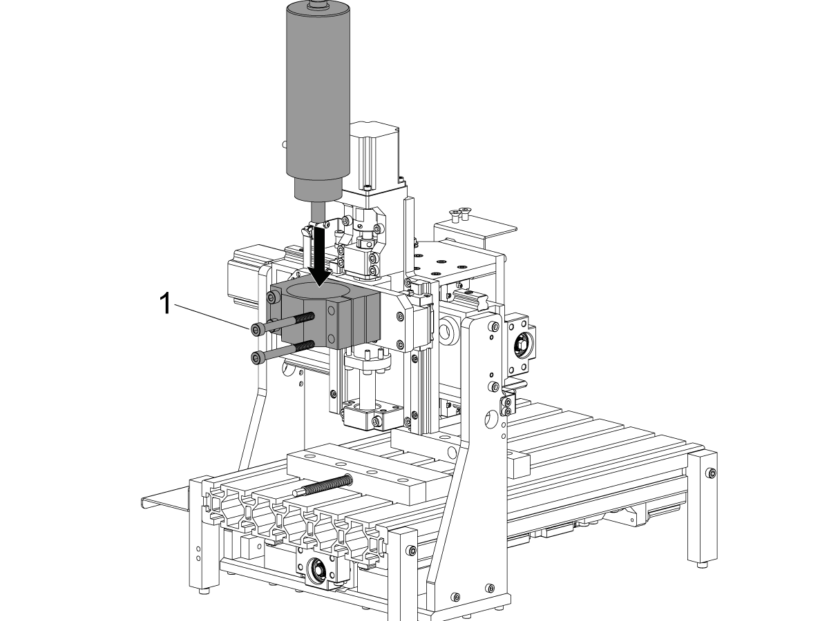

Insert the new spindle back into the spindle clamp.
Re-tighten the two socket head cap screws [1] that secure the spindle, then reconnect the power cable.
Note: Torque the following two screws to 20ft-lbs.
Note: Refer to the Desktop Mill Troubleshooting Guide for further information upon installation.
