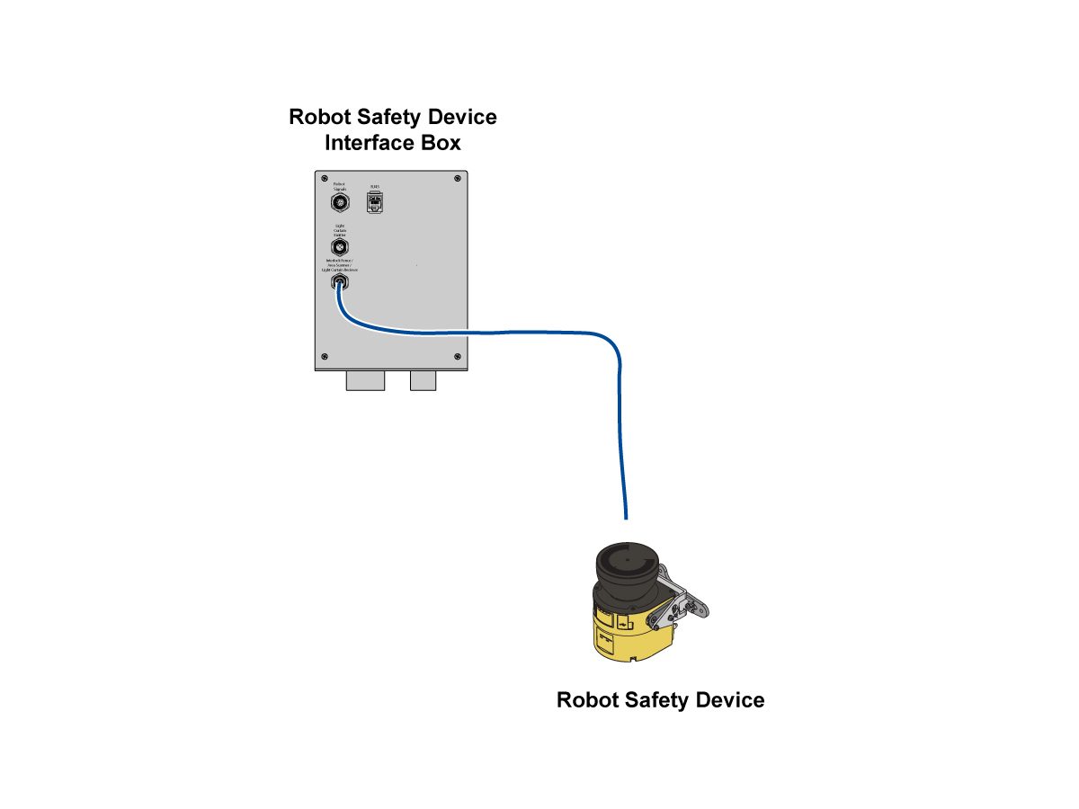

The Area Scanner Kit (08-1897) Includes the following Components:
  • 09-0625 Area Scanner Cable
  • 09-0626 Area Scanner Floor Mount
  • 09-0627 Laser Area Scanner

Plug the area scanner into the power source--either the machine's interface box if an integrated area scanner OR the wall's outlet if a stand alone area scanner.
