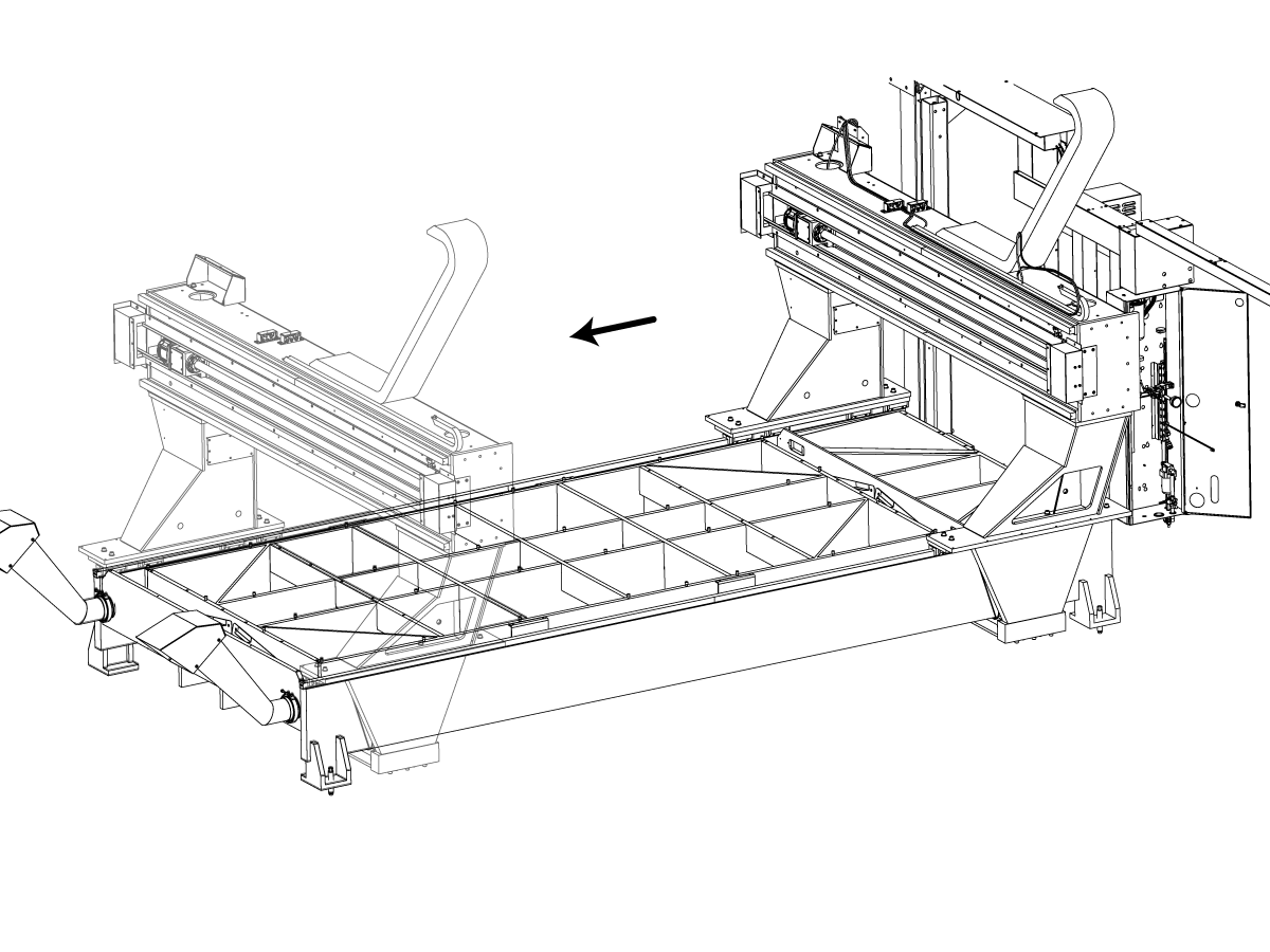

GM Dual Ballscrew
 IMPORTANT: For GM dual ballscrew machines, only the Axis Load Test is available, the Resonance Scan Test is not currently available in any level of access.
