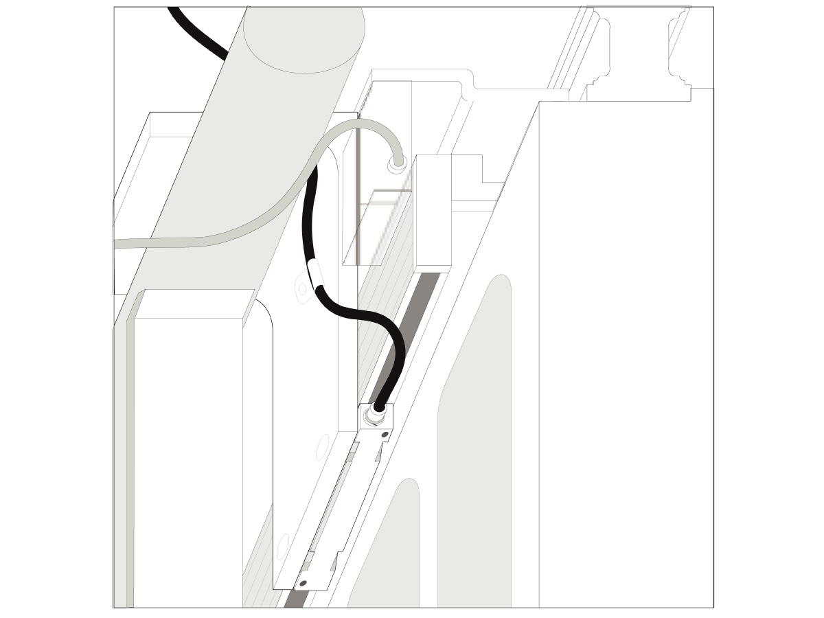

Disconnect the linear scale cable from the extension cable and remove the cable clips and ties that secure the linear scale cable.

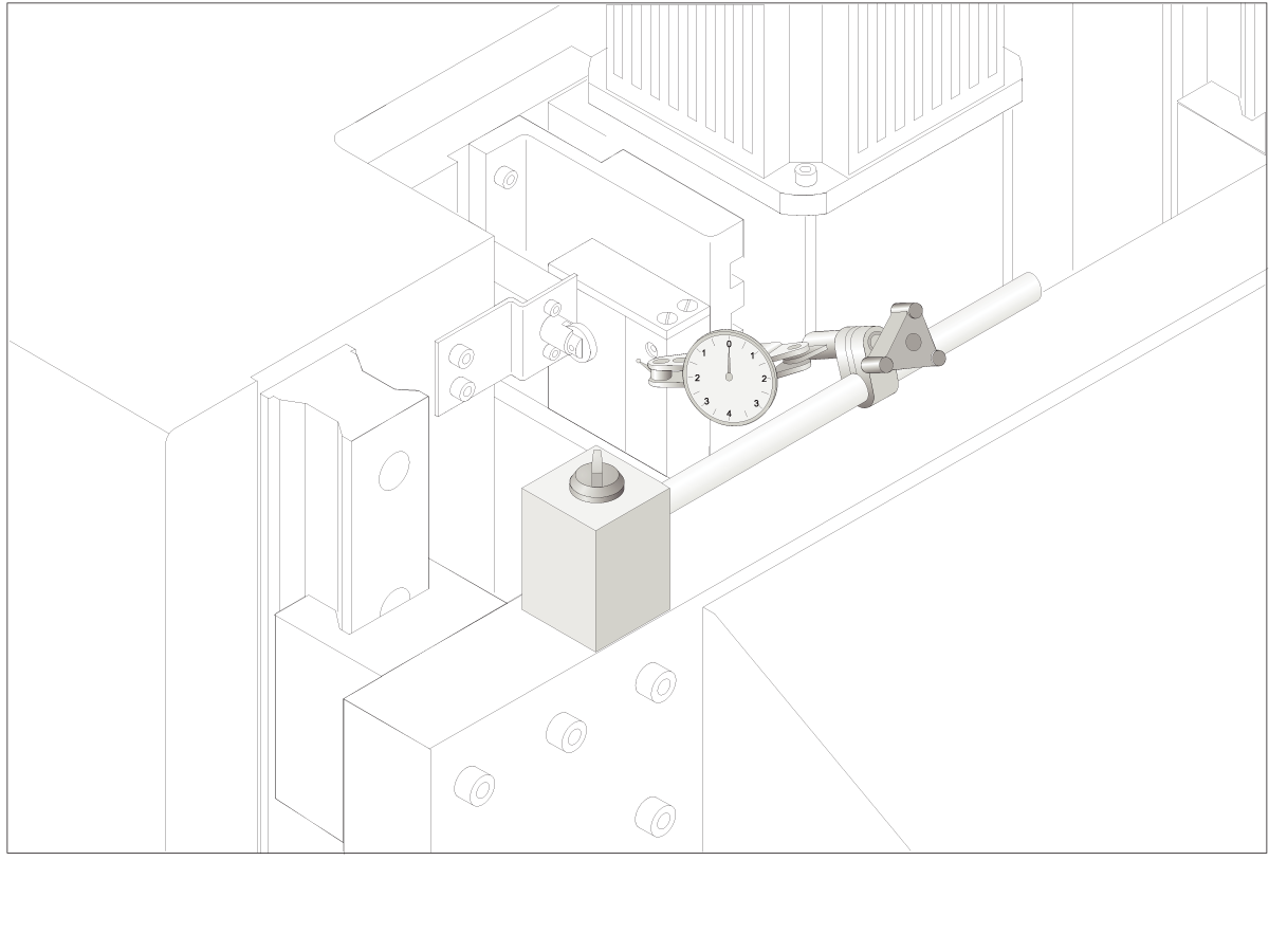

Using a dial indicator check the parallel runout of the scale mounting bracket. To indicate the full length of the scale mount; jog spindle head to the top of its travel and place the magnetic base on the bottom of the spindle head.
Zero the indicator, mark the position of the indicator stylus on the scale mount and obtain reading, full travel down.
Remove magnetic base and place it on top of the spindle head.
Zero the indicator at the mark on the scale mount and obtain reading, full travel to the top. (T.I.R. .004). Align if necessary.
Verify bolts are tight. If alignment cannot be made within tolerance, shim stock may be used near mounting bolt locations when mounting the scale.

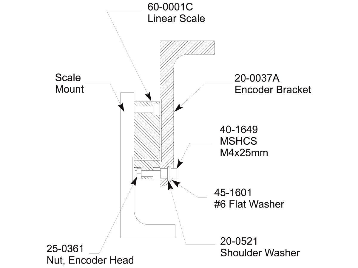

Check the scale and verify that it is a new 'C' version with plastic isolating material on the encoder head mounting surface. See installation diagram below for the part number.
The pigtail cable should also have a version 'C' label on it. Do not remove the labels.

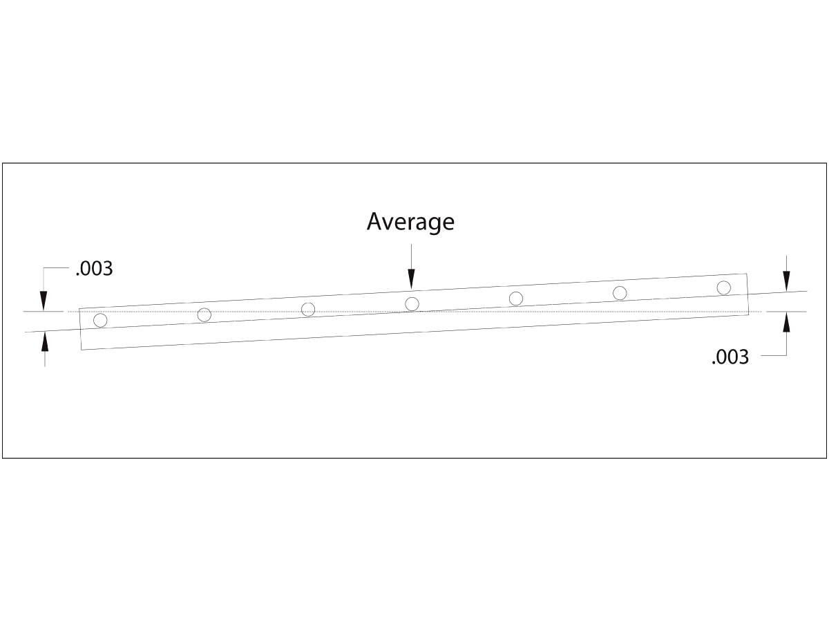

Check and adjust scale parallelism. Use shim stock as required to obtain parallelism TIR .004.
Obtain an initial flatness measurement using a dial indicator.
To adjust, tighten the bolt nearest the area where the reading is the average of the total deviation.
Tighten the remaining bolts in an outward pattern while adjusting flatness (T.I.R. .004).
Check parallelism of the scale, and adjust if necessary (T.I.R. .004).

Use a new style electrically isolating encoder bracket for mounting the encoder head. See installation diagram for the part number.
7
Check all mounting surfaces for burrs that may influence the angle of the bracket. Install encoder bracket to the saddle leaving the bolts loose enough to adjust the bracket (use a flat washer with Blue Loctite or a split-lock washer).

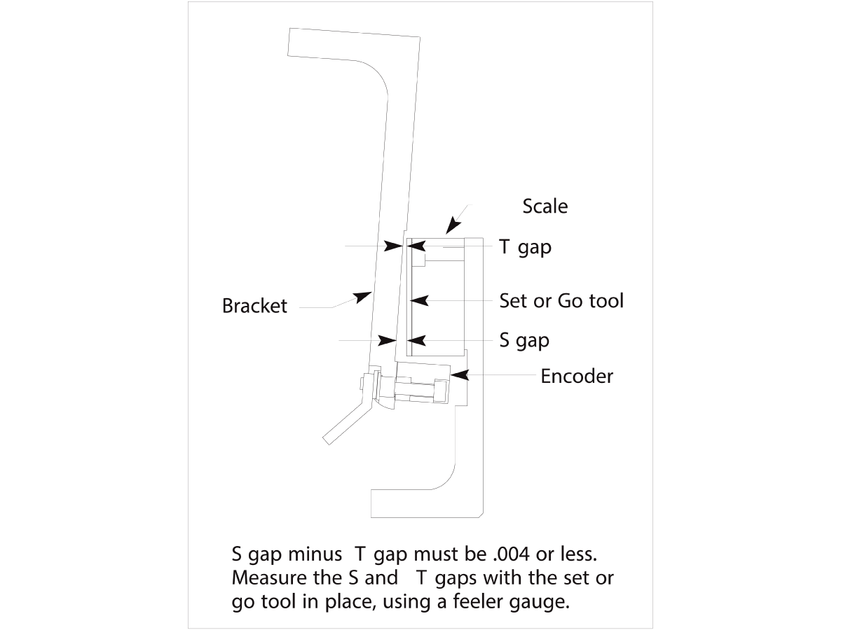

Using the horizontal gap tool "set tool" (T-2064), align the encoder bracket to the scale (see figure) by pinching the tool between the encoder bracket and linear scale and slowly tightening the encoder bracket mounting screws by alternating between screws to prevent shifting the bracket.
Be sure alignment is not made where there are labels on the scale. Leave the "set tool" in place and check that the bracket surface and the scale surface are parallel. If they are not, use a feeler gauge to measure how out of parallel they are. If they are more than .004" out of parallel shim the encoder bracket.
Remove the "set tool" and verify allowable gapping error by inserting the "go tool" (T-2063) from both sides of the bracket. Insertion of this tool means the gap is not too small.
Attempt to insert "no go tool" (T-2065) from both sides of the bracket.
If the tool does not fit then the gap is not too large.
This completes alignment of the encoder bracket.
 Note: For VF 3-5 machines the gap tool cannot be inserted from the far side.
The new isolating encoder bracket uses metric screws with flat washers, plastic shoulder washers, and nuts or nut plate as shown in the installation diagram.

Do not connect linear scale cable to extension cable at this time. Verify isolation or electrical discontinuity between encoder head and its bracket using an ohmmeter.

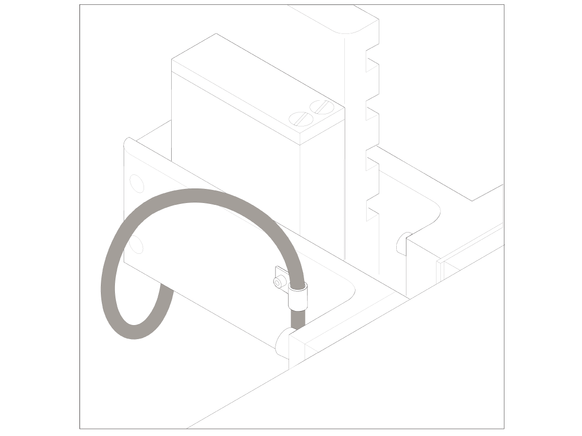

Connect linear scale cable to extension cable, check cable routing, and secure the cable.
Check that the cable will not interfere with other parts when the spindle head is moved. Be sure that the cable does not bend too tightly (see illustration).
