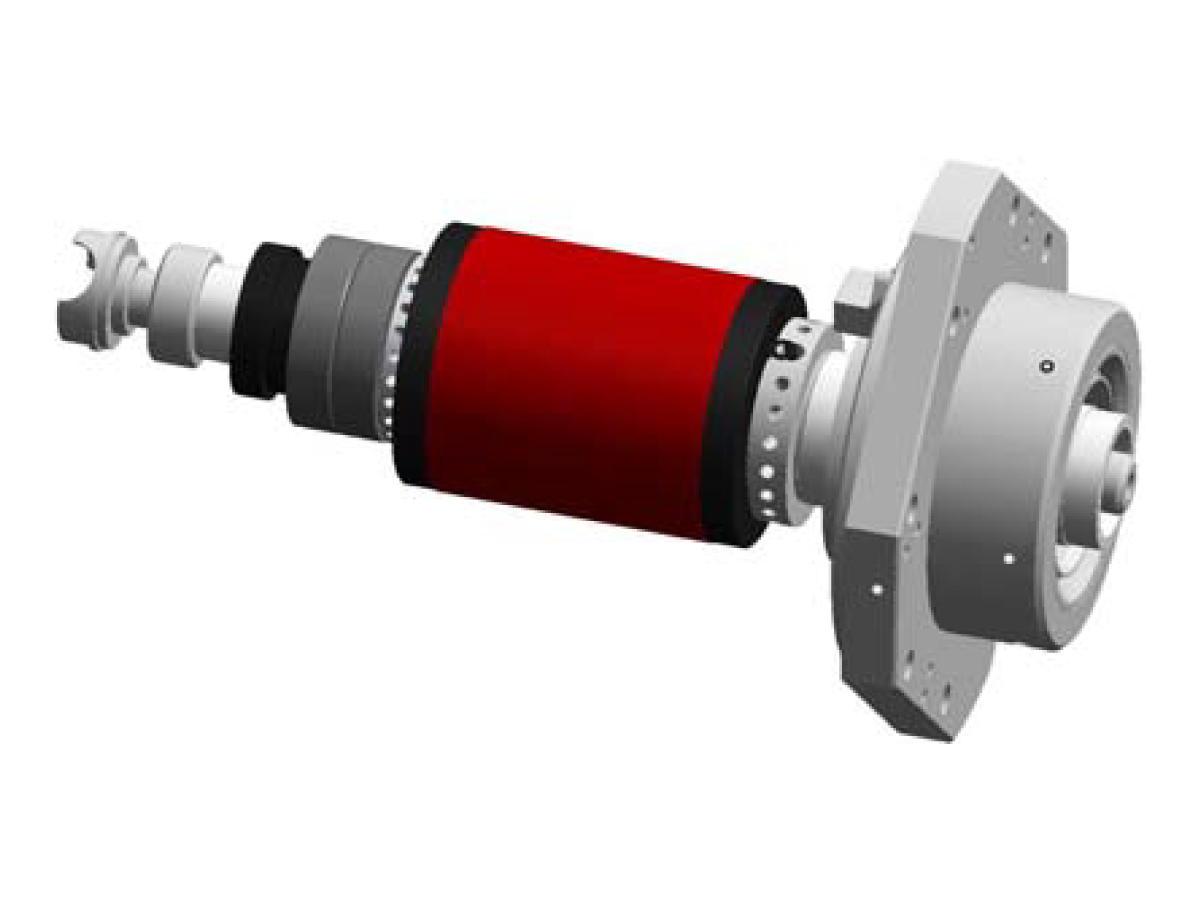

This procedure will be used when performing the H-5AX Spindle Encoder replacement.
This procedure tells you how to replace the spindle shaft kit.
This document applies to these parts:
  • 93-3227   SPINDLE SHAFT KIT HSK F63
  • 93-3306   SPINDLE SHAFT KIT HSK A63

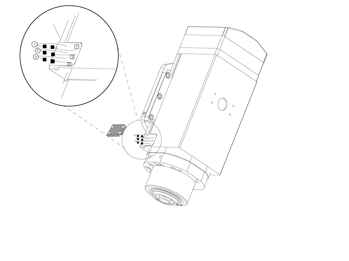

Remove the four 2mm screw holding the Encoder Inspection Cover in place.
Remove encoder cover and carefully pull the encoder cable from the spindle body
Unplug encoder connecter labeled (1), (2) and (3). Inspect cables for damage.

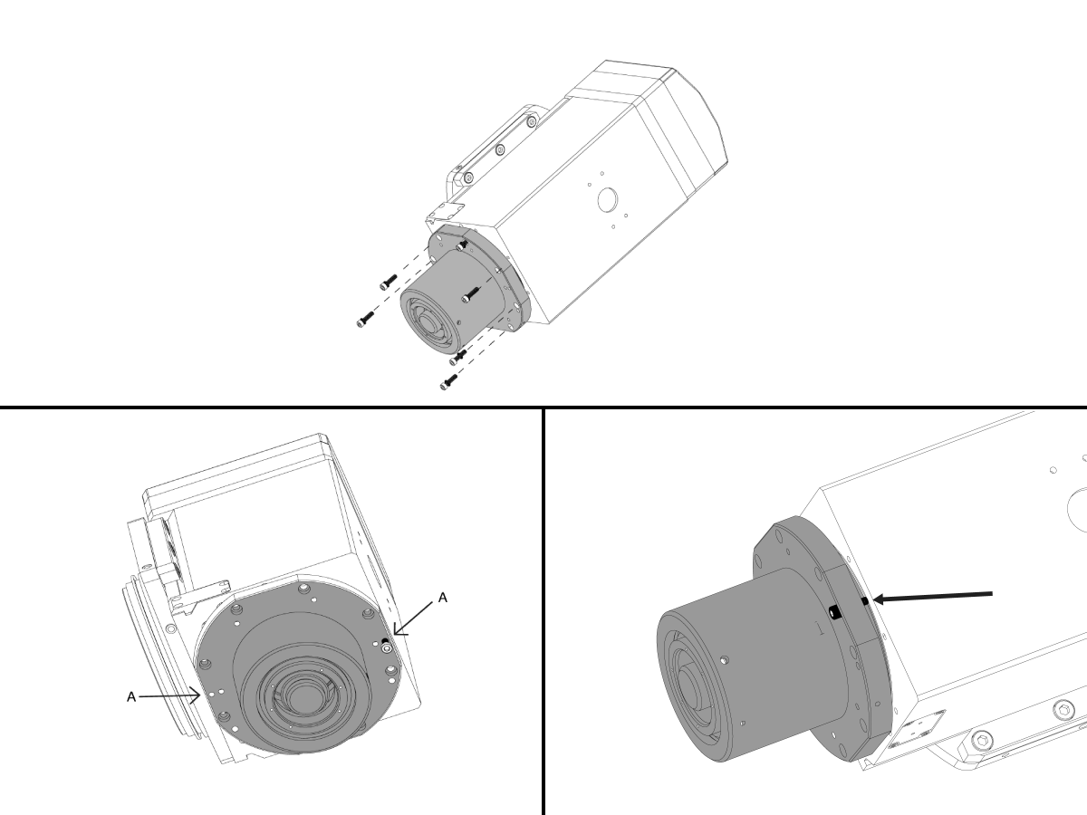

Remove the six 4mm screws holding the Coolant Ring in place. Found two 5mmX60mm or long to place into the outer hole. The coolant ring has a tight O-ring fit around the nose of spindle, using the screw as handles to turn and pull the ring until freed. Verify O-ring on the back of the ring are in place and not damaged.
 Remove the eight 5x20 screws that hold the spinlde shaft kit in place. Take out the spindle shaft kit by using two screws (M5x20 or longer), insert the screws in the holes indicated by (A) the outer holes. There is one on each side spindle nose. Turn the screw until the spindle shaft kit is free.
Carefully pull the shaft kit out by a few inches, using the encoder inspection window, make sure the encoder wiring do not get tangled. Make sure the four O- rings on the face of the spindle housing are fitted and in good condition.
Carefully remove the spindle shaft kit from the spindle body.

 Perp the new spindle shaft kit for installation, clean all mating surface.

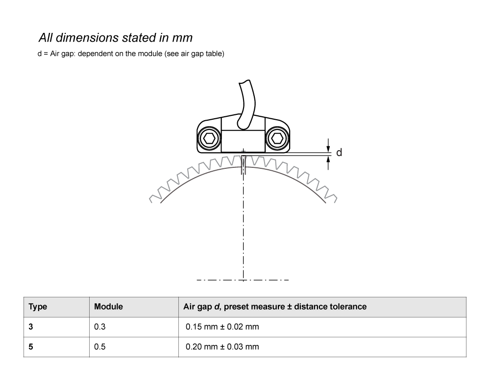

Remove the Lenord-Bauer encoder from the damaged shaft and install onto the replacement shaft kit.
  • Loosen the 2 fixing screws.
  • Take out the reader from the damaged spindle shaft.
  • Position the reader onto the replacement spindle shaft kit, keeping it away from the toothed wheel.
  • Tighten the 2 screws, leaving a little bit of play.
NOTE: Position the plastic shim BEFORE carrying out the other operations. Otherwise, the magnetic component of the reader may be drawn to the toothed wheel and may strike it, damaging the reader.
  • Push the reader towards the toothed wheel, as far as it will go.
  • Fully tighten the two optic reader fixing screws.
  • Remove the Shim.
  • Visually check that the toothed wheel doesn't touch the reader when the shaft is rotated.
Partly insert the new shaft kit. Make sure the encoder orientation is correctly aligned to the encoder inspection window.
Before fully insert the shaft in the spindle body, paying attention that the O-rings on the face of the spindle body are fully seated.
Fully insert the shaft kit in the spindle body, carefully pulling the encoder wires through the window. Position the wiring and the encoder connector so they don't interfere with the rotating parts.
insert and torque the screws. Refer to HAAS FASTENER TORQUE SPECIFICATIONS.

Connect the 3 connectors, carefully push the encoder cable into the window and reinstall the encoder inspection cover.
