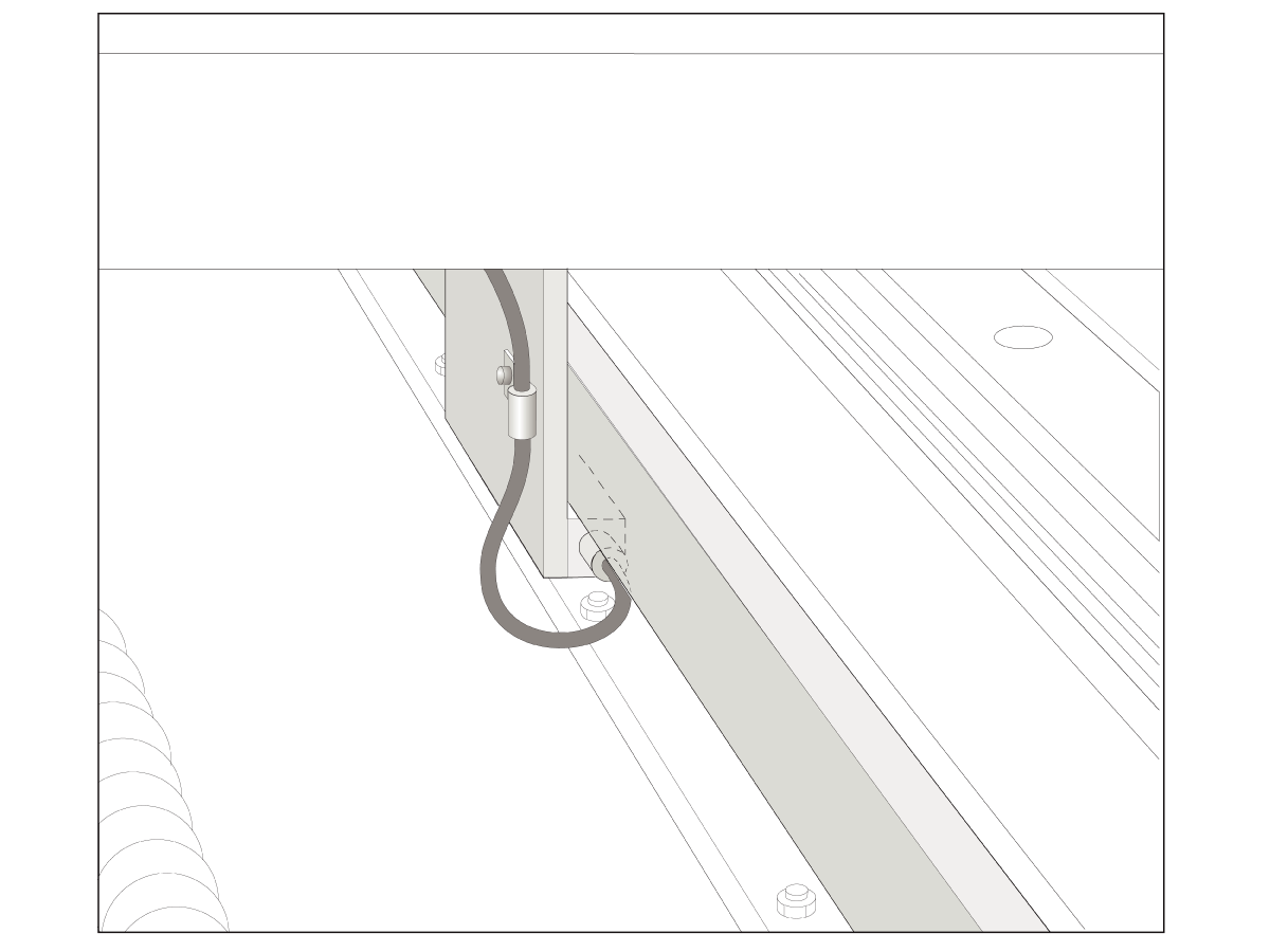

Clean mounting bracket, and remove any burrs that would affect scale installation.

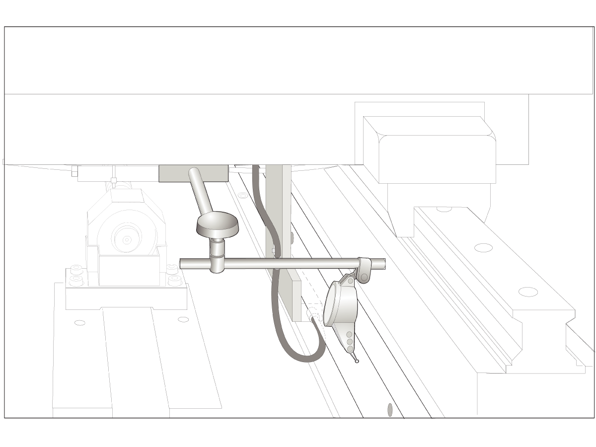

Using a dial indicator check the parallel runout of the scale mounting bracket.
To indicate the full length of the scale mount; jog the saddle all the way to the rear and place the magnetic base near the front of the saddle as shown.
Zero the indicator, mark the position of the indicator stylus on the scale mount and obtain reading, full travel to the front.
Remove magnetic base and place it near the rear of the saddle. Zero the indicator at the mark on the scale mount and obtain reading, full travel to the rear. (T.I.R. .004).
Align if necessary. Verify bolts are tight. If alignment cannot be made within tolerance, shim stock may be used near mounting bolt locations when mounting the scale.

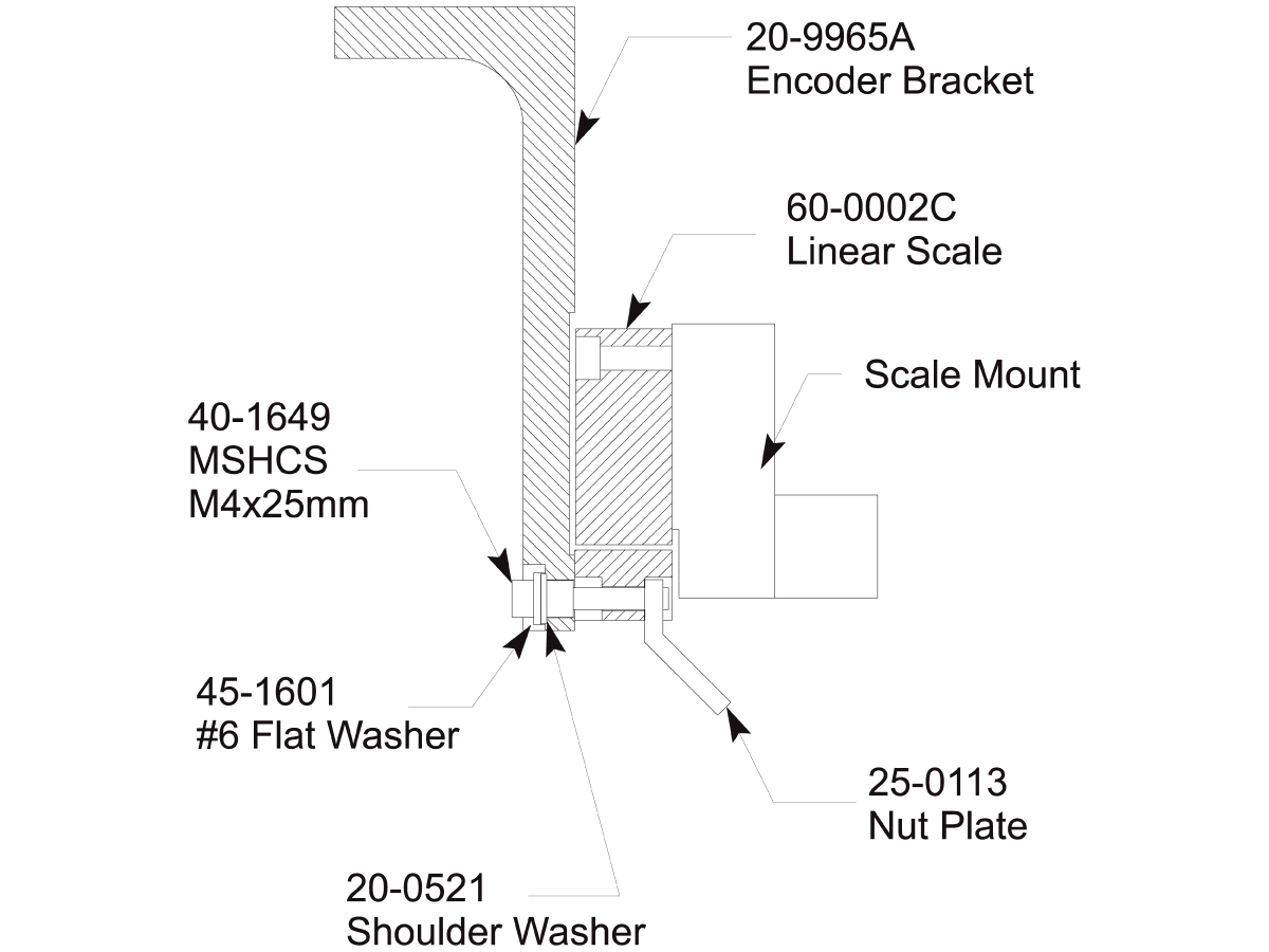

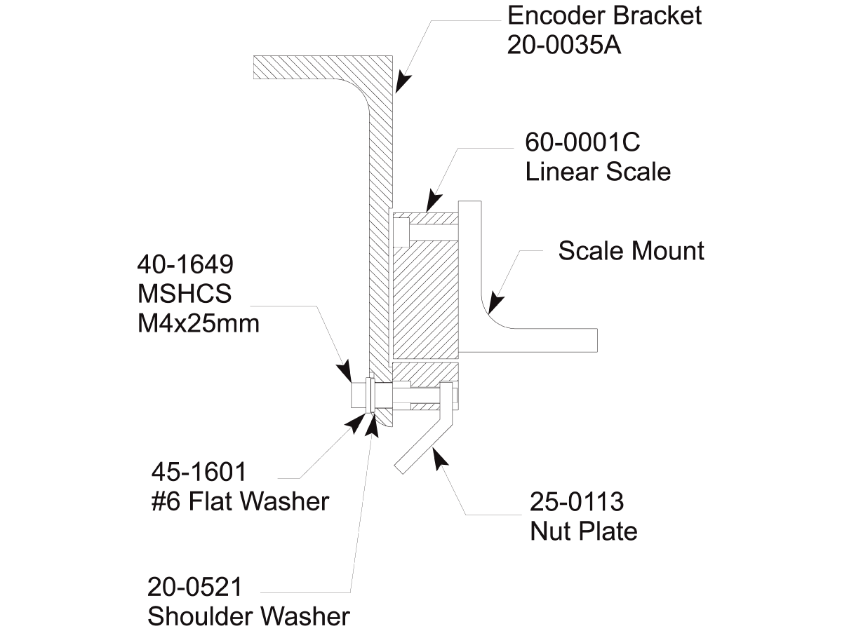

Check the scale and verify that it is a 'C' version with plastic isolating material on the encoder head mounting surface. See installation diagram below for the part number.
The pigtail cable should also have a version 'C' label on it. Do not remove the labels.

Install the linear scale using blue Loctite on the screws.
Check and adjust parallelism. Use shim stock as required to obtain parallelism TIR .004., as adjustment will need to be made. If the use of shim stock for parallelism is necessary obtain parallelism at this point. See figure for placement of indicator.

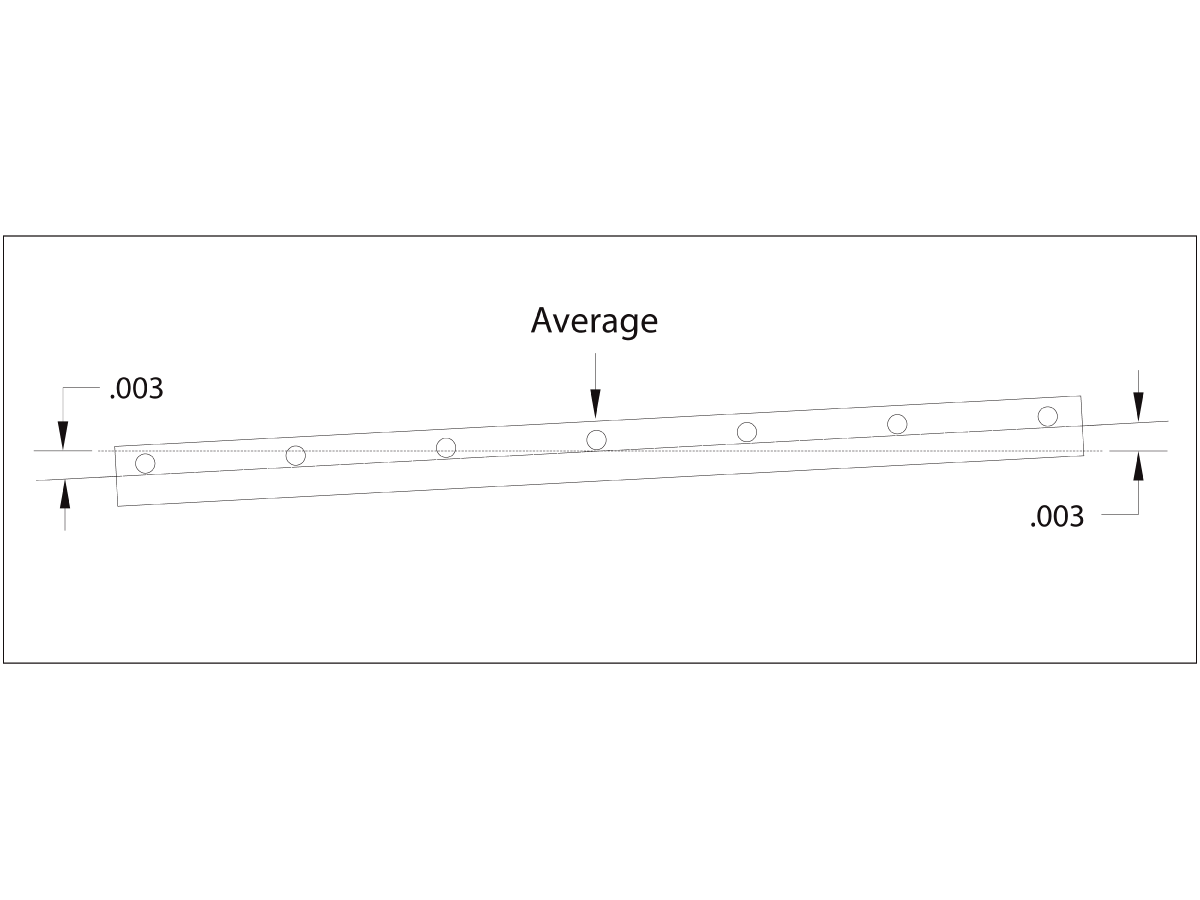

Obtain an initial flatness measurement using a dial indicator.
To adjust, tighten the bolt nearest the area where the reading is the average of the total deviation.
Tighten the remaining bolts in an outward pattern while adjusting flatness (T.I.R. .004).
Check parallelism of the scale, and adjust if necessary (T.I.R. .004).

Use a new style electrically isolating encoder bracket for mounting the encoder head. See installation diagram for the part number.
The VF 6, 7, 10 machines install the encoder bracket on the saddle using the rear most hole pattern.
The VF 8, 9, 11 machines install the encoder bracket on the saddle using the front most hole pattern.

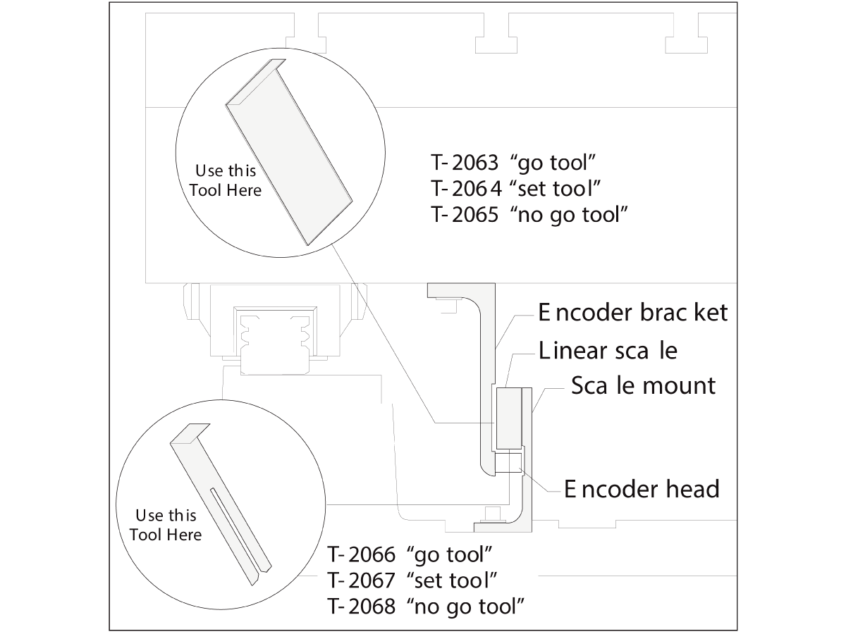

Linear Scale - Y-Axis - Alignment

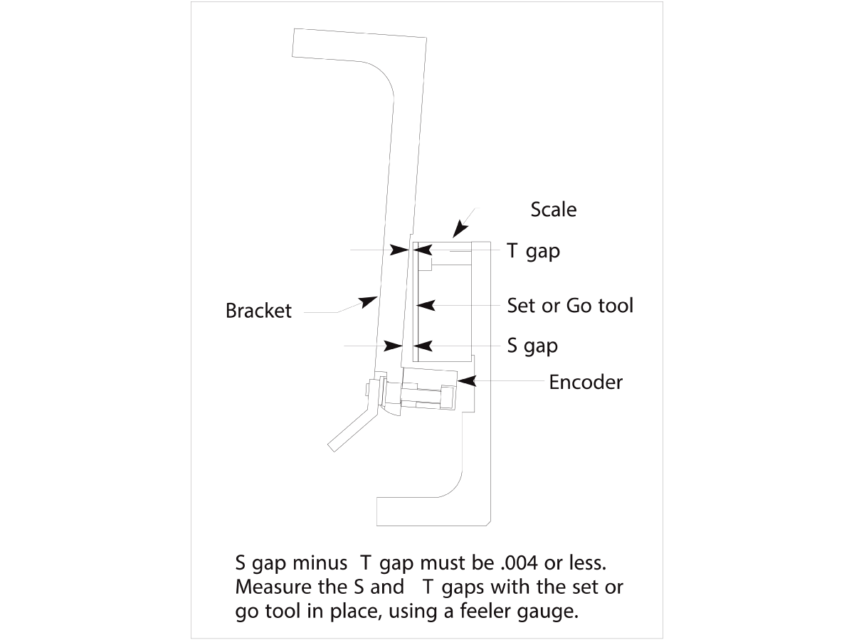

Using the horizontal gap tool "set tool" (T-2064), align the encoder bracket to the scale (see illustration) by pinching the tool between the encoder bracket and linear scale and slowly tightening the encoder bracket mounting screws by alternating between screws to prevent shifting the bracket.
Be sure alignment is not made where there are labels on the scale.
Leave the "set tool" in place and check that the bracket surface and the scale surface are parallel. If they are not, use a feeler gauge to measure how out of parallel they are. If they are more than .004" out of parallel shim the encoder bracket.
Remove the "set tool" and verify allowable gapping error by inserting the "go tool" (T-2063) from both sides of the bracket.
Insertion of this tool means the gap is not too small.
Attempt to insert "no go tool" (T-2065) from both sides of the bracket. If the tool does not fit then the gap is not too large.
This completes alignment of the encoder bracket.
The new isolating encoder bracket uses metric screws with flat washers, plastic shoulder washers, and nut plate as shown in the installation diagram.
Align encoder head to scale by pinching vertical gap tool "set tool" (T-2067) between the encoder head and scale and tightening the screws (use Blue Loctite).
Be sure any isolating material overhanging the encoder head is not pinched between encoder head and gap tool.
Remove "set tool" and verify allowable gapping error by inserting "go tool" (T-2066) from both sides of the encoder head. Insertion of this tool means the gap is not too small.
Attempt to insert "no go tool" (T-2068) from both sides of the encoder head. If the tool does not fit then the gap is not too large.
This completes alignment of the encoder head.
