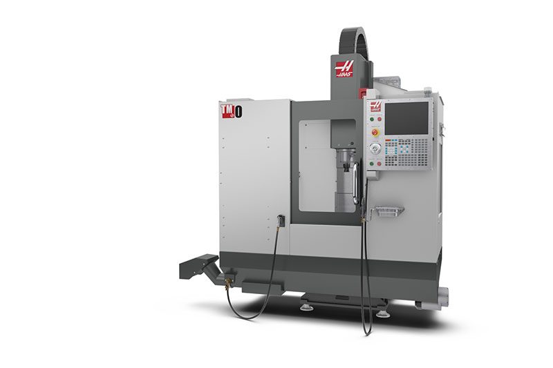

CNC Toolroom Mill with 20" x 12" x 16" travels
The TM-0 is the smallest and most affordable of the Haas TM Series Toolroom Mills. Haas Toolroom Mills are affordable, easy to use, and offer the precision control of the Haas CNC system. They use standard 40-taper tooling, and are very easy to learn and operate – even without knowing G-code. They are the perfect option for schools and companies transitioning to CNC, or for anyone looking for a large-travel machine on a budget.
  • Operates on single- or three-phase power
  • Conversational programming system
  • Affordable full CNC capabilities
  • HaasConnect remote monitoring
NOTE: Single-phase operation is not available in Europe.
