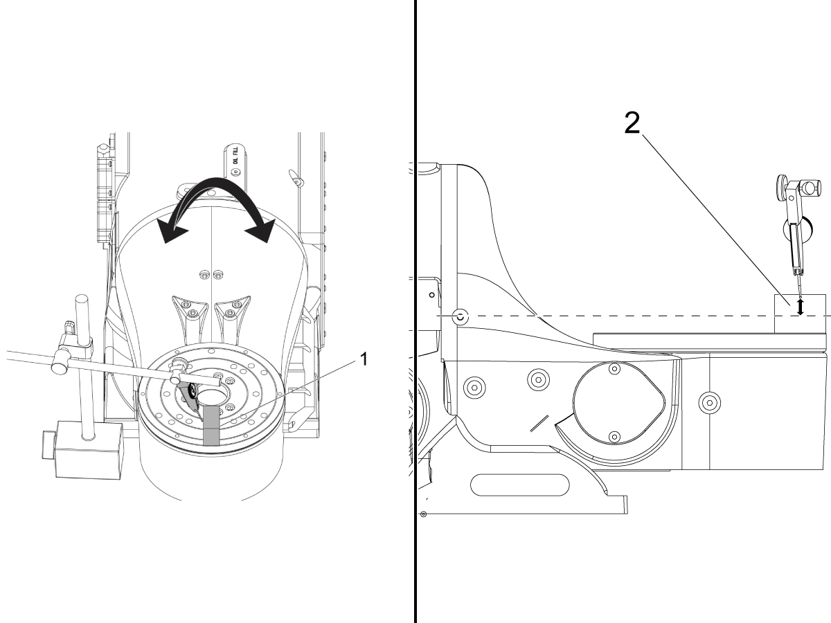

Backlash Test for TRT
A Axis
Place a magnetic block on the front of the TRT platter as shown in the following image.
Place the dial gauge tip on side of the block's machined surface. [1]
Note: Measure how far the tip of the indicator is to the  A -Axis of rotation [2].
Zero the indicator, then move the A axis towards the indicator (.001). This will allow enough rotation to engage the gears in one full direction.
Important: Write down the initial measurement found of the dial indicator as this value will be used later.
Select the smallest increment (.0001) and move away from the indicator 10 times.
Note: Backlash value will be the difference from the starting measurement subtracted by the final position found on the dial indicator.
B Axis
Note: Measure how far the tip of the indicator is to the  B -Axis of rotation [2].
Zero the indicator, then move the B - Axis towards the indicator (.001). This will allow enough rotation to engage the gears in one full direction.
Calculating Arc Seconds
The backlash tolerance on rotaries is given in arc seconds. The equation to calculate arc seconds is a=(1,296,000*b)/(2*pi*r). Where; a=arcseconds, b=backlash, r=radius of measured arc and pi=3.14.
The total backlash tolerance is plus or minus 30 arc-seconds.
   Base to A axis [2] Rim to B Axis [1]
TRT100 .88 from platter 2.0 in (50 mm)
TRT160 1.66 3.2 in (80 mm)
TRT210 1.4 4.6 in (115 mm)
TRT310 1.93 in 6.1 in (155 mm)
