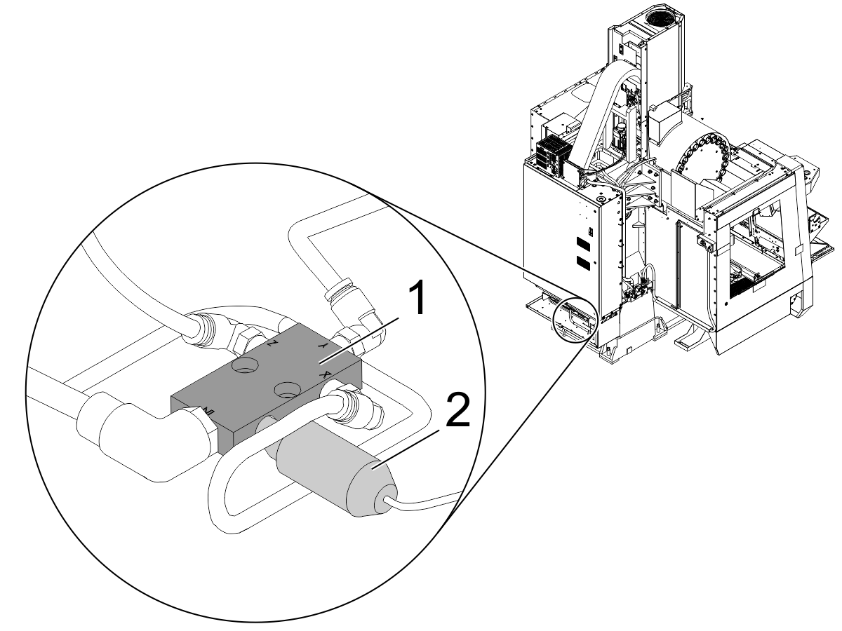

  1. Main Distribution Manifold - Sends grease to the axis manifolds.
  2. Grease Pressure Switch - Monitors the grease system pressure and sends a signal to the control to generate an alarm if the pressure drops below the minimum level too quickly.

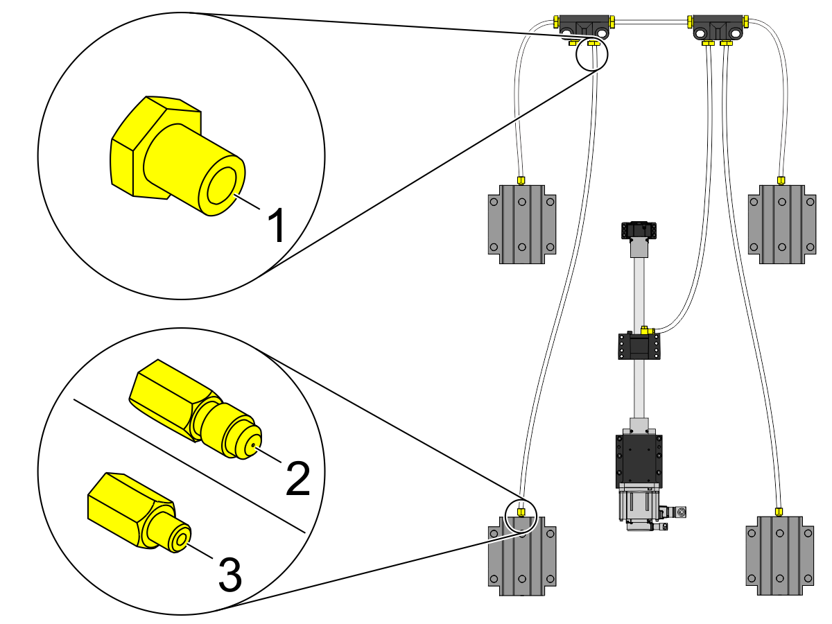

Note: Each axis has (4-6 ) linear guide trucks [4] and (1) ballnut [5].
Grease moves from the axis manifolds through flexible plastic tubing. The flexible plastic tubing sends grease to the linear guide trucks [4] and the ballnut [5].
Note: There is (1) nylon tube that goes to each linear guide truck [4] and (1) nylon tube that goes to the ballnut [5].
Axis Manifold Fitting Information
The high-pressure grease system uses non-restrictor fittings [1] in the axis manifolds. The linear guide trucks use restrictor fittings [2] and adapter fittings [3].
Note: Adapter fittings are smaller than restrictor fittings and do not restrict the flow of grease.
Note: The linear guide trucks on some machines use restrictor fittings [2] and do not have adapter fittings [3] in the linear guide trucks.
Note: The amount of grease supplied to each linear guide truck will not be the same.
Note: The flexible plastic tubing on this system are equal length.
Caution: Do not change the length of any flexible plastic tubing. This changes the flow of grease.
