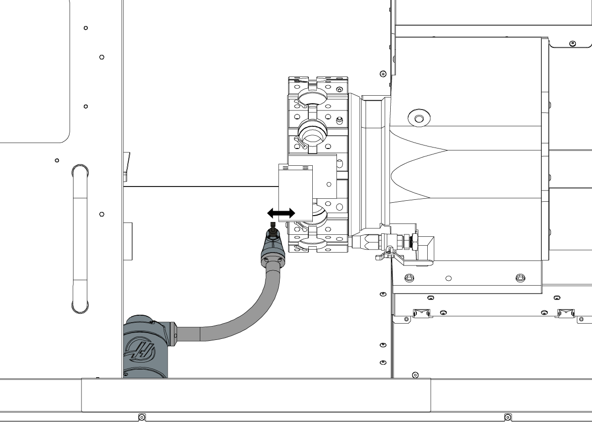

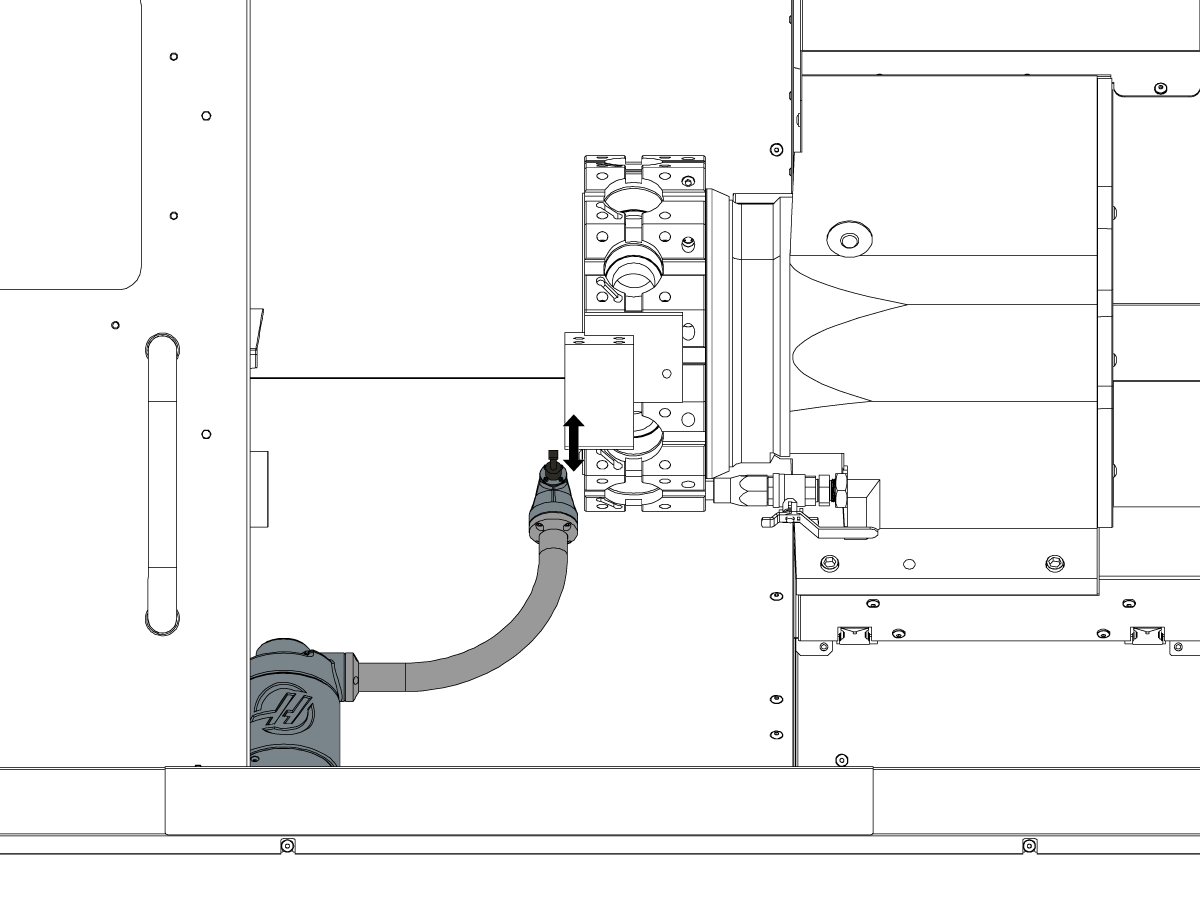

Machine Requirements:
  • Non-compact ATP [1]
  • Compact ATP [2]

Probe Arm fails repeatability ATP spur gear was not clocked correctly with regards to the rotary actuator. Refer to the ATP Repeatability Test section below.

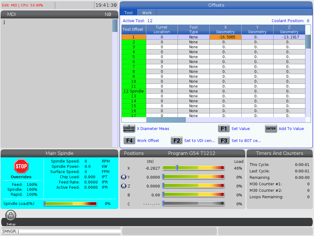

Repeatability Test
Check X-axis Repeatability
Press [FEED HOLD] while the probe is in the down position using M104.
Jog the turret with the turning stick in the active pocket 1 near the probe.
Hand Jog in .001" increments in the X-axis direction until the probe beeps.
Go to the [OFFSET] screen and record the value for pocket 1 on your traveler sheet.
Back the turret away from the probe.
Put the probe in the up position with M105 or RESET.
Put the probe back down again with M104.
Touch the tool off on the probe again in the X-axis direction.
Record the offset for pocket 1.
NOTE: Do this a total of 5 times for the X-axis measurement.

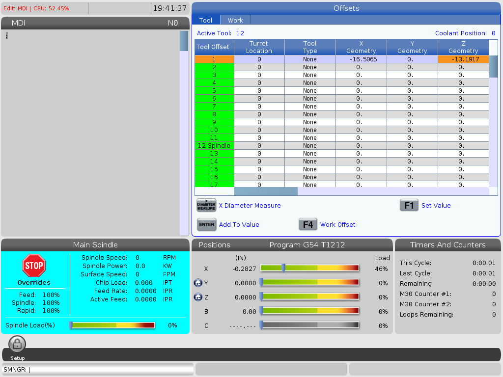

Check Z-axis Repeatability
Perform the repeatability test used on the X-axis for the Z-axis direction 5 times.
Readings cannot exceed 0.002" from each other.
