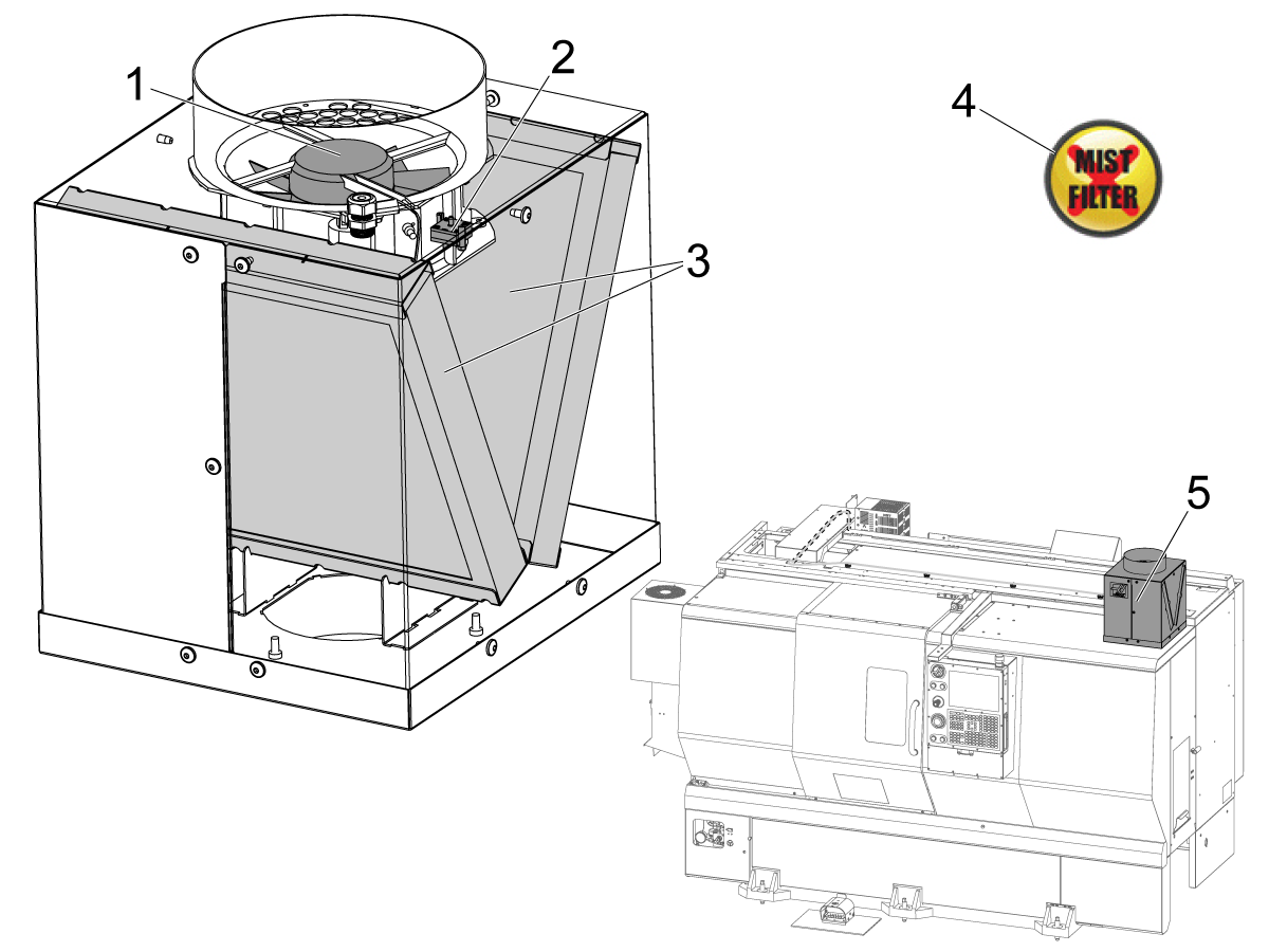

  1. Low-vibration fan
  2. Vacuum switch
  3. Reusable woven-metal filter panels
  4. Dirty filter icon
  5. Enclosure assembly

Corrective Action:
Slide the filters out of the Enclosure Exhaust. Clean the filters with soap and water. Put them back in the enclosure exhaust assembly.

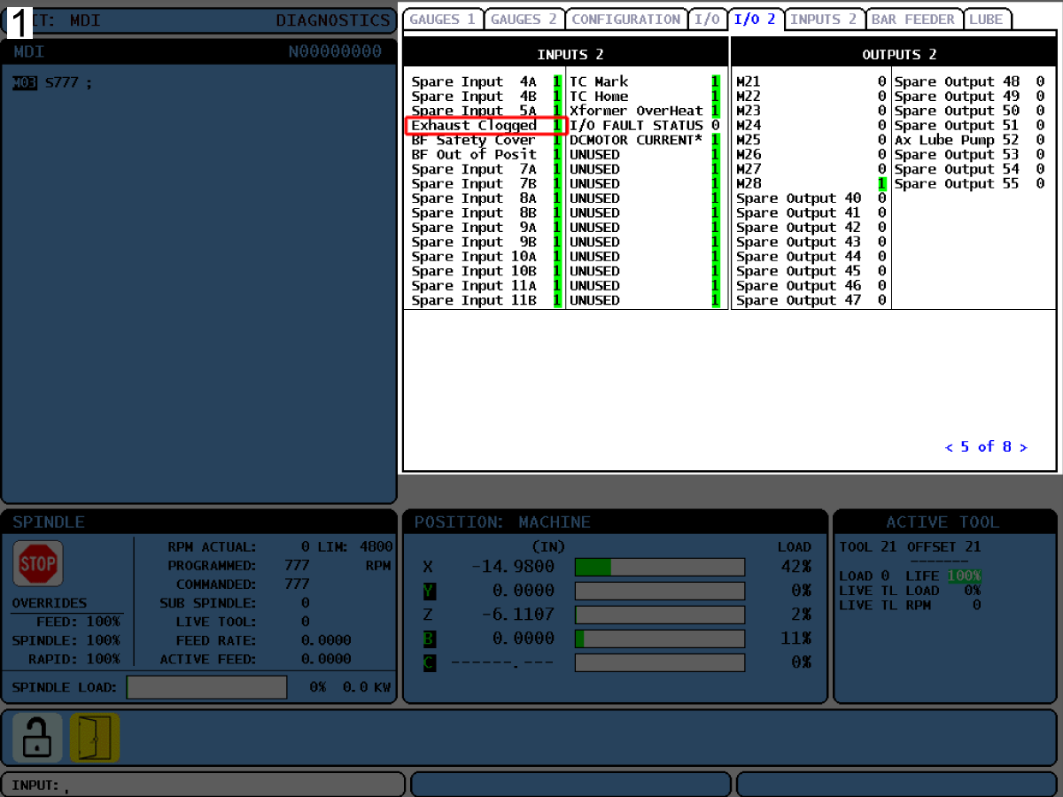

Disconnect the vacuum switch from the I/O PCB. Put a jumper on the vacuum switch connector pins on the I/O PCB. The connector is at P23 for CHC [1] and P34 for NGC [2].
Go to Enclosure Exhaust Clogged on the I/O tab of the Diagnostics screen. Verify the value changes state when you put the jumper on the pins. If the value changes state, replace the vacuum switch.
If the value does not change, check the cable for damage. If the cable is not damaged, go to I/O PCB - Troubleshooting Guide (Classic Haas Control).
