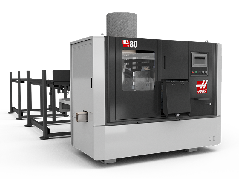

Elevate shop productivity and precision with the Haas HCS-80 Carbide Cold Saw, designed to meet the rigorous demands of automated metal cutting. Engineered for precision, our carbide cold saw delivers smooth, clean cuts on a variety of metals, from steel to aluminum. The HCS-80 offers variable cutting speeds, automatic material feed, and fast rapids for high productivity.
  • Cutting range, round – Ø0.39 in - Ø3.14 in (Ø10 - Ø80 mm)
  • Cutting range, square – 0.39 in - 2.36 in (10 mm - 60 mm)
  • Automatic chip auger
  • Dust collection device
  • Mist spray system
  • Vise pressure regulator
  • Automatic lubrication
See Available Stock
Current Lead Time
Compare Machines
EXPLORE ALL INVENTORY
Contact Distributor
INDUSTRIAL SAWS
    HAAS JOURNAL
      Compare Machines
      • Configuration
      • Specs
      • Machine Info
      • Product Warranty
      STANDARD CONFIGURATION
      EXTERIOR PROTECTION
      CE Standard Fully Enclosed Protection
      ELECTRICAL FEATURES
      CE Electrical Safety
      Door Open Automatic Power-Off
      Main Drive Permanent Magnet Motor
      Inverter
      PRODUCT FEATURES
      Automatic Chip Conveyor (spiral type)
      Motorized Chip Brush
      Dust Collection Device
      Mist Spray System
      Cabinet Air Conditioner
      LED Worklight
      MATERIAL FEEDING
      Servo Feed
      Simple Roller Table
      HYDRAULICS
      Automaic Chip Conveyor (spiral)
      Vise Pressure Regulator
      Top Clamp
      Hydraulic Cooling Fan
      Automatic Lubrication
      Cutting Range SAE Metric
      Cutting range round Ø0.39 in - Ø3.14 in Ø10 - Ø80 mm
      Cutting range square 0.39 in - 2.36 in 10 mm - 60 mm
      Shortest length of cut-off piece 0.2 in 5 mm
      Shortest remnant length in automatic operation 2.55 in+a 65 mm+a
      Shortest remnant length individual cut 1.18 in+a 30 mm+a
      Performance Characteristics SAE Metric
      Total connected load 24 hp 18 kW
      Power of saw motor 14.6 hp 11 kW
      Hydraulic motor 3 hp 2.2 kW
      Cutting speed, infinitely variable 30 - 160 rpm 30 - 160 rpm
      Saw feed speed 0.011 - 1.2 in/s 0.3 - 30 mm/s
      Rapid motion 5.9 in/s 150 mm/s
      Automatic material feed length, single stroke 31.5 in 800 mm
      Automatic material feed length, multiple stroke 393.66 in 9999 mm
      Saw Blade SAE Metric
      Saw blade diameter Ø12.4 in Ø315 mm
      Saw blade bore Ø1.25 in Ø32 mm
      Saw blade thickness 0.078 in - 0.009 in 2 mm - 2.3 mm
      Dimensions SAE Metric
      Length 90.55 in 2300 mm
      Width incl. chip conveyor 88.97 in 2260 mm
      Height 87 in 2210 mm
      Material support height 36.4 in 925 mm
      Shipping Dimensions and Weight SAE Metric
      Saw Crate (W x L x H) 86.6 in x 98.4 in x 86.6 in 2200 x 2500 x 2200 mm
      Infeed Table Crate  (W x L x H) 63 in x 82.7 in x 98.4 in 1600 x 2100 2500 mm
      Saw Crate Weight 4850 lb 2200 kg
      Infeed Table Weight 1150 lb 522 kg
