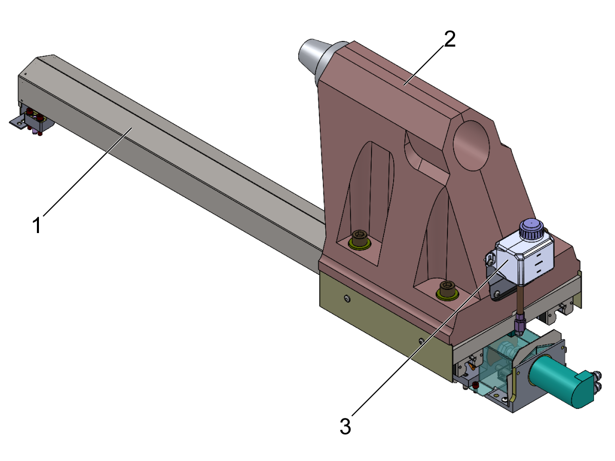

  1. ACME Screw cover
  2. Tailstock Body
  3. Tailstock Grease Reservoir
  1. ACME SCREW 1.25-5-47"-.625 R-ANC
  2. ACME SCREW NUT 1.25-5 X 2.5
  3. Ballscrew Bumper
  4. Tailstock motor cover
  5. Tailstock Hydraulic Motor
  6. ACME SCREW Bearing Housing Anchor
  1. Coupling Jaw Type
  2. Proximity Sensors
  3. Microswitch Trip Flag
  4. Microswitch (Home Sensor)
  5. Microswitch Mount
  6. Proximity Sensor Trip Flag
  7. Hydraulic Tailstock Motor

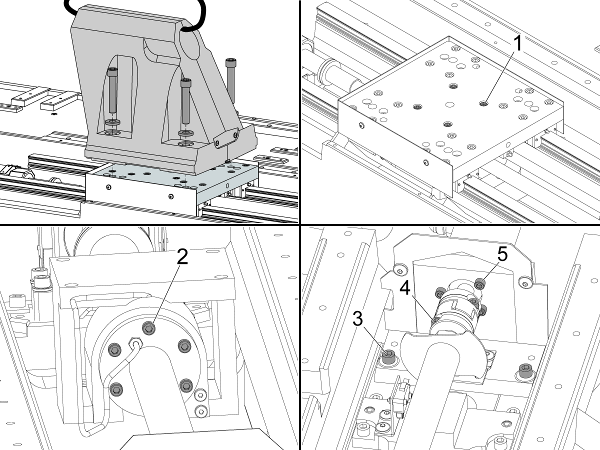

ACME Screw Alignment
Disconnect the Hydraulic Motor Hoses. Using a collar nut tool and a drill, drive the riser assembly to the motor side of the screw. Loosen all the bolts below and make them finger tight:
  • ACME Nut to ACME Nut Housing[1]
  • Motor Mount[2]
  • Motor Coupler Pinch Bolts[3]
  • Motor Bolts[4]
Torque the bolts in the following order:
Using a collar nut tool and a drive. Run the ACME screw back and forth +/- 2 inches.
  • Motor Mount[2]
  • Motor Coupler Pinch Bolts[3] (10 ft-lbs)
  • Motor Bolts[4]
Reconnect the Hydraulic Motor Hoses.

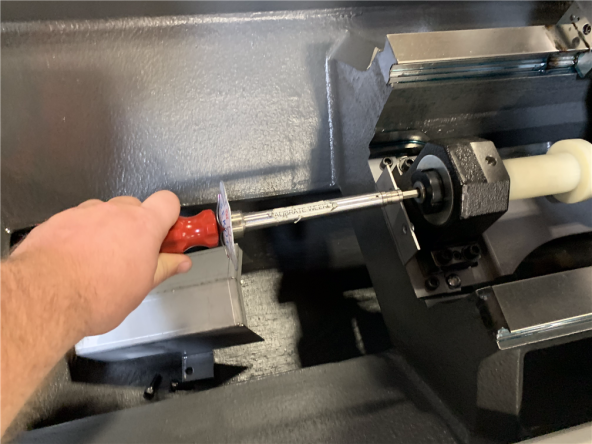

Use the hand torque meter to test the breakaway torque of the B-Axis at the start middle and end of travel. NTE 15 in-lbs.
If the torque exceeds 15 in-lbs. Continue the ACME Screw alignment.

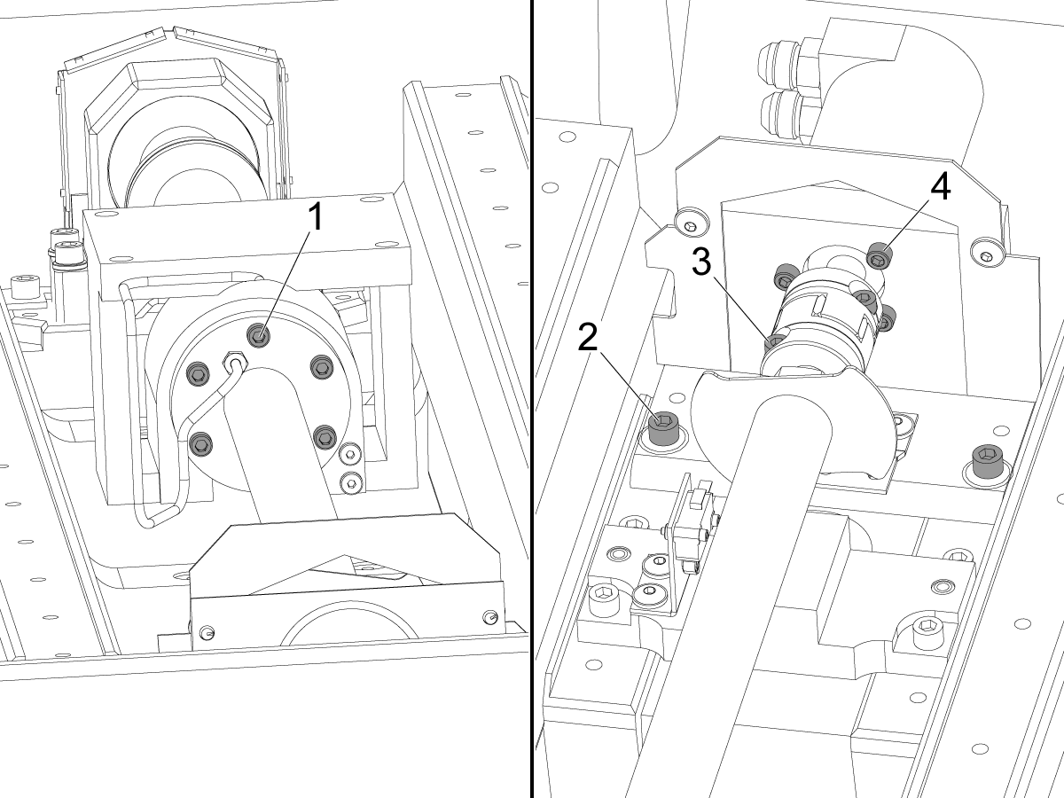

Remove the Grease Reservoir if installed. Remove the tailstock quill assembly to install a sling through the bore. Remove the tailstock casting to access the ACME Screw Housing hardware.
  • ACME Nut Housing to Tailstock Riser[1]
  • ACME Nut to ACME Nut Housing[2]
  • Motor Mount[3]
  • Motor Coupler Pinch Bolts[4]
  • Motor Bolts[5]
  • Motor Mount[3]
  • Motor Coupler Pinch Bolts[4] (10 ft-lbs)
  • Motor Bolts[5]
If the torque exceeds 15 in-lbs replace the ACME Screw Nut Housing.

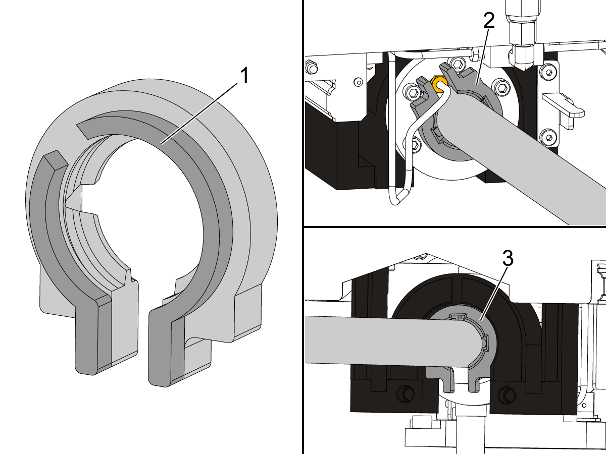

ACME Screw Wiper Installation
Install the each wiper so that the side with the shoulder[1] faces the ACME Nut.
Install the motor side wiper[2] against the ACME Nut with the ACME Nut grease fitting in the middle of the slot.
Install the support side wiper[3] against the ACME Nut with the slot facing down.

Checking Ball Screw Alignment
  • Observe Axis Servo load while Jogging axis is question through full travel.
  • A properly aligned Ball Screw will exhibit consistent servo loads throughout its travel.
If the servo load is not consistent, the following procedure should be used to align the Ball Screw:
  • Break loose then lightly snug the following Bolts:
  1. Nut Housing to axis in question Bolts (Saddle, Table, Spindle Head, Etc.)
  2. Ballscrew to Nut Housing Bolts
  3. Bearing support Bolts
  • Jog the Axis back and forth several times, then stop the axis at the bearing support and torque all bolts that were loosened
  • Jog the Axis through its entire travel observing for consistent servo load
Corrective Action:
Make sure there is a light coat of oil or grease on the surface of the ballscrew. If there is not, inspect the entire lubrication system for leaks and clogs, including all tubes, hoses, and fittings. Check for leaks on each axis: A leak at one axis will cause a lack of lubrication at a different axis. Check for oil or grease puddles to help locate the source of the leak.
 Note: The Haas Liquid Grease lubrication system uses adapter fittings [2] in the axis manifolds [1]. The linear guide trucks and ballnuts use restrictor fittings [3]. The restrictor fitting has a gap [5] between the threads and the set screw [4]. This forces the manifold-fed grease to pass through the gap [4] to lubricate the axes.
Make sure the correct lubrication is used. Refer to Lubricant, Grease, and Sealant Tables for Haas Machine Components.
Ballscrew/Ballnut or Support Bearing
Corrective Action:
Disconnect the lubrication fitting [1] from the ballnut [2]. Remove the screws [3] that attach the ballnut [2] to the ballnut housing [4].
Ballscrew/Ballnut
Separate the ballnut [2] from the ballnut housing [4]. Rotate the ballnut [2] by hand and hold the ballscrew [5] so it does not rotate, and the ballnut [2] will move away from the ballnut housing [4].
The ballnut [2] should rotate smoothly. If there is resistance or if it binds, the ballscrew [5] and ballnut [2] are faulty.
Support Bearing
Rotate the ballscrew [5] by hand. If there is resistance or if it binds, the bearings are faulty. Remove the ballscrew [5] and check the support bearings and bearing pack to determine which components need to be replaced.
Coupler
IMPORTANT: Machines are currently equipped with either a hydraulic counterbalance system or an electric brake motor. Care must be taken, in either case, to avoid damaging the machine or severely injuring yourself. Heed all warnings and cautions, and read all the steps of the procedure before starting any alignment.
If the machine is equipped with a hydraulic counterbalance, a shaft stop block must be used to secure the spindle head. Do not move the spindle during ballscrew service.
  • Machines with Counterbalances: Lower the spindle head to its lowest position. Install cylinder shaft stop. Handle jog axis up until the shaft stop blocks the axis.
  • Machines with Brake Motors: Brace the spindle head up with a 4” x 4” x 14” block of wood.
Corrective Action:
Refer to the Ballscrew Backlash Test procedure that is appropriate for your machine.
Power off and lock out the machine. Remove the necessary covers to access the axis with the problem. Remove the axis motor cover.
Install the coupler-installation tool [1] on the motor coupling. Turn the ballscrew so you can see the screw [4] for the motor-coupling clamp.
Remove the motor screws [2]. Loosen the screw [4] on the motor-coupling clamp. Remove the motor with the motor-coupling assembly. Remove the ballscrew key [3]. Inspect for damage or wear on the key or keyway.
 Note: If the axis motor is disconnected from the ballscrew, the grid offset and the work offset (such as G54) must be reset. Go to Axis Servo Motor - Set Grid Offset Parameter.
Make sure the flex pack [5] in the coupler is not damaged. It should be straight, and tightly compressed together.
COUPLER ALIGNMENT:
To realign the coupler to the motor shaft install the mounting bolts loosely and float the motor in until the coupling slides from between both the motor shaft and ballscrew shaft easily.
Torque the bolts down and verify the coupler still slides easily between the two shafts.
Torque the coupler pinch bolt to the specifications found on __________.
