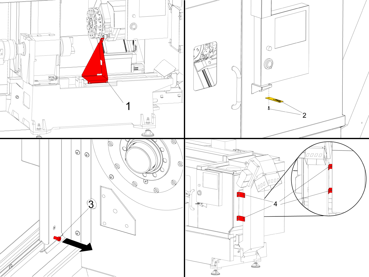

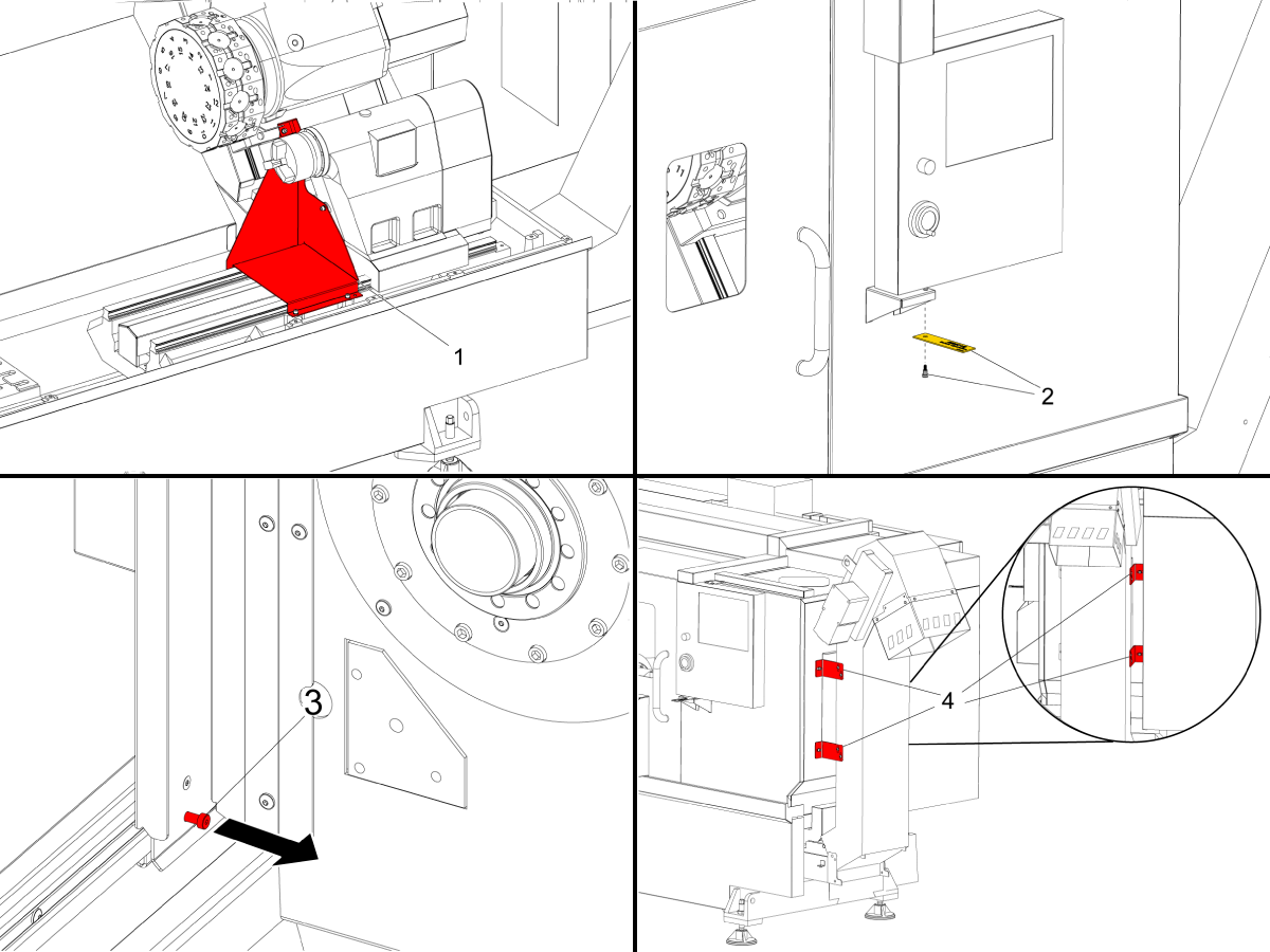

Shipping Brackets Removal
For ST-10/15 Lathes
Remove the turret to casting shipping bracket [1].
Remove the control panel shipping bracket [2].
Remove the control panel shipping shoulder bolt [3].
Remove the door shipping bracket [4].
Remove the chip conveyor shipping brackets [5].
For ST-20/25/30/35 Lathes
Remove the control panel shipping shoulder bolt [2].
Remove the door shipping bracket [3].
Remove the chip conveyor shipping brackets [4].
For ST-20Y/25Y and DS-30Y Lathes
