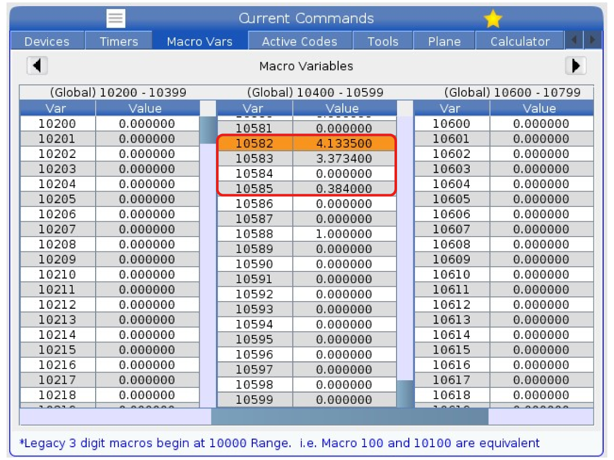

Press [CURRENT COMMANDS].  Navigate to the Macro Vars tab.
Change the below macro values to match the setting values.
  • #10582 = Setting 59
  • #10583 = Setting 60
  • #10584 = Setting 333
  • #10585 = Setting 334
Note: The automatic probing cycles uses these macro variables to verify calibration is complete. If the values do not match the probing cycle, the machine will generate an alarm.

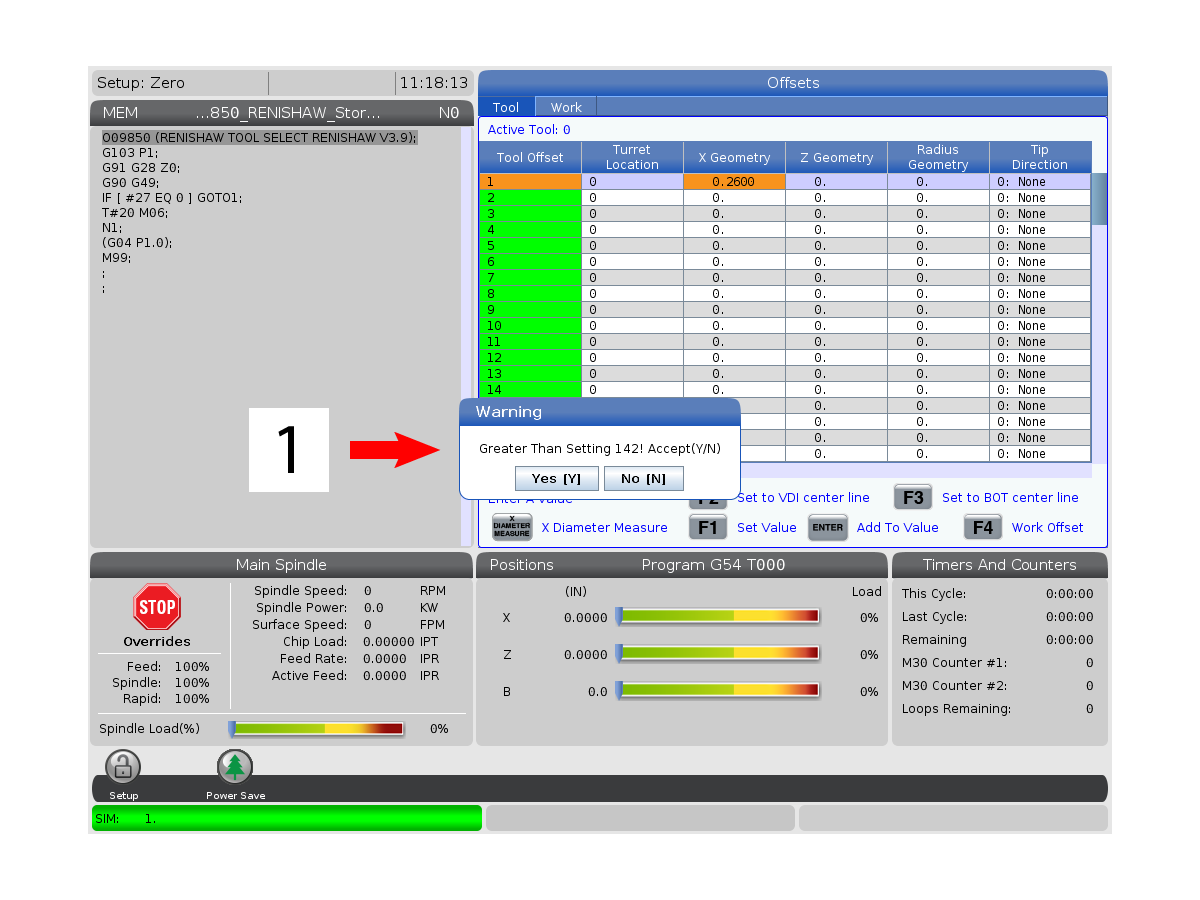

Push [OFFSET] one or two times to go to the TOOL GEOMETRY display.
Select the X GEOMETRY value.
Push [0]. Push [F2]. This removes the X GEOMETRY value.
If you get a warning message [1], Push [Y] to select YES.
Make sure the door is closed then push [.001].
