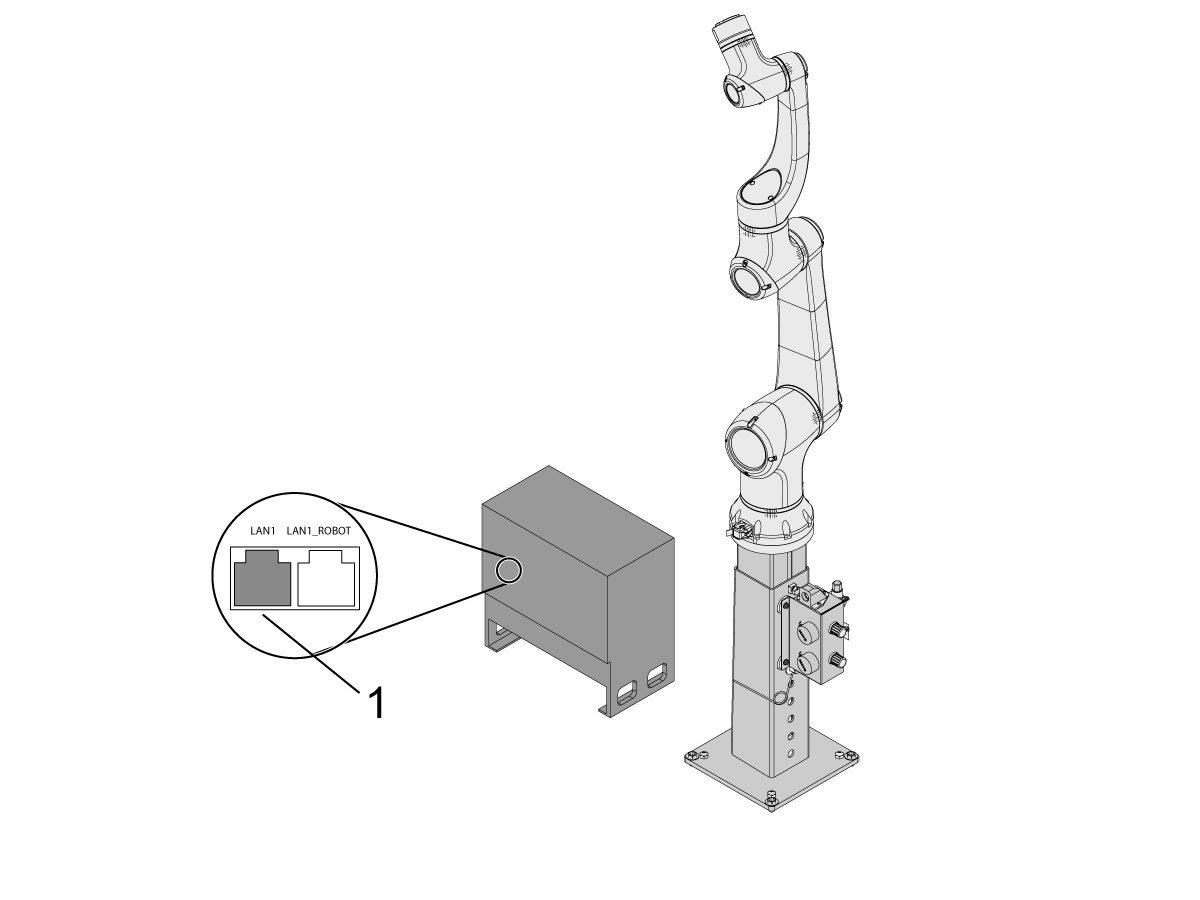

This procedure shows how to recover from a TypeError in the cobot software that can prevent the user from signing in using the teach pendant. If the error message shown in the image [1] appears when you enter the login credentials, use this procedure to troubleshoot fixing the issue.
Note: The login credentials for all haas cobots on the teach pendant are the same. Make sure you are inputting these correctly before going through this procedure.

Use an ethernet cable to connect the laptop to the LAN1 port [1] in the Cobot control box.
