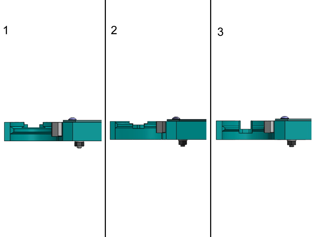

Verify that the double arm is the correct taper size and type
To differentiate between the BT, CT, and HSK verify that the BT V-flange is as shown in image [1] and the CT V-flange is as shown in image [2], and the HSK V-flange is as shown in image [3].
Verify that the double arm has the correct key slot offset
Now the casted double arm will have the key slot machined in a 0 degree angle position [1] or at a 2.5 degree angled position [2], both double arms will use only a straight key instead of an offset key.

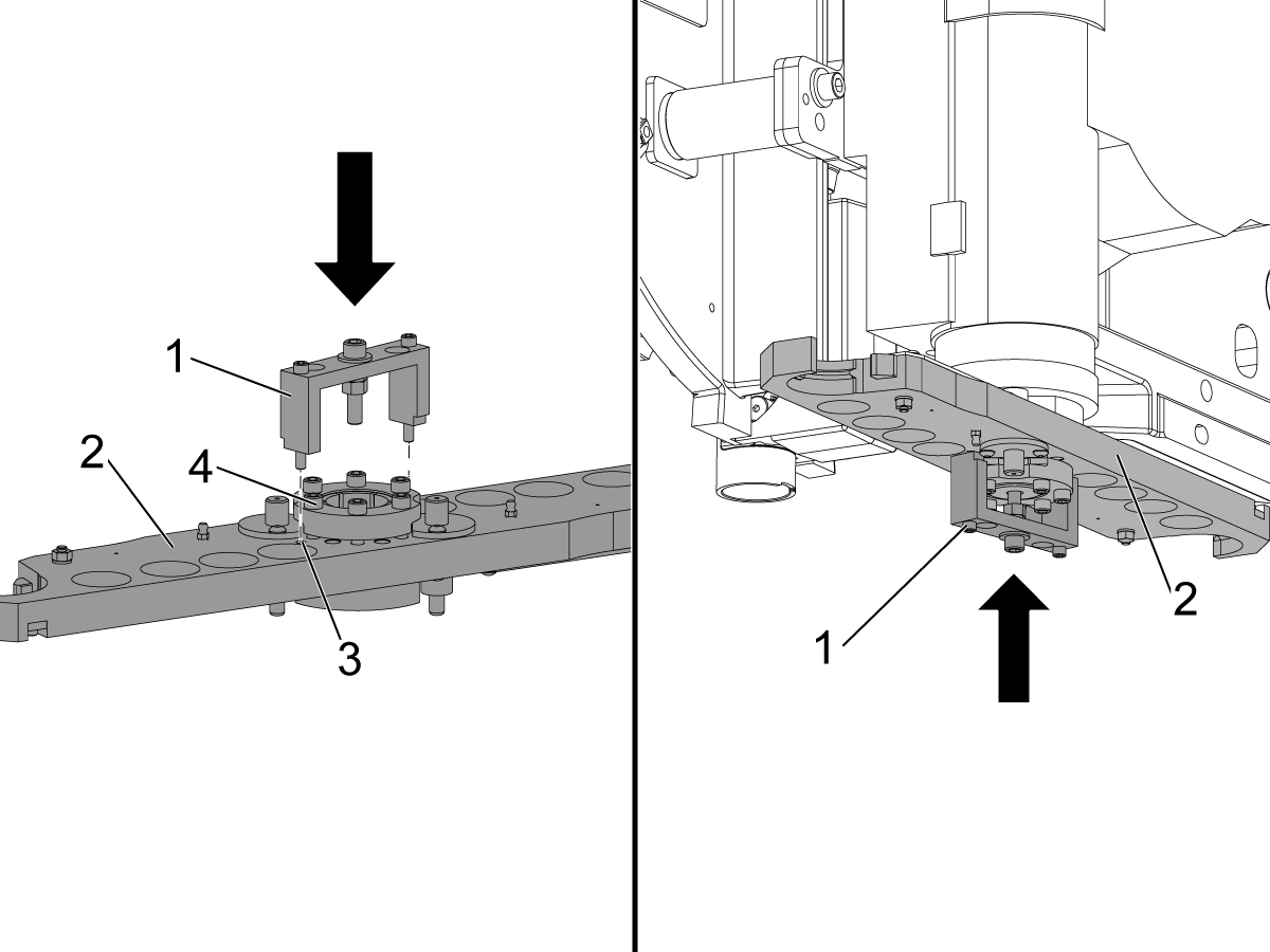

Find the (2) holes [1] adjacent to the covers for the plungers. Put the T-2108 [2] onto the double arm. Use your fingers to tighten the screws [3] to the shaft and the arm.
Loosen the (6) screws [4] from the clamp about 1/4" from the double arm. Do not move the screws.
Remove (2) of the (4) screws [5] from the hub [6]. Do not remove two screws adjacent to each other.
Insert (2) 3/8-16 x 2 1/2" jack screws [5] from the hub [6]. do not remove two screws adjacent to each other.
Insert (2) 3/8-16 x 2 1/2" jack screws [7] into the hub. Lightly grease the screw threads. Turn the (2) jack screws a small amount at a time. Do this until the double arm can turn freely on the output shaft.
Remove the T-2108 tool and double arm. Install all of the screws you removed.

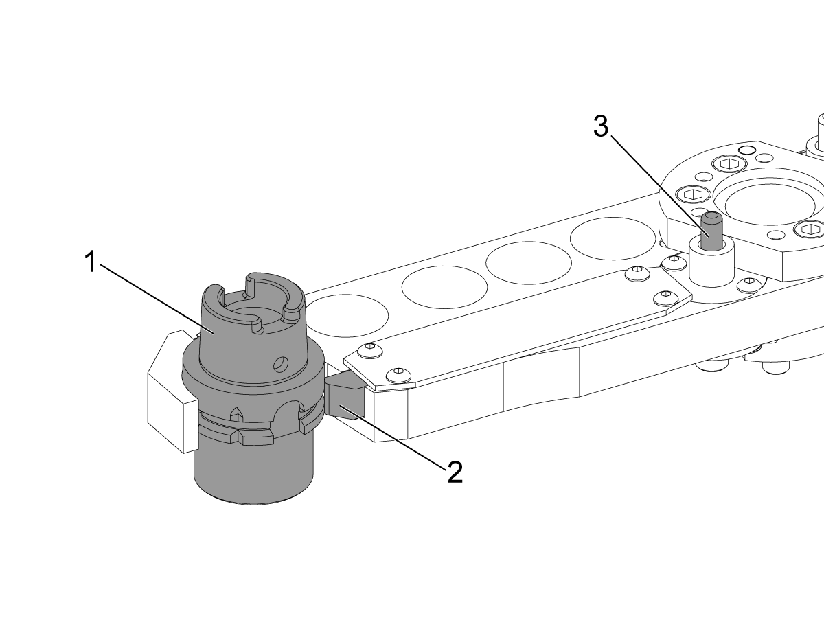

Press down on the plunger [3].
Put a tool holder [1] with no cutter into the new arm.
Push the slide [2] back into the arm as far as possible. Measure the space between the slide and the tool holder using a feeler gauge. Make sure the space is between 0.015" (0.381 mm) and 0.025" (0.635 mm).
If adjustment is necessary, use SIDE-MOUNT TOOL CHANGER - DOUBLE ARM - PLUNGER AND ADJUSTER ASSEMBLY - INSPECTION.
Remove the tool holder.
Do this step again on the opposite side of the arm.
Release the plunger [3]. The slide should return to its original position.
Install the (6) clamp screws [4] on the double arm [2]. Leave the screws loose. Make sure the clamp can move easily.
Find the (2) holes [3] adjacent to the covers for the plungers. Put the (2) screws through the T-2108 tool [1] and into the double arm [2]. make sure the notches in the tool fit over the covers for the plungers. Tighten the (2) screws.
Caution: Be sure to support the double arm during this step. If the arm is not tightly held it can fall and cause injury.
Clean all grease from the shaft. Then install the double arm [2]. Turn the screw into the shaft. You turn the center screw to lift the double arm [2] on the shaft.

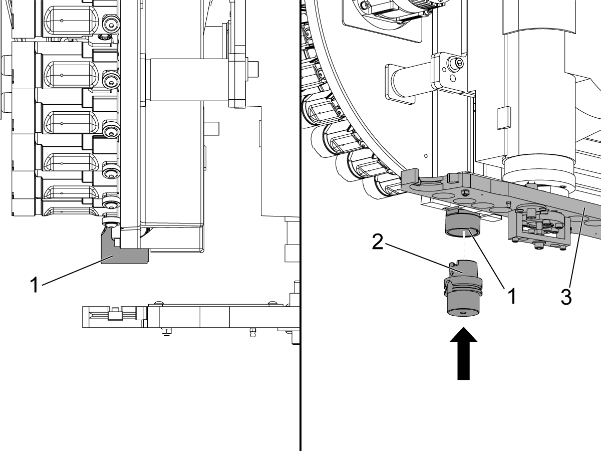

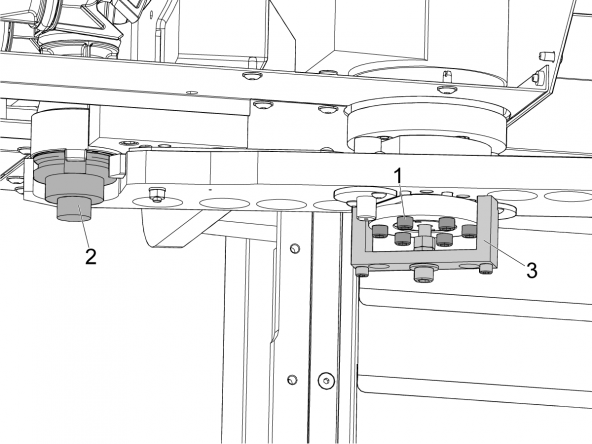

Push [ATC FWD] until DOUBLE ARM has a value of CLAMP/UNCLAMP. Manually rotate the double arm [3] to be parallel with the y-axis.
Move the tool pocket [1] to the down position.
Push [EMERGENCY STOP]. Clear alarms.
Put a tool holder [2] with no cutter into the pocket.
Manually turn the double arm [2] so the slide touches the tool holder [1]. Use a caliper [3] to measure the height between the bottom of the V Flange and the double arm.
Manually turn he double arm so the arm engages the tool holder. Use caliper to measure the height between the bottom of the V Flange and the double arm.
If the measurement is different, then adjust the height of the arm and repeat this step. Use the T-2108 tool to adjust the double arm eight. When the measurement is the same, record the measurement.

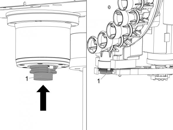

Manually turn the double arm until you can remove the tool holder. Remove the tool holder with no cutter.
Push the bottom part [1] of an alignment split tool into the arm [4] near the pocket. Install the top part [2] of an alignment split tool into the pocket [3]. Align the split tools.
Put the pin [5] for the alignment split tool into the top and bottom parts to do an alignment check. Remove the pin.
Lightly tighten the clamp screws 1/4 turn. Tighten the screws [1] in the star pattern. Do an alignment check [2] each times you tighten all the screws. Do this until the screws tightly hold the double arm.
Remove the T-2108 tool [3].
Note: You must do this action a number of times. Do this to make sure the screws are torqued to 20 ft-lbs.

Push [ATC FWD] until the slide slightly touches the tool holder [1].
Use a caliper [3] to measure the height between the bottom of the V Flange and the double arm [2].
Record the measurement. Compare the measurement you recorded in step 1. There should be no more than a 0.01" (0.25mm) difference.
If there is a difference of more than 0.01" (0.25 mm), adjust the height of the arm. For assistance freeing the arm review the Removal section from above. Adjust the arm to the correct height and start this section over.

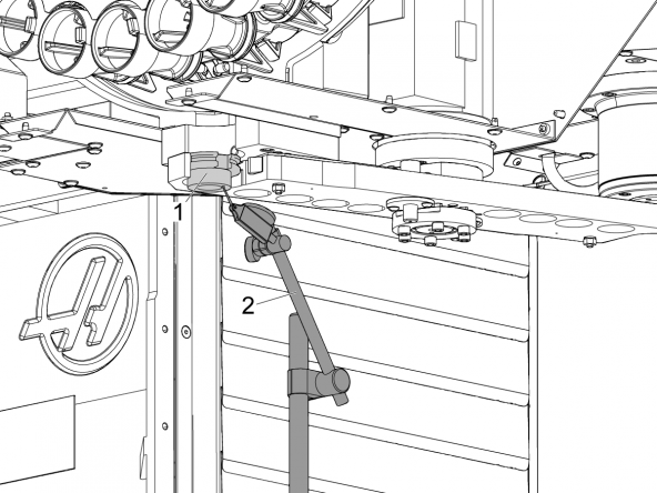

Install an indicator [2] below the alignment split tool. Put the indicator tip on the bottom of the alignment split tool. Set the indicator to 0.

Jog the indicator below the split tool. The indicator should not move more than 0.01" (0.25 mm).
