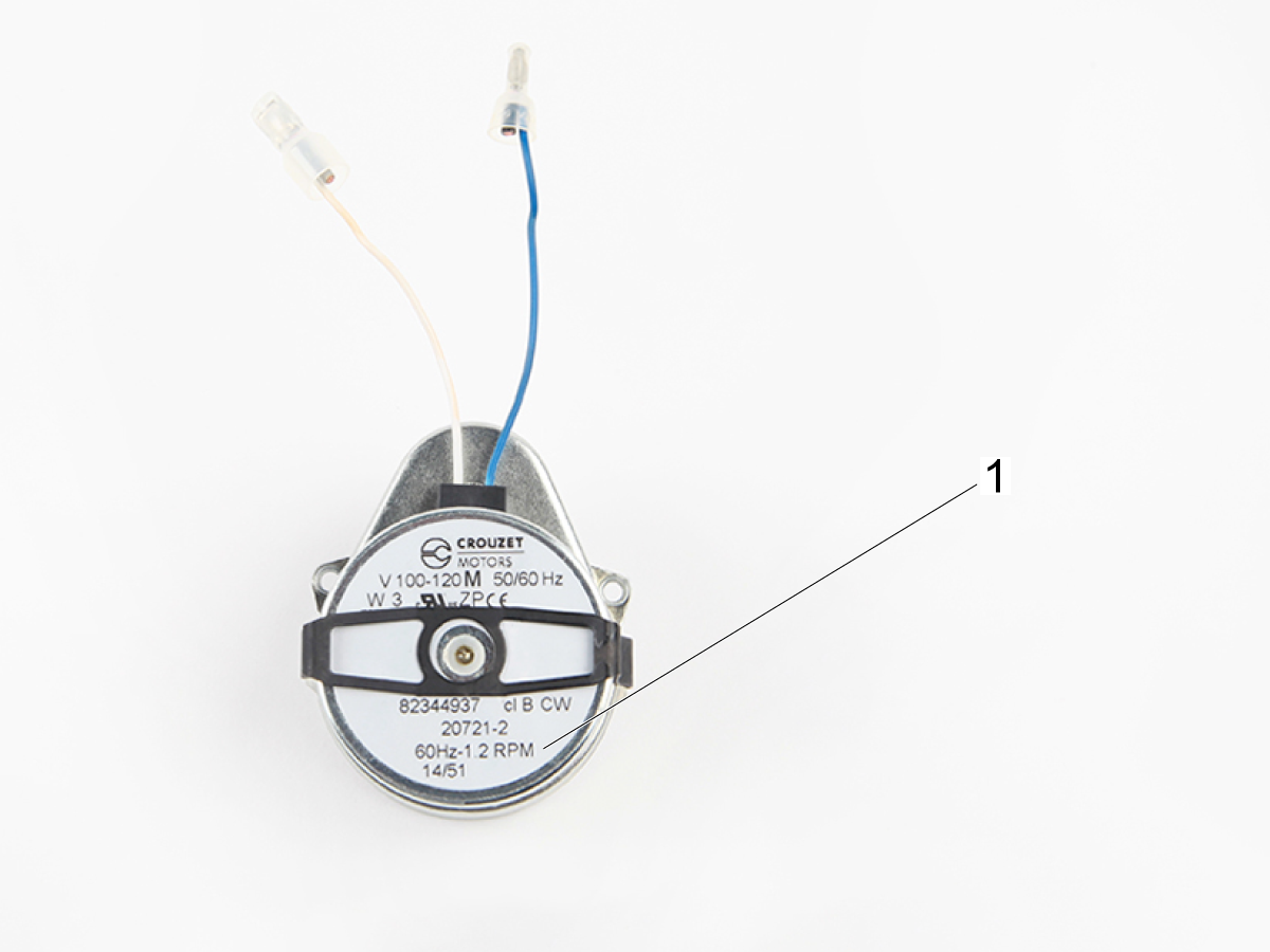

Symptom: Intermittent Alarm 112: LOW OIL LEVEL OR PRESSURE .
Possible Cause: There are two motors which have a rated rpm of 1.2 and 1.4 respectively. This is indicated on the motors label [1].
Corrective Action:
Enter service mode.
Parameter 117 will have to be calibrated for each of these rated speeds.
1.2 RPM Motor: 90000
1.4 RPM Motor: 75000
