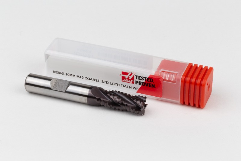

10mm Dia. Cobalt Coarse Roughing End Mill, 4 Flute, TiAIN Coated, 10mm Weldon Shank x 22mm LOC, 0.34mm Chamfer, CPR
Part #: 03-1761
REM-S 10MM M42 COARSE STD LGTH TIALN WF
Price: 19.95 ( / unit)
Price: 323.95 ( / unit)
Price: 96.95 ( / unit)
Price: 12.95 ( / unit)
Price: 58.95 ( / unit)
Price: 135.95 ( / unit)
18.97

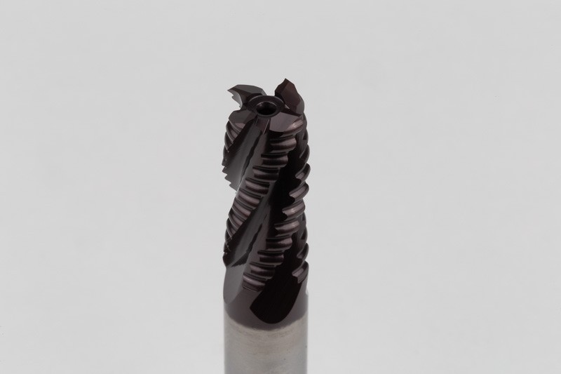

This CPR 4-flute HSSCo8 (M42) cobalt roughing end mill has a 10mm cutting diameter, with a 10mm weldon shank, 22mm length of cut (LOC), 0.34mm chamfer, and a 65mm overall length. It is TiAlN coated, and made to cut steel, but is capable of cutting some grades of a luminum/non-ferrous materials. This roughing end mill is NOT designed to center-cut.
