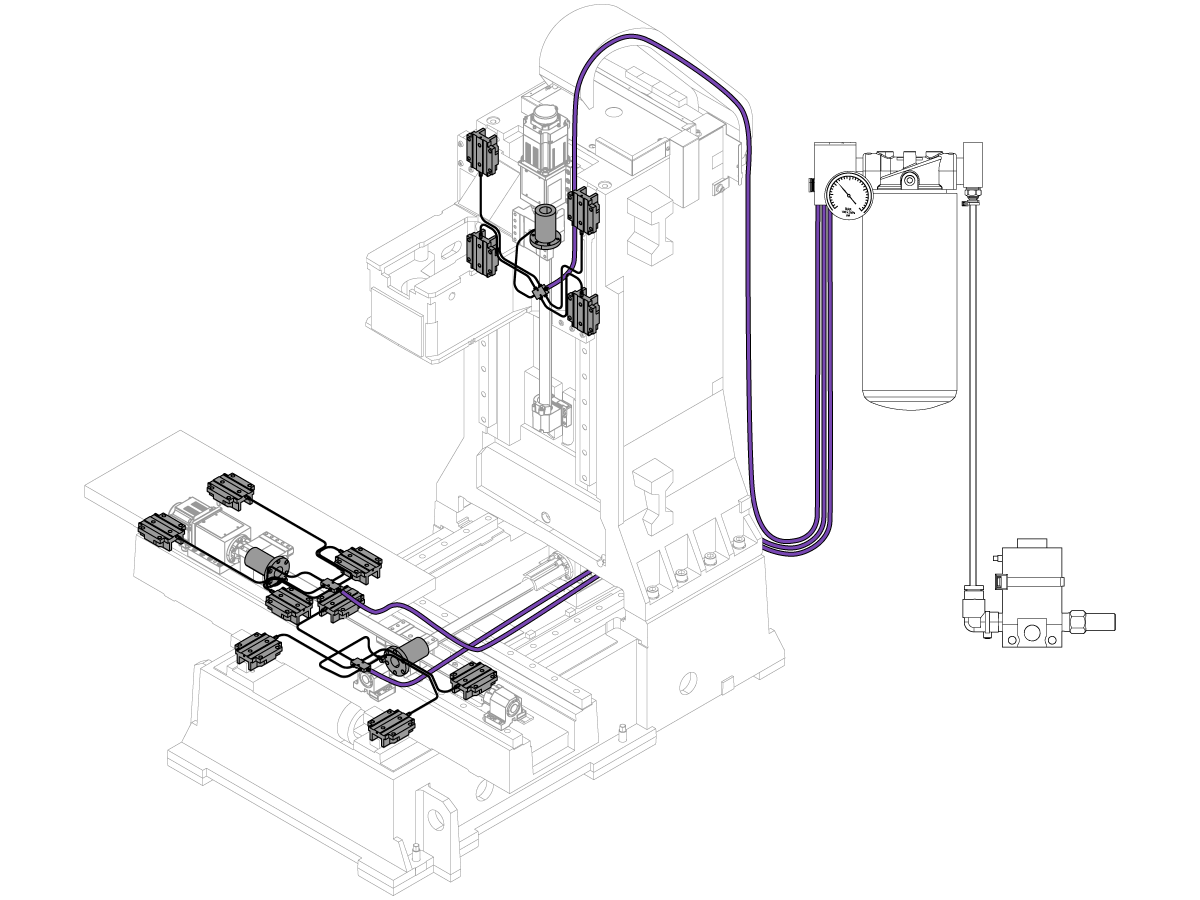

This procedure explains how to purge the thickened grease out of the copper lube lines on the linear axis. The illustration below showing the typical horizontal axis lubrication setup and has the castings removed for clarity. The location of the grease manifold will vary depending on the machine model and the axis.

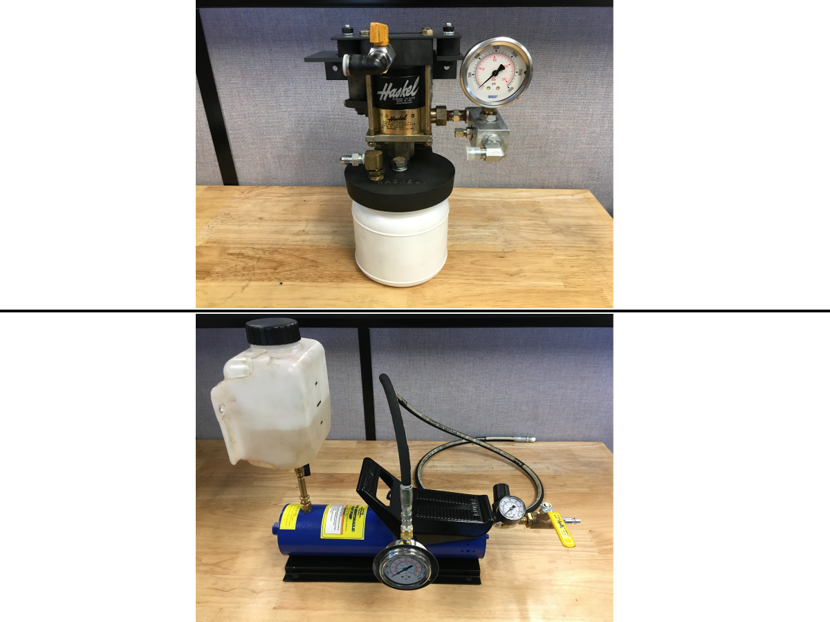

A liquid pump is used to drive oil through the lube lines to clear the obstructions. We recommend using the Haas Pump 30-7510. This is an air driven pump that can build enough pressure to clear the lube lines. An air driven pump from your local hardware store can also be used. Be sure to not exceed 3000 PSI when pressurizing the copper lube lines or you can cause them to fail. Use a pressure gauge to ensure you are at a safe pressure when operating the pump.
Remove the barb fitting [1] from the manifold. Install the 58-3657 reducer [2] and the 58-1684 JIC fitting [3] onto the manifold. Connect one end of the 59-8621 hydraulic hose to the JIC fitting [3] at the grease manifold. Connect the other end of the 59-8621 hydraulic hose to the JIC fitting [4] at the 30-7510 pump. Make sure that the ball valve [6] is in CLOSED position and connect the air supply [5]. Fill up the 30-7510 pump tank with the Mobil DTE24 oil. Open the ball valve [6] to turn ON the pump. Run the pump untll there is a steady oil flow out of each linear guide truck and the ballscrew ballnut [7]
