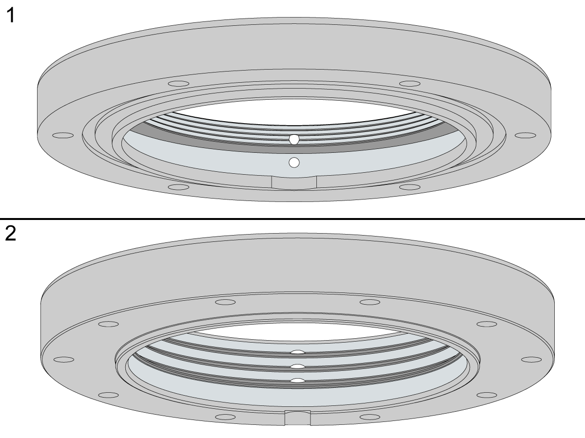

Spindle Cap Identification
Depending on machine vintage the front spindle retainer cap of your machine may be the hollow design [1] or the updated current solid design [2].
Important : If your machine has the hollow cap design ensure that it is replaced when replacing the spindle since it deforms by design and cannot be used for multiple spindles.

Install New Spindle
Depending on the build date of the machine. If PN: 58-3050 FITG PC1/4F NPT1/8M 90 STL[1] is installed on the oil injector. Replace the fitting with PN: 58-2195 FITG PC1/4F NPT1/8M 90 STL[2].

  • Install the spindle retainer cap [2]
  • Snug the spindle cap srews [3]
  • Use a .001" shim [4] between the cartridge and the spindle retainer [2]
  • Tap the spindle retainer with a plastic mallet until the shim clears every section of the cartridge
  • Torque the retainer screws [3] in a star pattern.
    • Note:You may need to start at a 1/3 of the torque value and torque them down 3 times. Torqueing down all the way the first time may displace the retainer cap and require it to be reset.
  • Sweep between the cartridge and the retainer cap one last time to verify the .001" shim has clearance all the way around [4]
 Important : Ensure that a Spindle Deflection Test is conducted to verify spindle pre-load.
Note : Refer to Spindle Cap Identification section.
