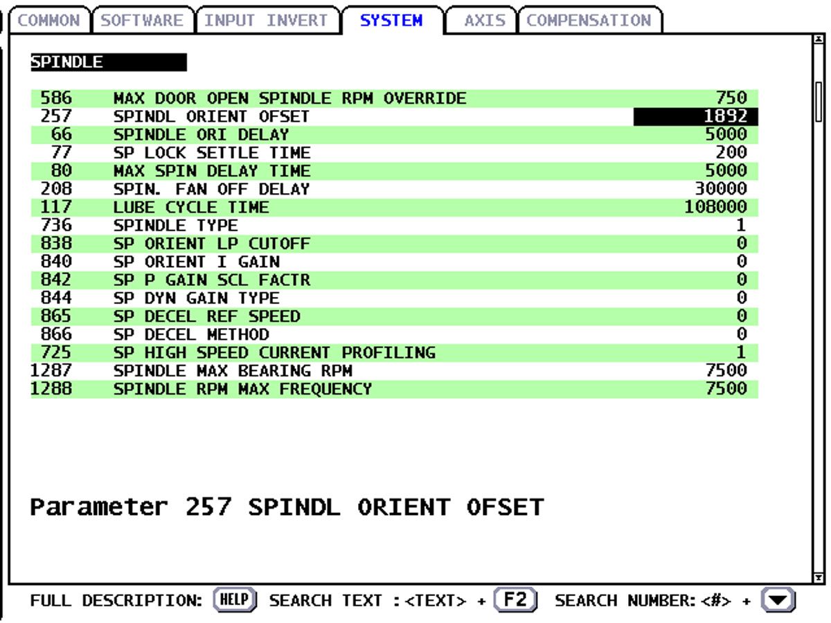

  3. Push [PARAMETER/DIAGNOSTIC]. Go to Parameter 257.
  4. Increase the value of Parameter 257 in increments until the spindle dogs are parallel to the x axis after you push [ORIENT SPINDLE].
 Note: If you add 1000 to the value of Parameter 257, this equals approximately 1/4 turn of the spindle orientation location.

Divide the value of Parameter 79 by 360. This tells you the number of encoder counts per degree of spindle rotation.
Example: Parameter 79 = 4096 ; 4096 / 360 = 11.37
Multiply the number of encoder counts per degree of spindle rotation by the correct value for your machine: 30-Taper = 88.6; 40-Taper = 74; 50-Taper = 66.6. Round the result to the closest whole number. Subtract the rounded number from Parameter 257. Refer to examples in the table below.

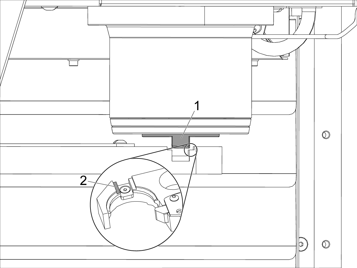

Operate a tool change with no tools in the spindle or pocket.
Push [FEED HOLD] when the tool changer arm is at the spindle. Make sure the spindle dog [1] is aligned to the key [2] on the tool changer arm.
 Note: To make a fine adjustment to Parameter 257, push [CYCLE START] to complete the tool change. Increase or decrease the value of Parameter 257 in increments of 10 until the spindle dogs are aligned.  Repeat this step if necessary.

Example Table
Taper Multiply encoder counts per degree of spindle rotation by the correct value for your machine Round to the closest whole number Subtract from Parameter 257
30‑Taper 11.37 * 88.6 = 1007.382 1007 1892 - 1007 = 885
40‑Taper 11.37 * 74 = 841.38 841 1892 - 841 = 1051
50‑Taper 11.37 * 66.6 = 757.242 757 1892 - 757 = 1135
