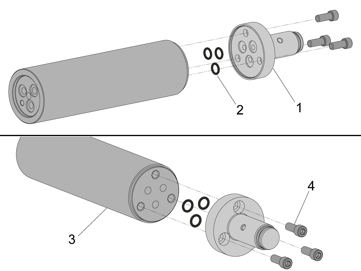

Attach the hydraulic shaft [1] to the three port rotary union shaft extension [3] using the 3 bolts [4] provided.
Add the three o-rings [2] in between the them to make sure each hole has a proper seal.
Note: Double the check the orientation in which the hydraulic shaft is attached to make sure the three holes are aligned correctly.
Attach the rotary extension [1] to the pallet receiver and place the o-rings [2] between the two pieces.
Note: The o-rings must be seated properly to create a good seal or else the extension will leak.
When attaching the rotary extension, the alignment pin [3] in the pallet receiver will make sure the rotary extension is clocked in the correct orientation. Once attached, use the bolt [4] to keep the two assemblies together.

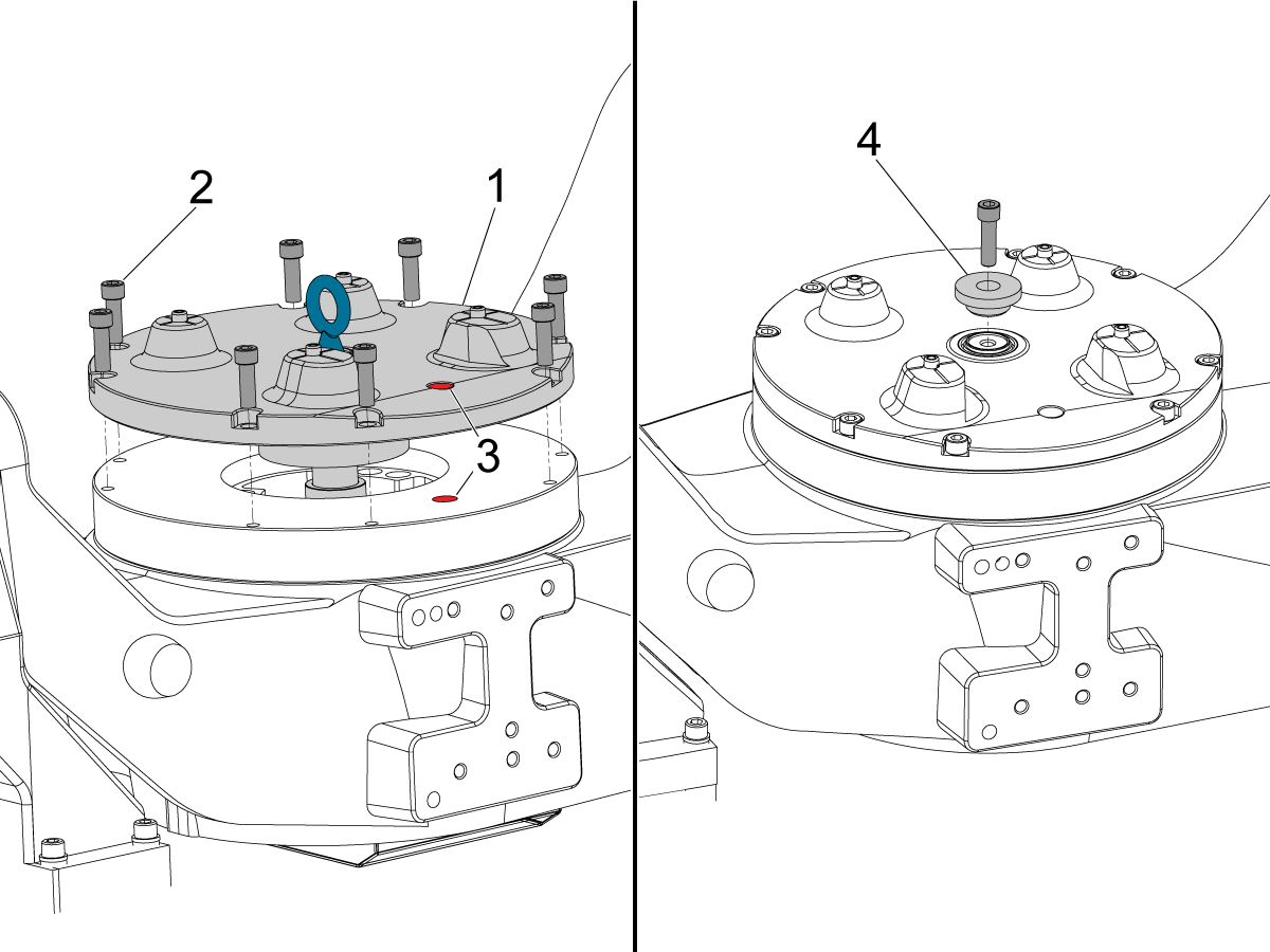

Attach the provided  1/2-13 eye bolt [1] to the piston of the pallet receiver. Use this as the lifting point for the pallet receiver when transferring it into the machine.
6
Using a 1/2-13 eye bolt to lift and install the receiver [2] using the hardware provided.
Remove the eye bolt and install the Pull Stud [4] with its hardware.
Torque the bolts to their required specs
Important: When installing the receiver [1] verify the C-Axis brake bleed screw is accessible [3].
After the platter is torqued down, refer to steps 6-9 of the Platter Installation section of the UMC C-Axis Platter Replacement procedure to reconnect the C-Axis brake.
