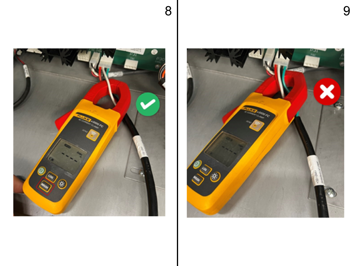

Figure 8: Correct method to measure current.  Figure 9: Incorrect method to measure current.
Using a current clamp meter set to measure nominal AC current, clamp the meter around a single conductor on the power cable. After checking the pump hose is secured, turn the pump on and let it run for 5 seconds.
Record the nominal running current from the current clamp and then stop the pump. Repeat this step for all the remaining conductors on the power cable making sure to record the nominal running current for each conductor excluding the green ground conductor.
Remove the pump from the coolant reservoir and repeat step 2 and 3 with the coolant pump outside of the coolant reservoir.
Compare the recorded nominal running current values from step 2 and 3 to the known nominal running current values for the specific pump size as shown below.
  • If the recorded nominal current values are within the known nominal current values +/- 20%, then the pump and circuit breaker are not faulty and the other parts of the coolant system should be inspected.
  • If the recorded nominal current values are higher than the known nominal running current values shown, then the pump needs to be inspected for any faults which could be causing the higher running currents.
