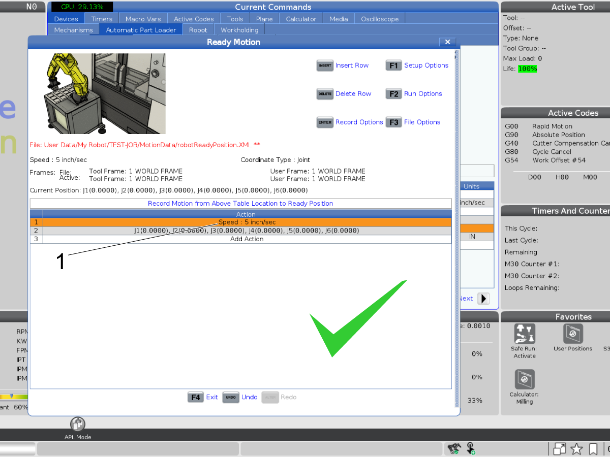

Alarm 9154 - Robot Motion Undefined
9154 alarm can be generated by not having a motion file defined correctly.
In the image you can see that the 9154 alarm has been generated. Looking at the motion file you can see that there is no Speed action before the movement action. The motion file only has a joint movement [1] specified.
The Speed action needs to be set before any robot movement actions are specified.
In this image you can see that there is a Speed action set [1] before the motion is commanded.
This motion file will execute without any issues because the motion has a defined speed before it in the sequence.
Note: The Speed action needs to be listed before the motion as shown in the image.
