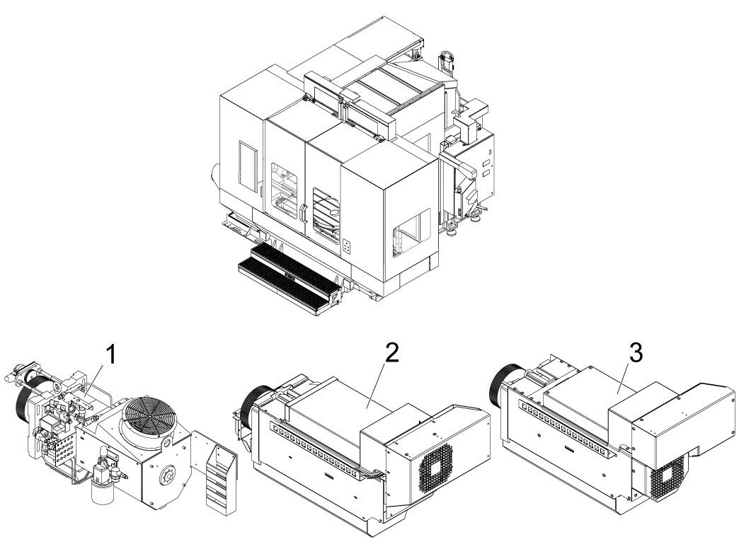

A 16DP-50M gearbox [1, 2] has these properties:
  • The covers are the same as the covers in the illustration.
  • 16DP-50M is engraved on the top of the gearbox housing inside of the enclosure.
A 16DP-C gearbox [3] has these properties:
  • 16DP-C is engraved on the top of the gearbox housing inside of the enclosure.

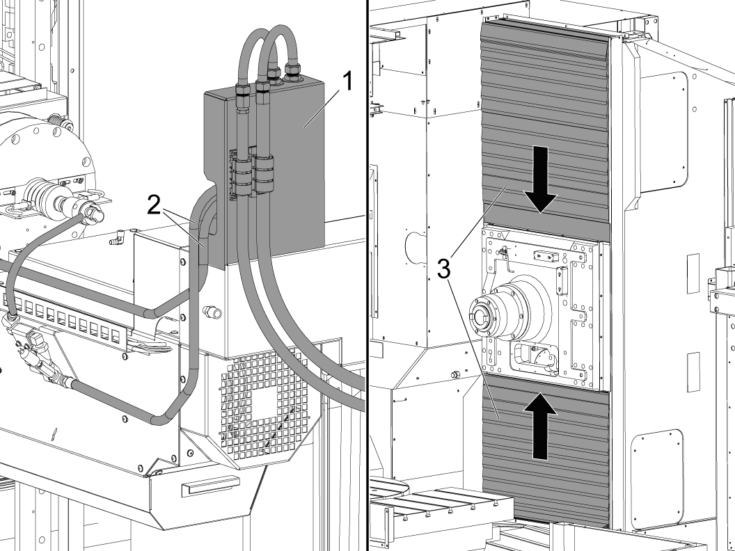

If the machine has Through-Spindle Coolant (TSC) [2.3], remove the rotary or bearingless union, hoses and wiring.
NOTE: Refer to the VMC, HMC - 50-Taper - Belt Drive - TSC - Bearing Union - Upgrade to Bearingless Union Procedure for further details.
Jog the Y-Axis to a position that lets you easily remove the gearbox. If there is tooling in the spindle, remove it.

Disconnect the Y-Axis way cover assemblies. Hold the upper way cover in position with C-clamps.

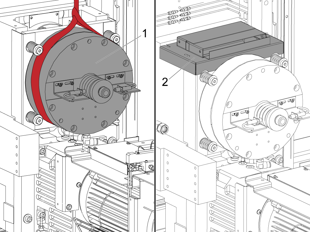

Put an applicable strap from a hoist around the TRP assembly and loosen the TRP screws.
NOTE: Record the quantities and locations of the shims. These are typical. Your counts can be different.
  • [3] 0.015 Shim Washer ( Quantity: 3).
  • [2] 0.010 Shim Washer (Quantity: 2).
  • [1] 0.093 Nylon Washer (Quantity: 1).
Remove the TRP assembly.

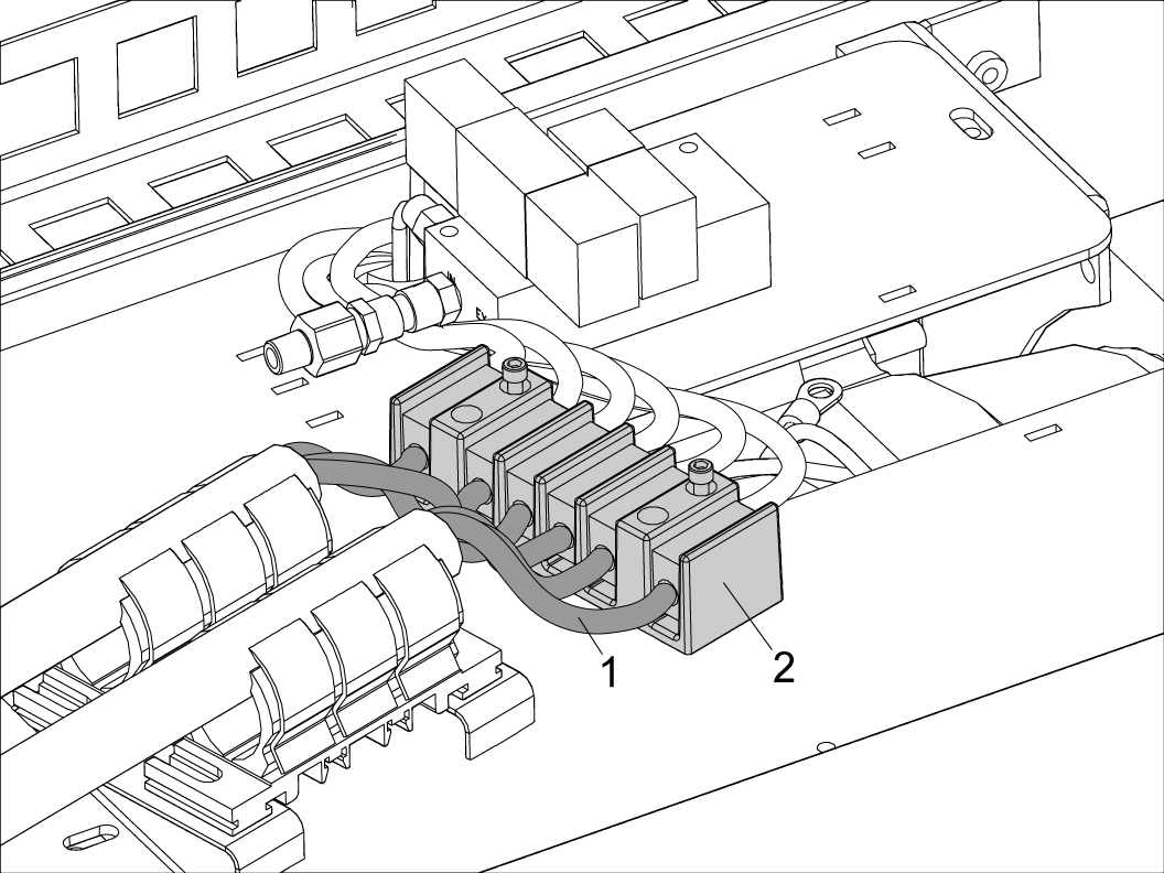

Remove the electrical cover plate on the spindle. Record the location of the cables and remove the cables [1] from the spindle connection block [2].
Disconnect the spindle cables from electrical control box.

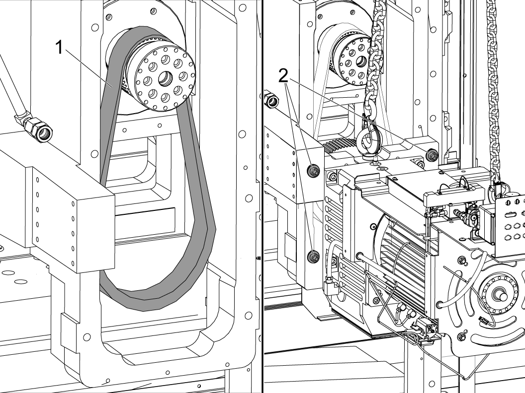

Install a threaded lifting eyebolt [1] into the top of the motor plate. The rear lifting point [2] is attached to the gearbox assembly. Attach the chain sling to the lifting points for the gearbox. Make sure the chain or strap can lift 300 lb (136 kg) or more.
Loosen the (4) gearbox screws. Make sure to support the gearbox assembly with the hoist. Make sure not to adjust the jack screws during the removal.
Remove the (4) gearbox screws. Remove the gearbox from the machine.

Install the spindle belt [1] on the spindle.
Install an eyebolt into the top of the motor plate. The rear lifting point is part of the gearbox assembly. Attach an applicable strap or chain to the lift points. Make sure the chain or strap can lift 300 lb (136 kg) or more.
Install the (4) gearbox screws [2]. Lightly tighten the gearbox screws and slowly lower the gearbox.

Put the TRP [1] assembly into place.
Put the correct number of washers and spacers in the recorded locations.
Install and tighten the TRP screws.
NOTE: Refer to Haas Fastener Torque Specifications for correcttorque values.
If the TRP has enclosure panels [2], install them. Connect the TRP air lines and proximity switches.

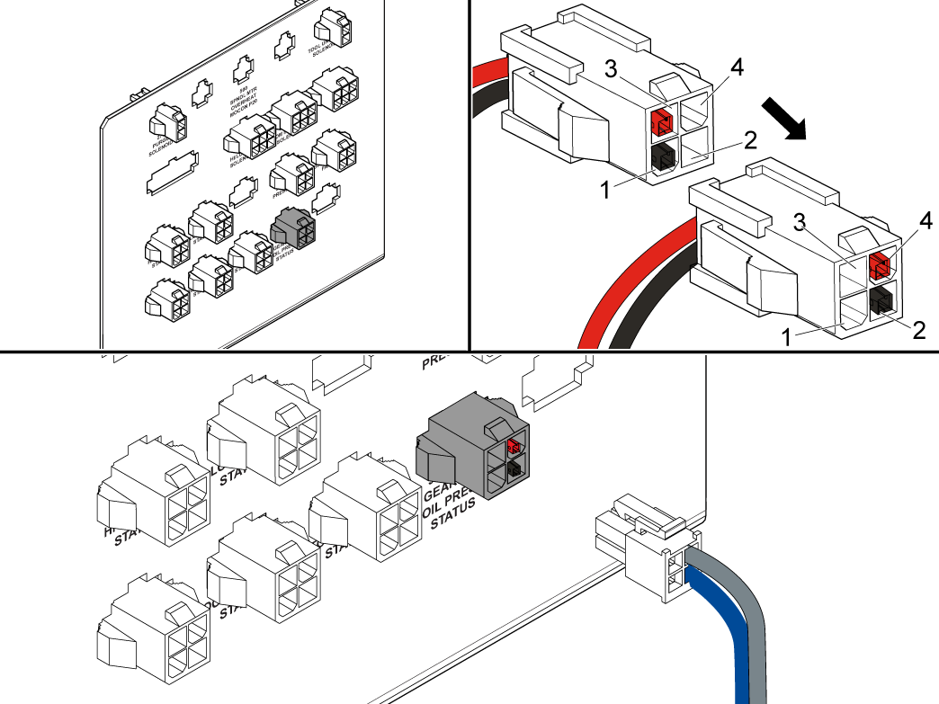

Do this step if the gearbox you removed is a 16DP-50M.
Disconnect the connector that has the label 950 LOW GEARBOX OIL PRESS STATUS. Refer to Molex Connector - Change Pin Locations.
CAUTION: Do not use a different tool to change the pin locations.
This can cause damage to the pins.
Change these pin locations:
  • 1. Move the Molex pin in position 3 to position 4.
  • 2. Move the Molex pin in position 1 to position 2.
Install the molex connector to the position with the label 950 LOW GEARBOX OIL PRESS STATUS. Install the Molex connector from the gearbox to the Molex connector. Make sure the pins on the Molex connectors align.
