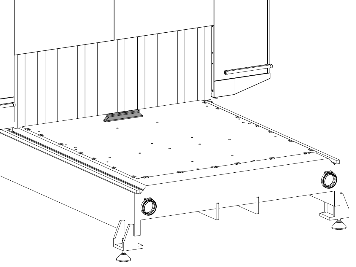

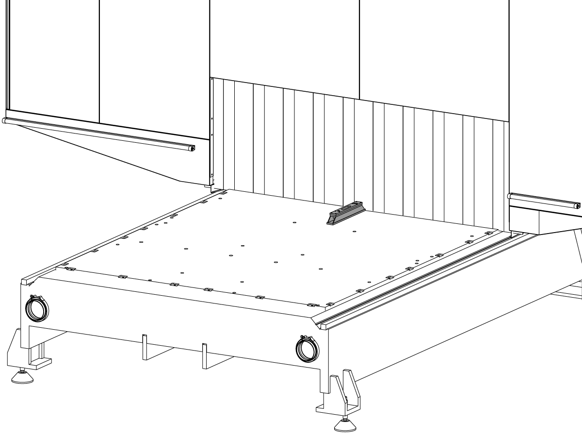

Leveling Screws Hardware
Note: The washers [1] and nuts [2] are installed during shipping and should be saved for installation and not be discarded.
Note: The washer orientation [3] is important.  The conical part of the washer should be against the casting,  see illustration.

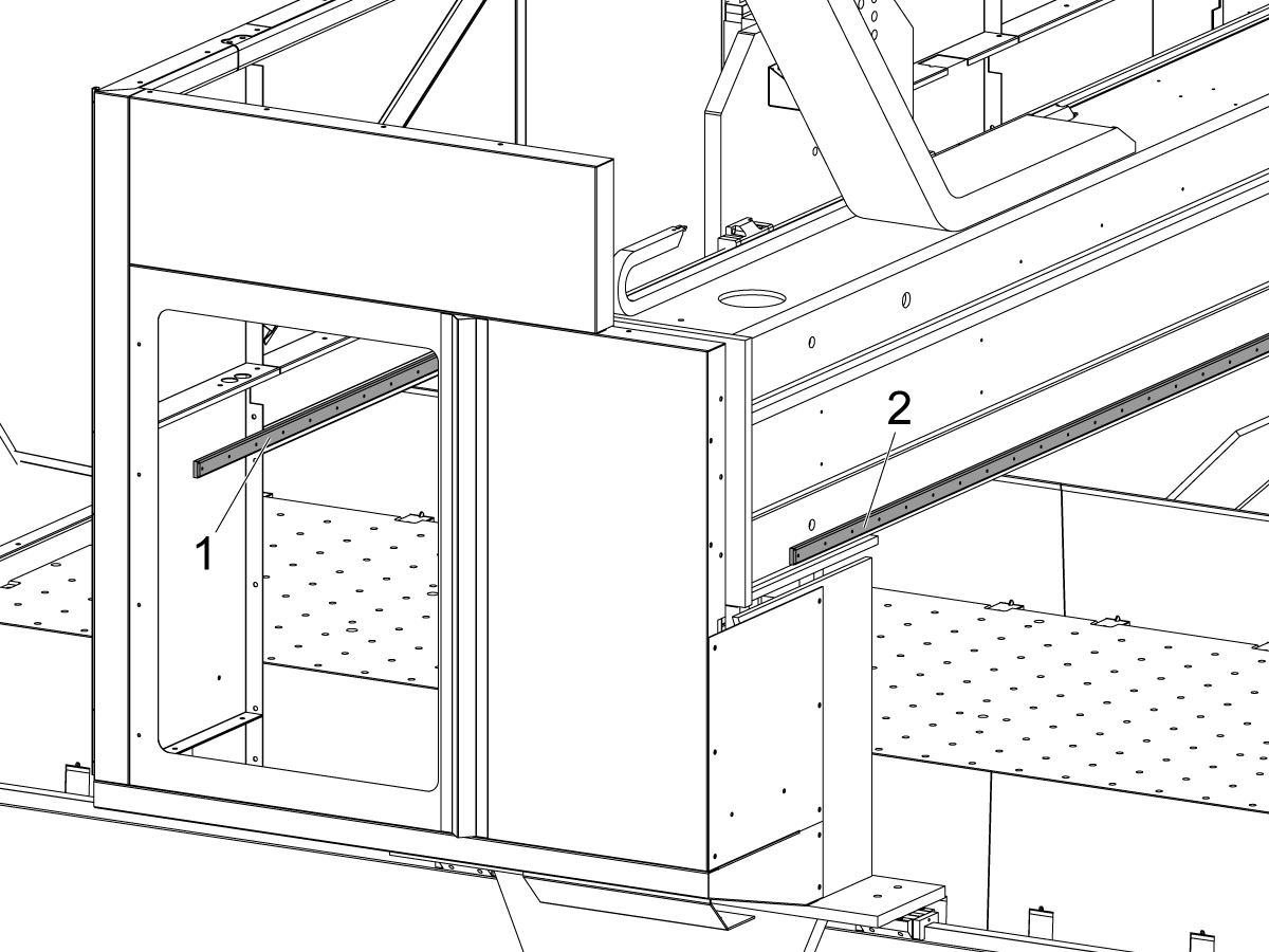

Install the stiffener brackets [1] & [2] in the location shown in the image.
Follow the next step for further instructions of the orientation of the stiffner brackets.
Install the left stiffener bracket [1] and the right stiffener bracket [3] to the enclosure.
Mount the left stiffener bracket [1] in the orientation shown with the 90 degree angle on the inside of the enclosure. This bolts to the enclosure highlighted in red as [2].
Mount the right stiffener bracket [3] in the orientation shown with the 90 degree angle on the inside of the enclosure. This bolts to the enclosure highlighted in red as [4].
