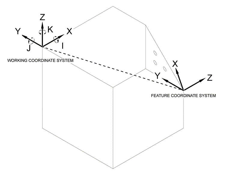

G268 Feature Coordinate System
Feature Coordinate System (G268) is a new feature in the Haas control unique to this “gimbal head” style machine. By definition, the work plane is perpendicular to the spindle centerline. On all other Haas 5-axis milling machines, the spindle centerline is parallel to the Z-axis, so no matter the orientation of a workpiece mounted on a rotary table, the work plane is perpendicular to the Z-axis. This assumes fixed angle heads are not used . . . more on that later.
G268 Feature Coordinate System (continued)
Now that the spindle centerline (cutting tool) can tilt to virtually any angle, we created G268 Feature Coordinate System to simplify programming of planar toolpaths in tilted work planes, including canned cycles, circular interpolation, and cutter compensation.
Command G268 with X-, Y-, and Z-axis coordinates in the Workpiece Coordinate System to establish the zero point of a new Feature Coordinate System. The tilted work plane angle will be perpendicular to the current tool axis direction using the actual tool axis angles (B & C axes on GM-2-5AX). The tool axis direction may also be defined using optional address codes I, J, K with G268. This alternative method of defining the angles allows the use of G268 Feature Coordinate System with fixed-angle heads on 3-axis milling machines, as well as 2- and 3-axis lathes.
G253 Orient Spindle Normal to Feature Coordinate System
G253 Orient Spindle Normal to Feature Coordinate System simplifies programming tilted work planes when using multiple tools in the same tilted plane.
When G268 (Tilted Work Plane) is active, the tool axis direction and Feature Coordinate System are stored in the control. When work is finished with a particular cutting tool in the tilted plane, you can retract to a safe position and command a tool change. Once the tool is changed and repositioned to a safe location, command G253 (Orient Spindle Normal to Feature Coordinate System) to return the tool axis to the tilted work plane. There is no need to cancel the tilted work plane and define it again for the next tool, just because you performed a tool change.
