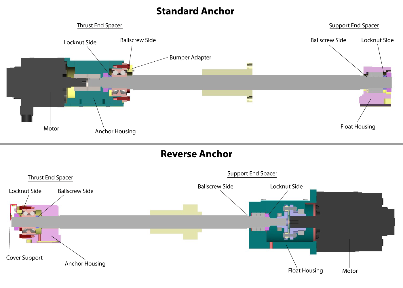

Diagram
 NOTE: The diagram is only meant to help understand the naming conventions, the ballscrews installed may look different.

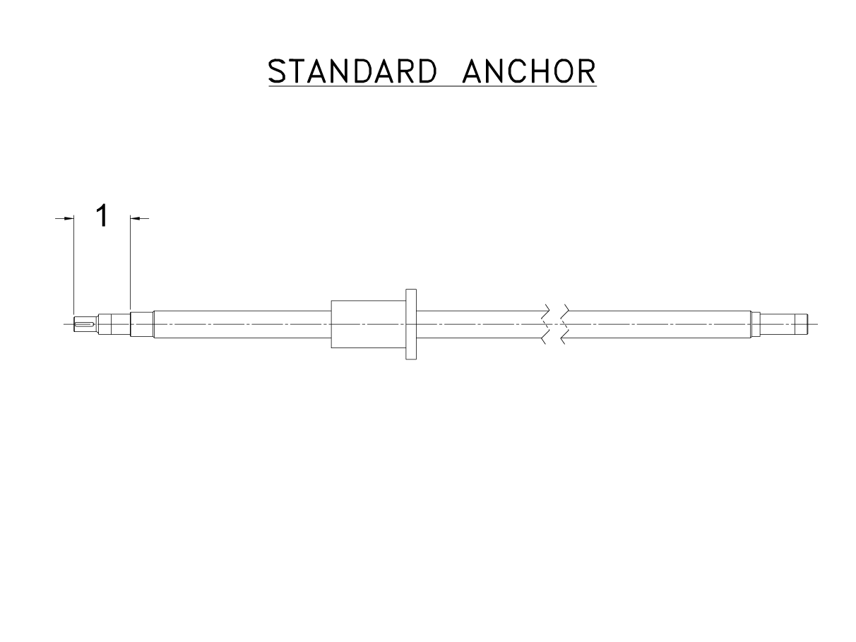

To find which style ballscrew is being installed in the machine, the thrust end length denoted as [1] must be measured.
NOTE: "OLD" style ballscrews refer to ballscrews with longer thrust end lengths [1].  "NEW" style refer to ballscrews with shorter thrust end lengths [1].
  • “OLD” style: 4.265”
  • “NEW” style: 2.835”

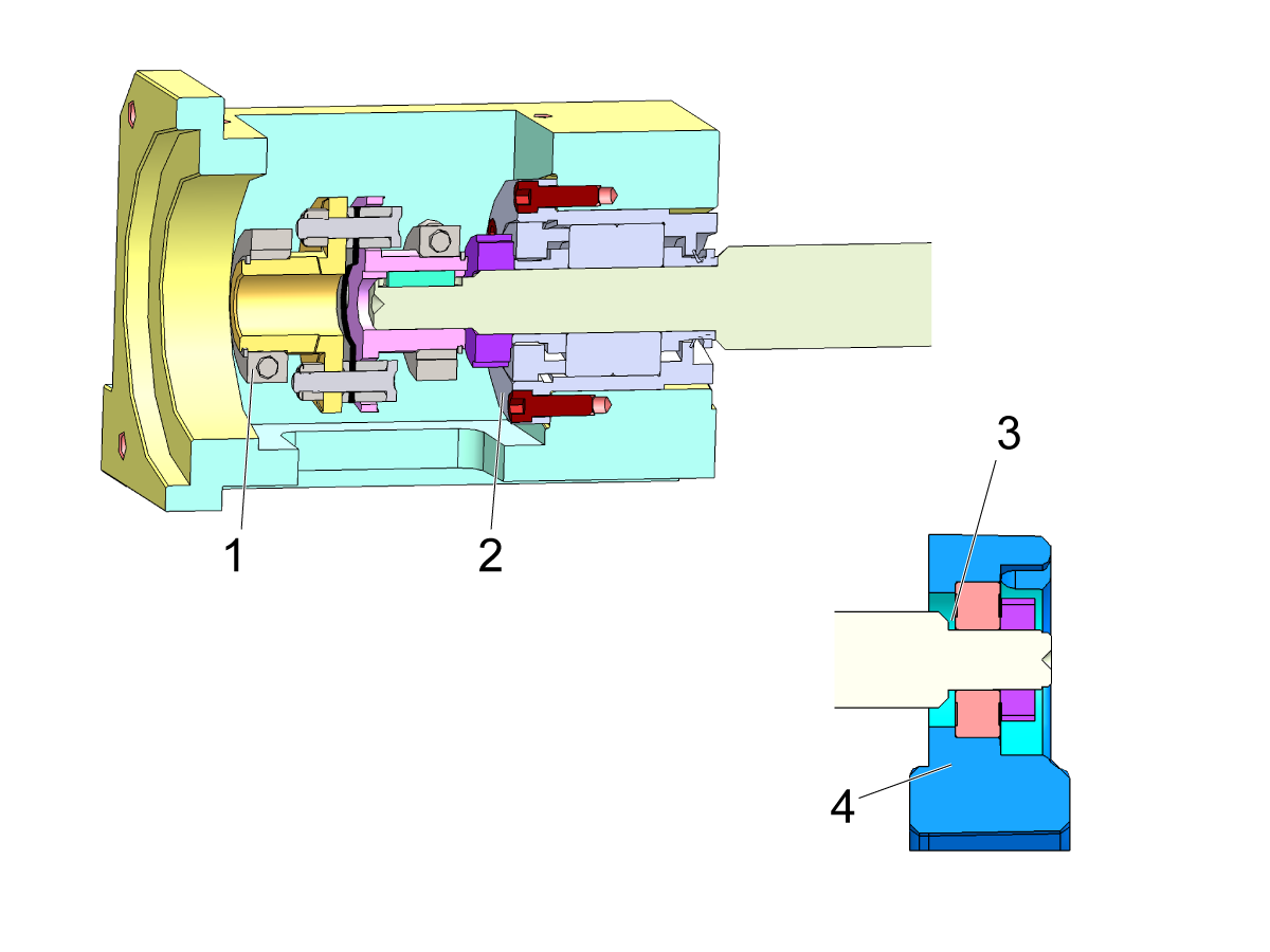

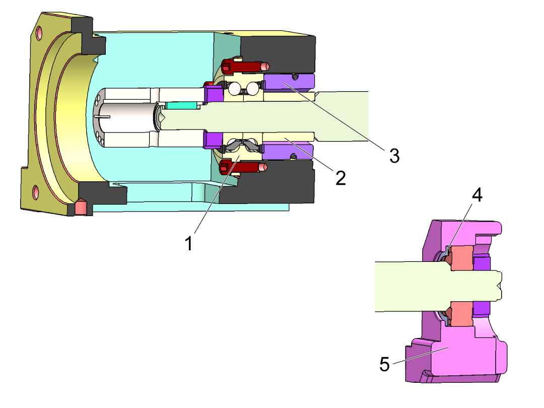

OLD BALLSCREW / NEW BEARING: Ballscrews built before 12/2013
Ballscrews built before 12/2013 had a flex coupling (30-1220A) [1] the original bearing pack (30-0154) [2].
This ballscrew also had the support casting assembly (30-0153) [4] which had a press fit bearing that had a gap between the shoulder of the ballscrew and the bearing [3].
NOTE: This was only preloaded to 4 in-lbs

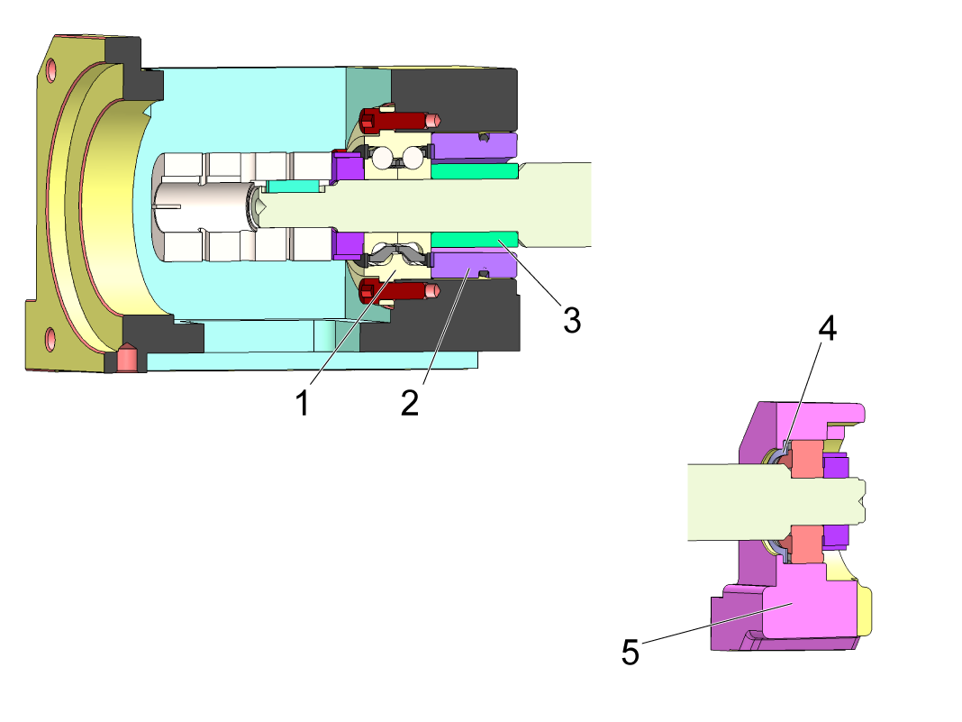

OLD BALLSCREW / NEW BEARING: Ballscrews built from 12/2013-6/2014
Ballscrews built from 12/2013 to 6/2014 had a flex coupling (30-1220A) [1] the first iteration of the cartridge bearing (51-0213/A) [2] which included a spacer [3] to compensate for the smaller bearing size.
This ballscrew support casting assembly was changed to 30-12054 [5] which had a slip fit bearing that no longer had a gap, but used a wave spring [4] to properly preload the bearing.
NOTE: This was only preloaded to 10 in-lbs.

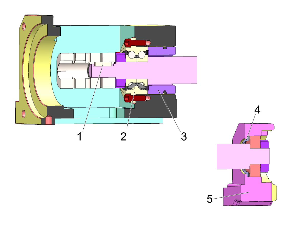

OLD BALLSCREW / NEW BEARING: Ballscrews built from 3/2016 to present
Ballscrews built from 3/2016 to presently had the flex coupling changed to the solid couplings (30-1220A) [1].
This assembly also included first iteration of the cartridge bearing (51-0213/A) [2] which included a spacer to compensate for the gap between bearings and ballscrew [3].
OLD BALLSCREW / NEW BEARING: Ballscrews built from 10/2016 to present
Ballscrews built from 3/2016 to present had a bearing filler (28-0371) [3] added to the assembly to prevent bumpers from crashing into the bearing.
During this time the ballscrews were cartridge bearings were changed after 1/2019-7/2020 to a new part number (51-0268) [1].
This still includes a spacer to compensate for the gap between bearings and ballscrew [2].

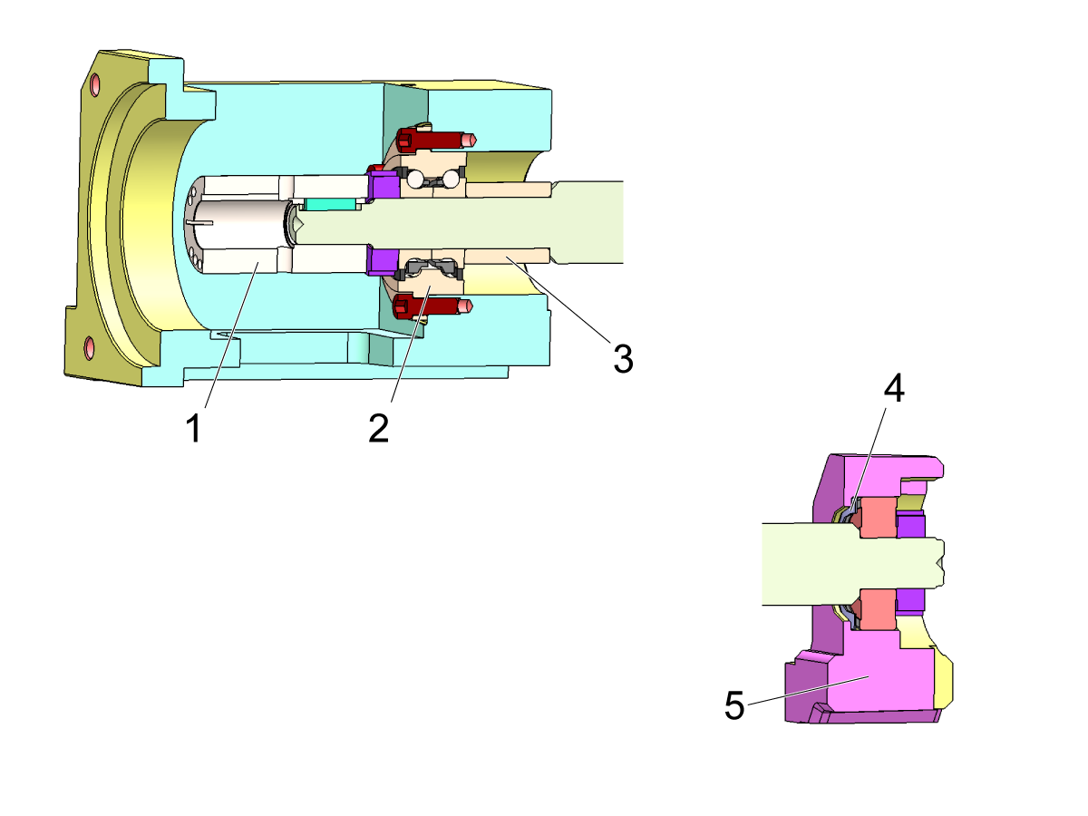

NEW BALLSCREW / NEW BEARING: Ballscrews built after 5/2020 to present
Ballscrews built after 5/2020 had standardized keys [1], these keys are backwards compatible with keys of ballscrew assemblies built prior.
In the same year Haas changed the ballscrew to the “new” style ballscrew. Ballscrews built after 9/2020 have a longer journal to fill the empty space left by changing to the cartridge bearing [2].
This meant that the assembly would no longer need the ballscrew spacer, but still has the bearing filler  (28-0371) [3].
This would be the first iteration of the NEW BALLSCREW / NEW BEARING combination.

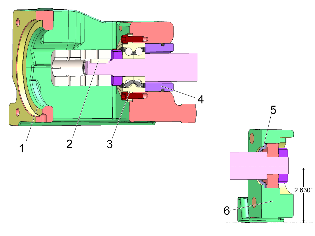

Ballscrews built after 2/2021 were built with updated motor and support end castings.
These updates not only changed appearance, but added material to the bottom of the ballscrew motor end (30-12659A) [1] and support end casting (30-12660) [6] with a wave spring [5] still part of the assembly.
NOTE: The measurement of 2.630 in. will be further explained in the next step
Additionally, this also removed material from the mounting pads of the machine castings the support and motor housings are installed on. This change was to address issues found in production.
IMPORTANT: If the machine needs a replacement motor and support end castings these style castings CANNOT be ordered for previous assemblies as they are NOT backwards compatible with machines built prior to this date.
This assembly has the new style ballscrew, standardized key [2], newest style cartridge bearing [3], and bearing filler [4].

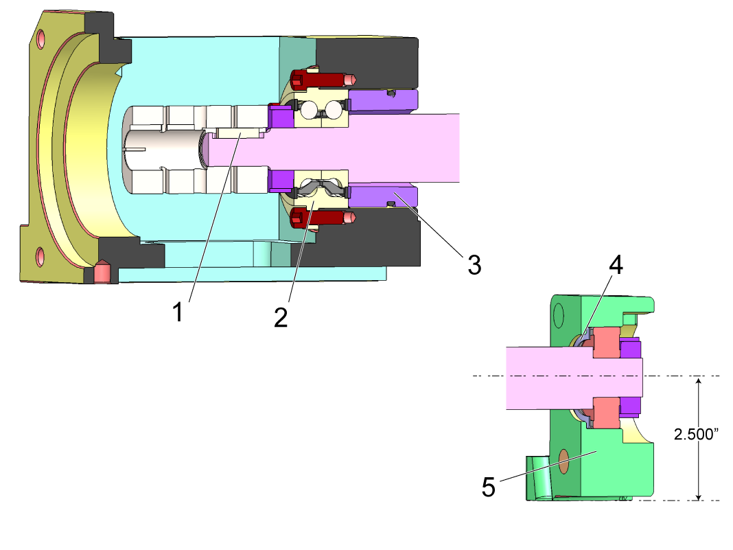

NEW BALLSCREW / NEW BEARING: Ballscrews built after 7/2020 to 2/2021
In the previous step the newest version of the ballscrew assembly with the updated motor and support end castings were displayed and it was stated that it was not backwards compatible. They are not, but ballscrews built after 7/2020 until 2/2021 may have the updated support end casting style , but the material added to the bottom of the casting is not present (30-12054A) [5].
The image shown shows that the distance from the centerline to the bottom of the casting is 2.500” whereas the previous step shows that same distance as 2.630”. This casting style with the centerline distance as 2.500” is backwards compatible with all the previous version castings mentioned.
This assembly has the new style ballscrew, standardized key [1], newest style cartridge bearing [2], and bearing filler [3].
