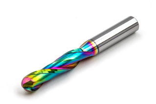

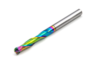

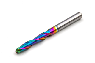

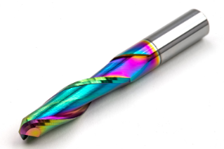

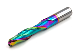

03-3386
3.2mm Dia. Carbide Ball End Mill CNC Router Bit, 2 Flute, DLC Coated, 3.2mm Smooth Shank x 17mm LOC
Part #: 03-3386
RETAIL PRICE: $16.95 $undefined
03-3387
4mm Dia. Carbide Ball End Mill CNC Router Bit, 2 Flute, DLC Coated, 4mm Smooth Shank x 22mm LOC
Part #: 03-3387
03-3388
6mm Dia. Carbide Ball End Mill CNC Router Bit, 2 Flute, DLC Coated, 6mm Smooth Shank x 25mm LOC
Part #: 03-3388
03-3389
8mm Dia. Carbide Ball End Mill CNC Router Bit, 2 Flute, DLC Coated, 8mm Smooth Shank x 32mm LOC
Part #: 03-3389
RETAIL PRICE: $26.95 $undefined
03-3390
10mm Dia. Carbide Ball End Mill CNC Router Bit, 2 Flute, DLC Coated, 10mm Smooth Shank x 42mm LOC
Part #: 03-3390
RETAIL PRICE: $41.95 $undefined
03-3391
12mm Dia. Carbide Ball End Mill CNC Router Bit, 2 Flute, DLC Coated, 12mm Smooth Shank x 42mm LOC
Part #: 03-3391
RETAIL PRICE: $52.95 $undefined
