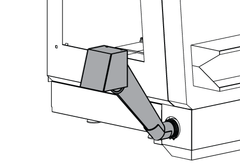

Put the o-ring [2] onto the chip chute [1].
Put the V-flange clamp [3] onto the chip chute. Make sure the nut on the clamp [4] points to the chip chute as shown.
6
Put the chip chute [1] onto the outlet tube on the enclosure pan.
Turn the clamp to put the nut at the bottom of the chip chute. Make sure the nut points to your left.
Use a ratchet extension [2] to tighten the nut.

This procedure will show you how to install the front and side chip chute option for VMC machines.
This procedure applies to the following kit:
  • 30-11605A: CHIP CHUTE V-FLANGE W/CVR VF-12/14
Installation
Press POWER OFF.
Set the main circuit breaker to the OFF position.
Lock the main circuit breaker. Use an approved lock with an approved safety tag.
Put the O-ring [2] onto to the chip chute [1].
Verify that the V-flange clamp [3] is on the chip chute. Make sure the nut on the clamp [4] points to the chip chute as shown.
Install the chip chute [1] provided in the kit onto the outlet tube on the enclosure pan.
Turn the clamp to put the nut at the bottom of the tall chip chute. Make sure the nut points to your left.
