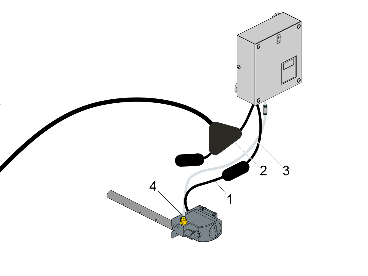

Components :
  1. Control box / ozone generator
  2. Submersible pump
  3. Power splitter for any other 120V devices

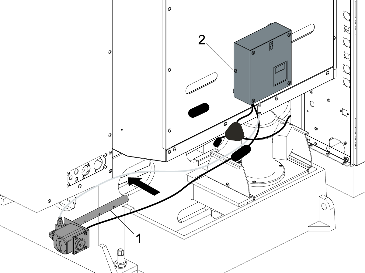

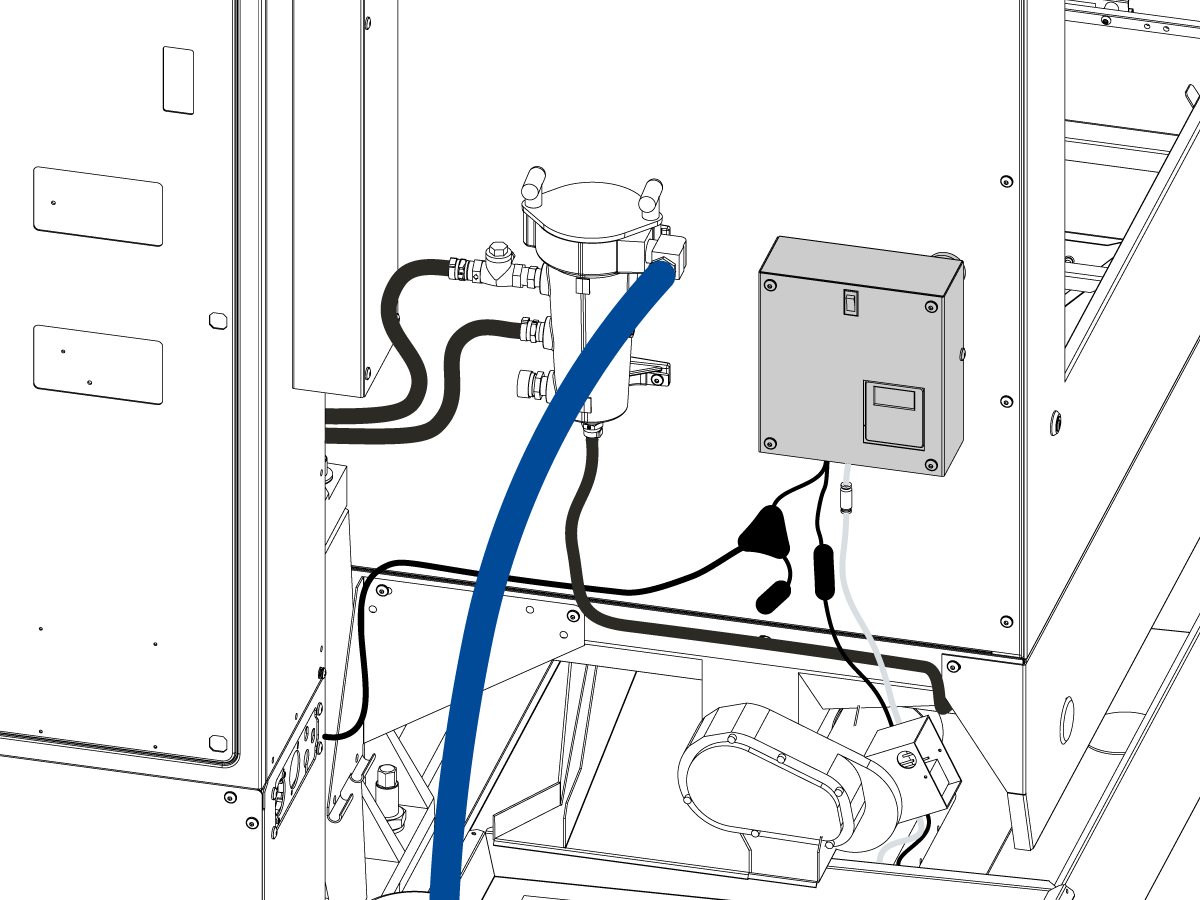

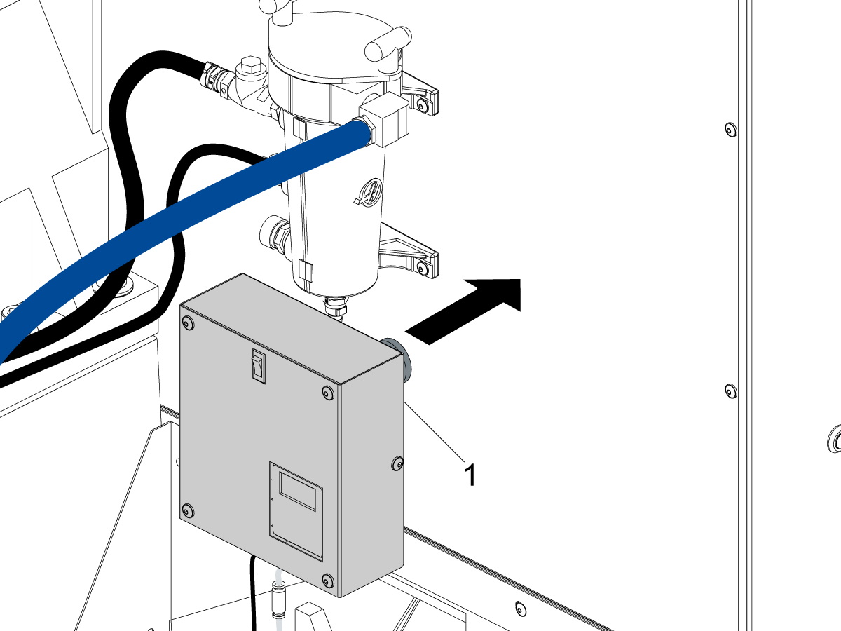

Attach the Coolant Sanitizer [1] onto sheet metal above the coolant tank using the integrated magnets.
Note: The location of the Coolant Sanitizer will vary between machine series.
Connect the pump's power cable [1] to the Coolant Sanitzer's plug [2].
Note : There is an extra outlet integrated into the wiring system [2] for other 120V devices.

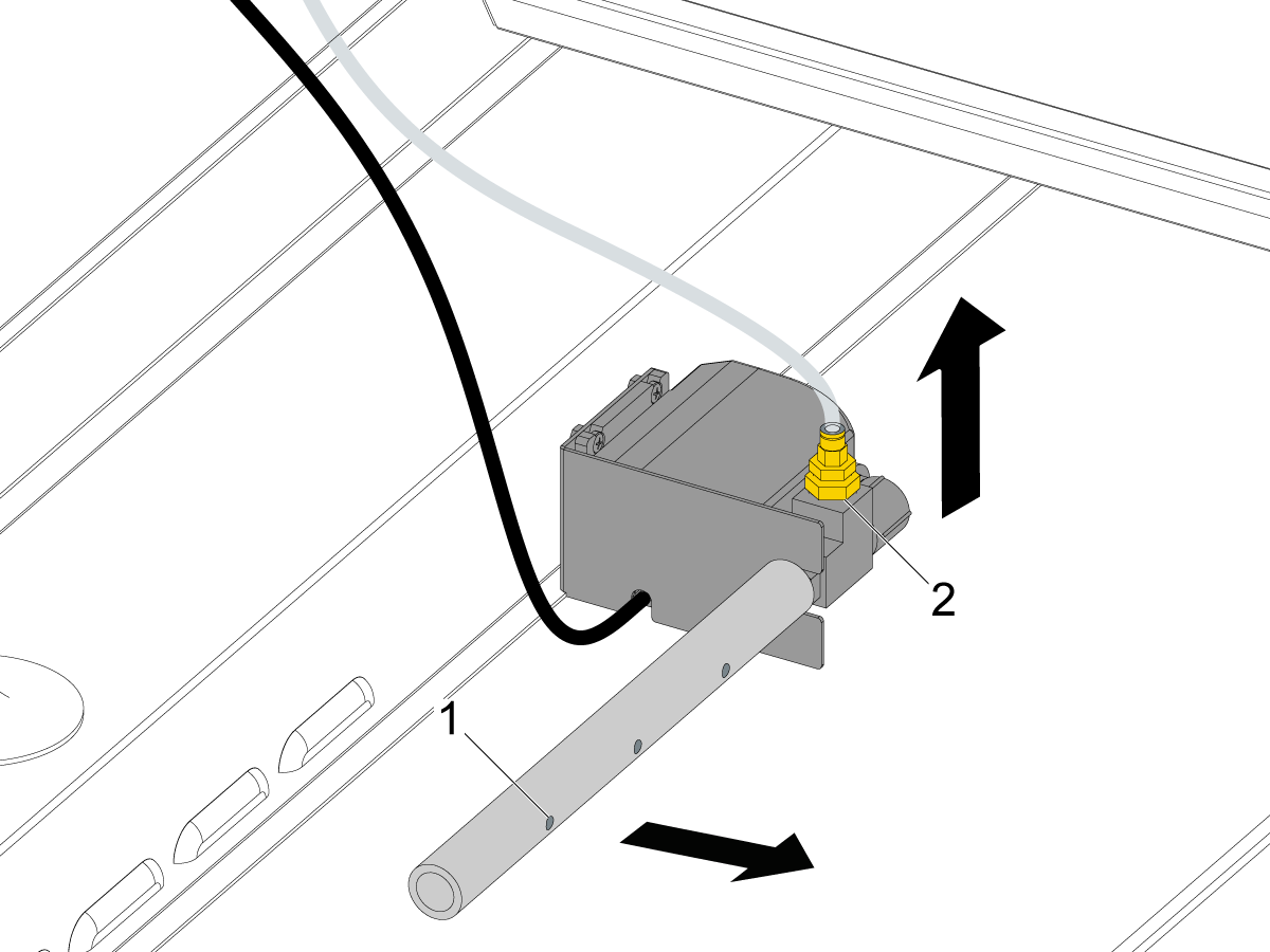

Connect the ozone tube [3] from the Coolant Sanitizer to the pump [4].
Place the pump at the bottom of the coolant tank near the chip tray using the installed magnets.
Important : Make sure that the ozone tube fitting [2] is facing up and that the ozone dispersing pipe [1] is facing away from the coolant pumps with the holes facing the sides.

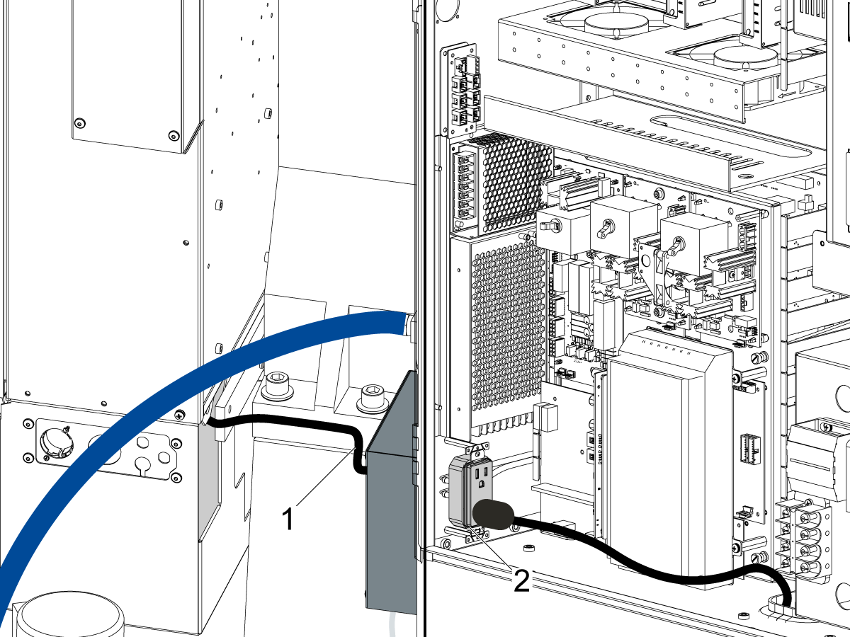

(Optional) Route the power plug [1]  into the control cabinet and plug it into one of the outlets [2].
Important : The Coolant Sanitizer is a 110-120 V system so we reccomend using the electrical cabinet as a power source if the standard power grid in your area provides a different voltage.

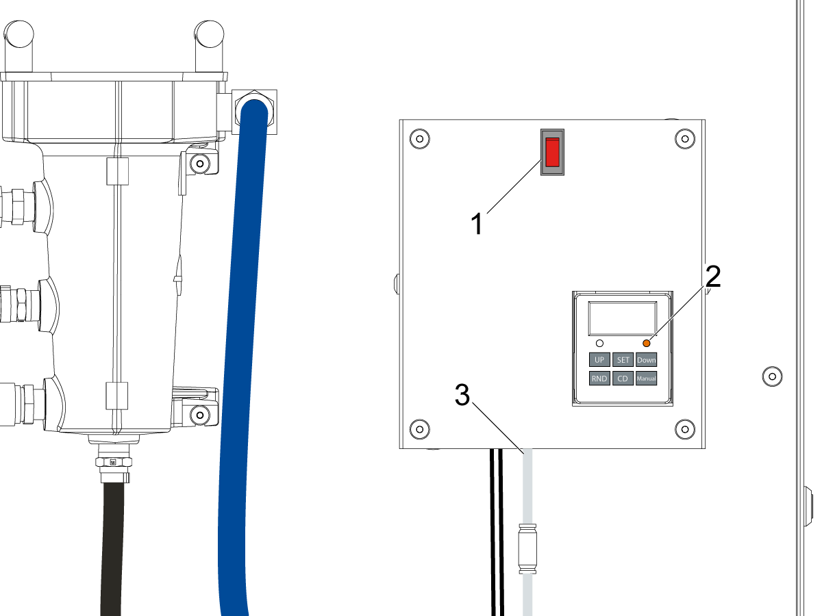

Turn the Coolant sanitizer on using the power on button [1].
Verify that the coolant is flowing out of the pump.
The “Pump On” Light [2] should light up when pump/ozone is in use.
Squeeze the ozone tube [3] shut by hand to check that the ozone generator is functioning properly. Slight pressure should be felt when tube is shut closed.
If the coolant is discolored, the pump should improve it after a few minutes.
