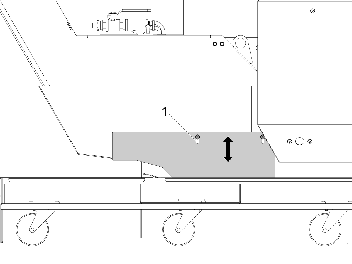

Mount the Adapter brackets onto the enclosure loosely with the conveyor in the machine. Insert the drain pan onto the ¼ bolts from the previous step.
Align the pan laterally with respect to the spill way. Tighten the upper bolts on both sides.
The edge of the drain pan must be aligned just below the spillway edge, indicated by the arrows, to allow for adequate chip flow but not below the end of the casting.
The lower flange of the drain pan should be in contact with the base’s spillway.

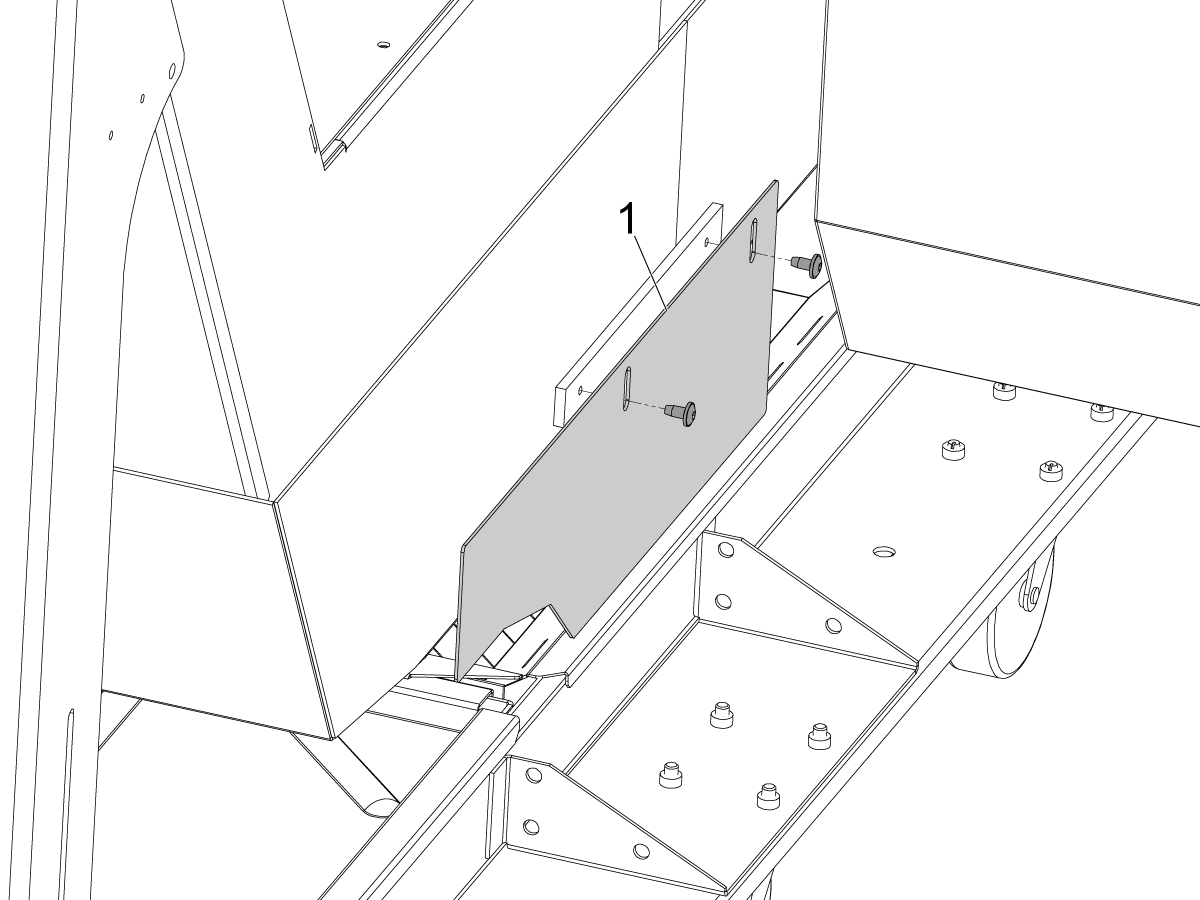

With the conveyor in the machine have someone push on the conveyor to create a gap between the conveyor and the casting.
Insert wing brackets [1] between the top of the conveyor and the casting. make sure the shoulder of the mating bracket is against the wing brackets.
With the brackets in place install self tapping screws at the TOP of the slots in the brackets. This will allow you to bring the brackets upward to meet the casting if necessary.
NOTE: Make sure the bracket is wedged between the casting and conveyor to create a seal so chips do not leak through the gaps.

8.8 UMC - CDF Conveyor Splash Guard Installation
UMC - CDF Conveyor Splash Guard - Installation
AD0890
Revision A 5/2025
This procedure will show you how to install a splash guard for your UMC with a CDF chip conveyor. This kit will keep coolant from splashing out of the side of the coolant tank.
Applicable service kits:
93-5071 - CHIP CONV SPLASH GUARD CDF SVC KIT
Installation
Remove the original guard from the CDF chip conveyor.
Use the original screws to mount the provided splash guard [1] onto the side of the conveyor.
Use the slots [1] in the splash guard to adjust the height of the splash guard if needed.
