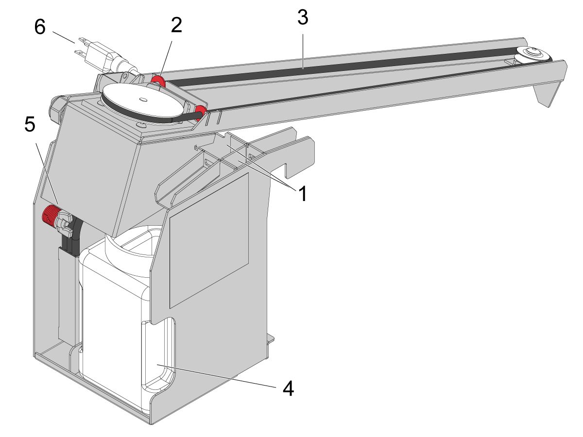

The image shows the following components of the Oil Skimmer system.
  1. Oil Skimmer Chamber (x2)
  2. Scraper (x2)
  3. O-ring
  4. Oil container
  5. Extra Scrapers and O-rings
  6. Power Cord with Switch
Symptom Table
Symptom Possible Cause Corrective Action
Pulley and O-ring do not rotate despite motor turning. Pulley set screw backed out from motor drive Shaft Orient the motor drive shaft so that the flat side is facing the set screw bore in the pulley. Then tighten the set screw so that it is pressed against the flat side of the drive shaft.
Oil does not dispense into bucket. The oil is too viscous. Clean the oil in the skimmer. If issue proceeds, clean the coolant tank. Refer to the Haas Oil Skimmer Maintenance procedure.
O-ring is damaged.  Check for chips wedged into the O-rings. Remove chips from the O-ring and the coolant tank. Replace O-ring. Refer to the Haas Oil Skimmer Maintenance procedure.
Both chambers are full of dirty oil.  Dump out the coolant oil mixture from the chamber. Clean thoroughly with water and refill with clean coolant. Refer to the Haas Oil Skimmer Maintenance procedure.
Oil drips onto the floor.  Inspect for holes or defects. Fill chamber with coolant and observe for a leak.
Improper set-up on edge of tank. Make sure there are no chips or obstructions on the bottom of the oil skimmer and on the edge of the coolant tank.
The motor is making excessive noise or behaving abnormally. The motor is damaged internally. Record a brief video clearly demonstrating the issue. Send the video with a brief description to your local HFO for further assistance.
Coolant drips onto the floor on ST-10/15/L machines and/or the oil skimmer sags on the bracket causing spillage. Coolant snout is missing the ST-10/15 Oil Skimmer Extender to prevent coolant drips and/or it needs the stiffer Oil Skimmer Bracket. Order 93-1001137 OIL SKIMMER MOUNT BRACKET ST-10/15/L and refer to the Oil Skimmer Installation ST-10/15/L steps.

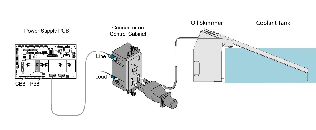

Electrical Fault
Make sure the connection is secure between the oil skimmer assembly cable [1] and the Ground-Fault Circuit-Interrupter [2] (GFCI). Some larger machines have an enclosure panel side-skirt connector [3] that the oil skimmer assembly cable [1] connects to.
Make sure the GFCI [2] has not been tripped. If it has, reset it.
Electrical Diagram

Apply the DECAL [C] to the enclosure apron.
Connect the 25 FT EXTENSION CABLE [B] to the GFCI outlet [1] on the control cabinet.
Use the CABLE TIES [D], the CLAMPS [E], and the MOUNTS [F] as necessary to route the cable.
Connect the power cable [2] for the Oil Skimmer to the female connector on the 25 FT EXTENSION CABLE [B] in the enclosure apron.
Push the toggle switch to start and stop the Oil Skimmer.
