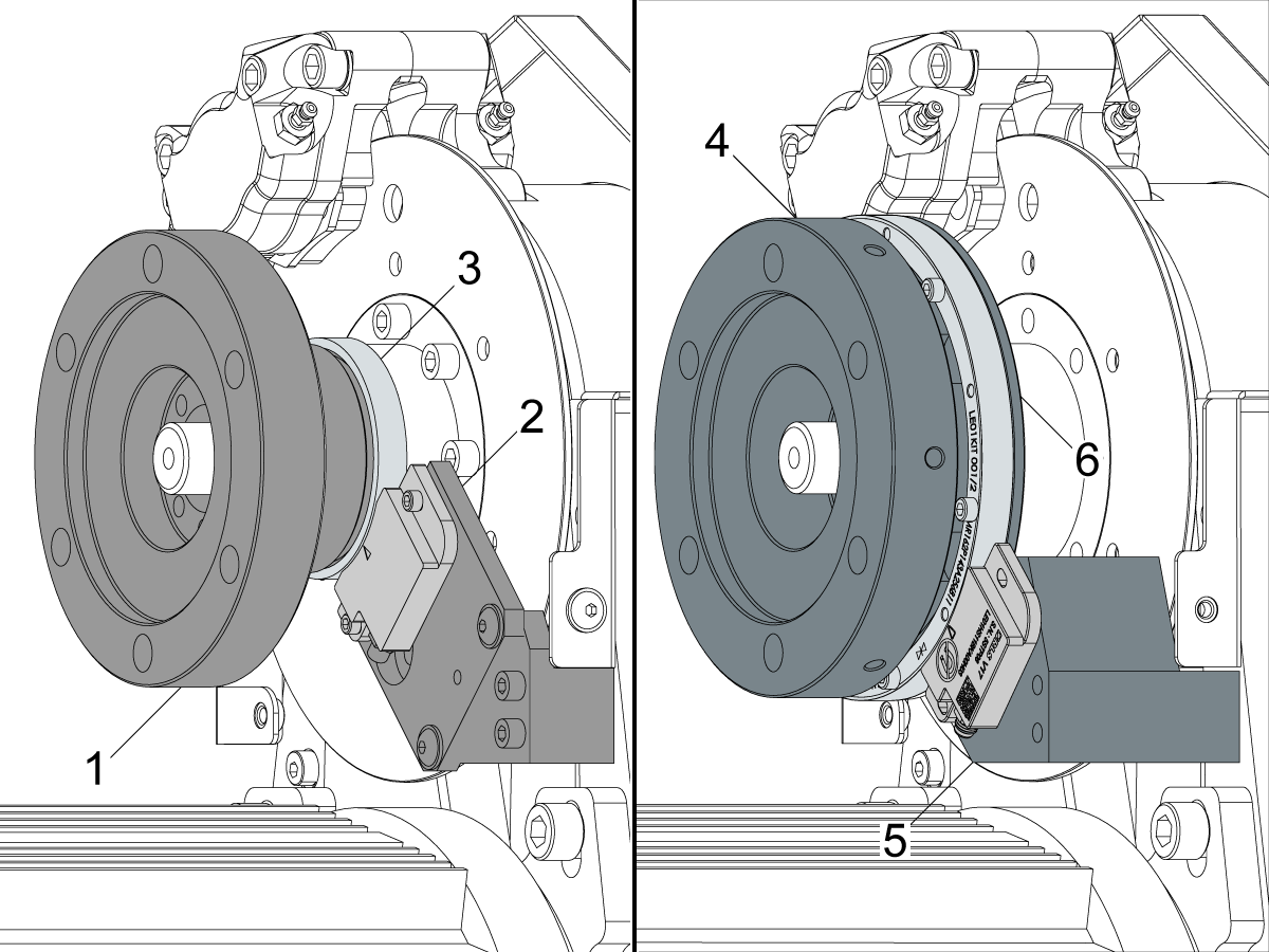

Encoder Comparison
The following parts are different :
  • Union adapters [1] and [4]
  • Encoder rings [3] and [6]
  • Encoder head brackets [2] and [5]

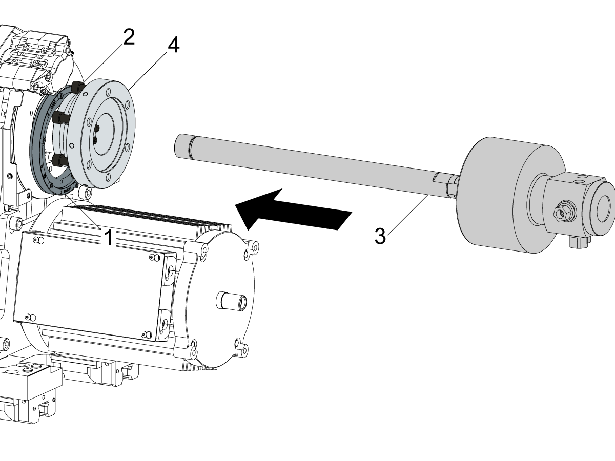

Remove the hydraulic union [1] from the adapter [2]. The drawbar [3] is attached to the hydraulic union.

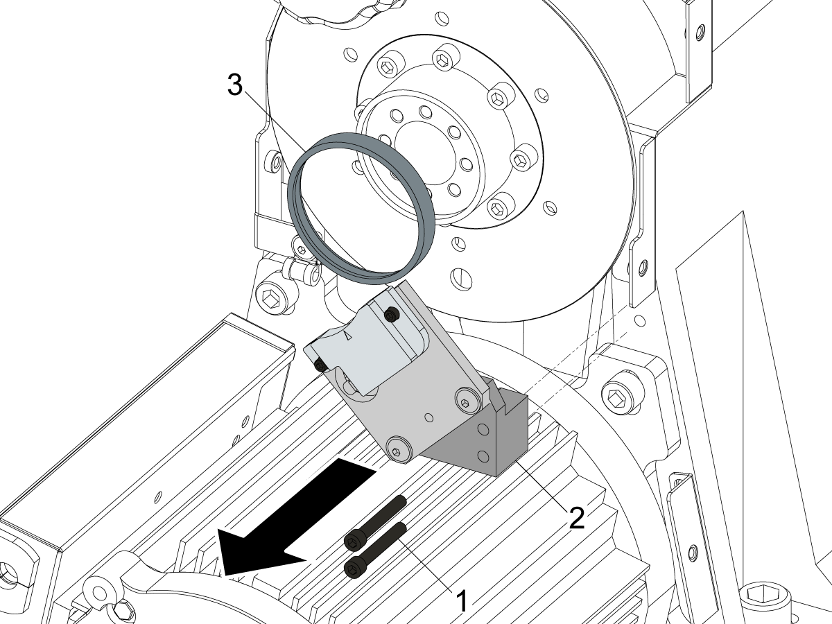

Remove ground wire and disconnect the encoder head cable.
Remove the hardware for the encoder head [1] along with the bracket [2].
Optional : Heat the encoder ring [3] and use a pulley puller to removed it.

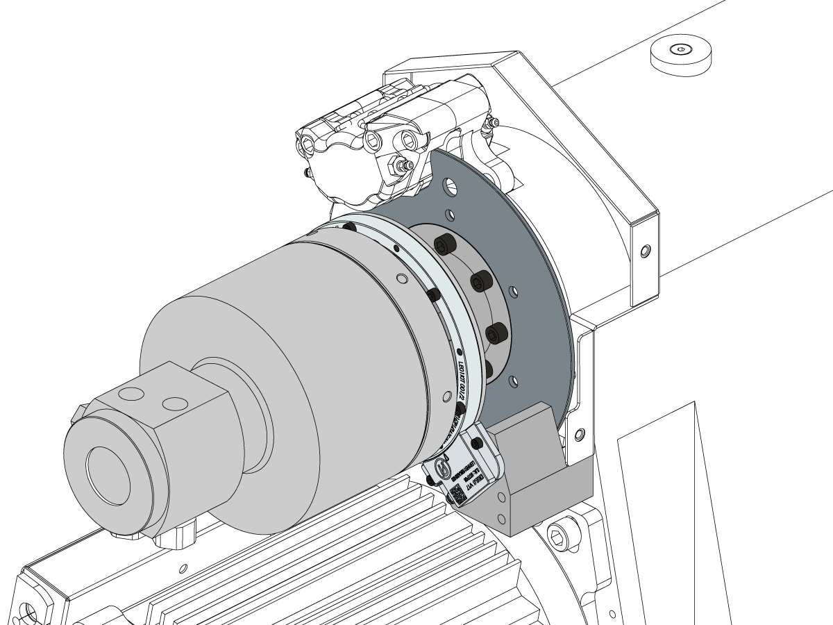

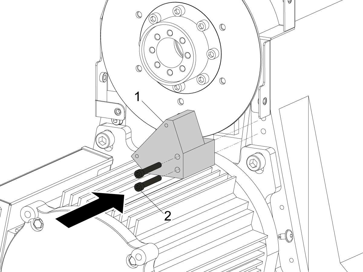

Install the new spindle encoder head bracket [1] using the provided hardware [2].
11
Slide on the encoder ring assembly [1] onto the spindle and install the union adapter using the provided hardware [3]. Ensure that the bolts are snug but not tight.
Important : Ensure that the encoder ring is facing the back of the sub-spindle.
Using a plastic mallet lightly tap union adapter to set the axial runout NTE .0005" (12.7 µm) TIR and radial runout NTE .0015"(38.1 µm) TIR
Torque the union adapter bolts.

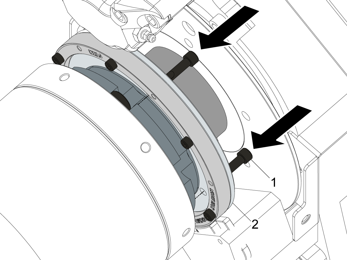

Leave the encoder ring [1] uninstalled on the union adapter [4].
Slide the hydraulic union bolts [2] through the union adapter then Reinstall the hydraulic union [3].
Note : The encoder ring is not installed to have access to the hydraulic union bolts.

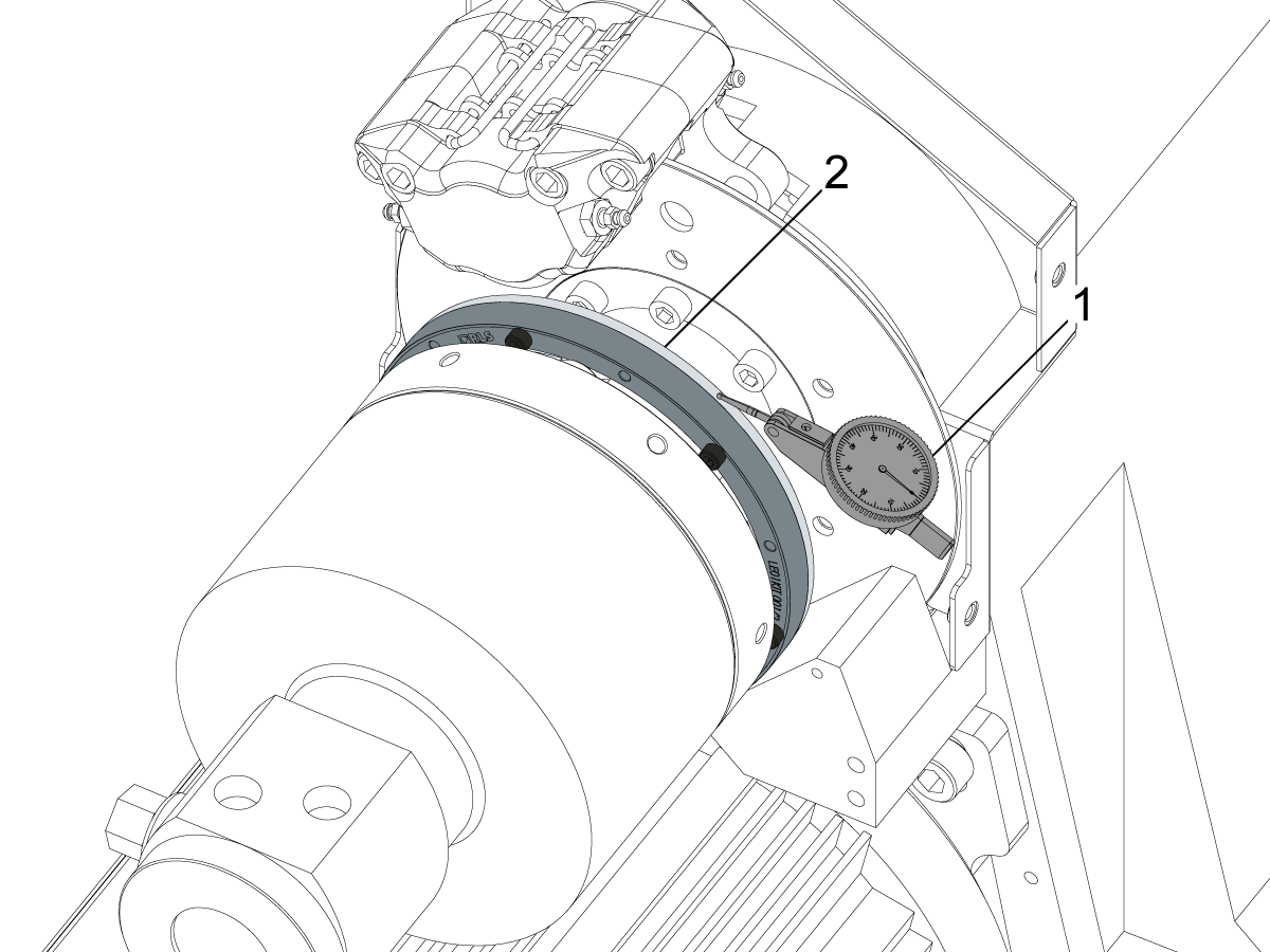

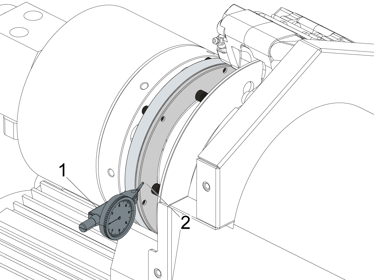

14
Check radial runout on the encoder ring bracket [2] using a dial indicator [1].
  • NTE 0.0005" (12.7 µm) TIR
Note : Ensure the high spot is indicated using a marker for encoder head installation.
15
Check axial runout on the back face of the encoder ring bracket [2] using a dial indicator [1].
  • NTE 0.005" (127 µm) TIR

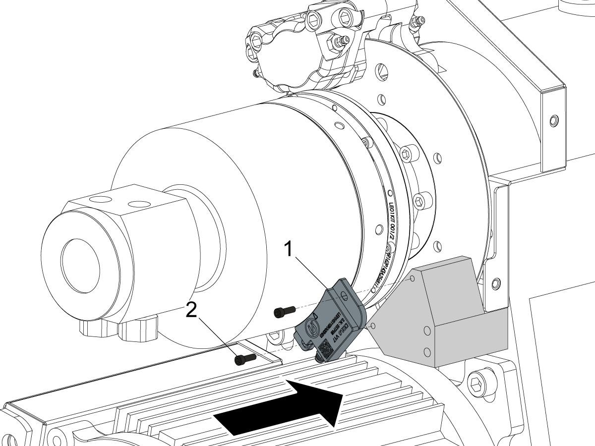

Install the encoder head [1] using the provided hardware [2].
Use the plastic shim provided with the NCE to set the gap between the read head and the NCE ring by pushing the read head evenly onto shim/ring at the marked high point.
Torque read head screw to 25 inch-Lbs once correct spacing is achieved. the shim should slightly drag as it is removed from the gap.
Install ground wire and connect the encoder head cable.
Warning : Ensure that the encoder head does not contact the ring.

Install the chuck adapter [1] by using the foot pedal in MDI mode to extend the sub-spindle draw bar the pressing [E-STOP] and applying thread lock all the way around the first 2 threads of the chuck adapter. Thread the chuck adapter onto the sub-spindle draw tube until the threads bottom out by hand. Apply CHUCK EEZ grease or any similar chuck grease to the outer threads of the chuck adapter before installing the chuck.
If equipped, install the Sub-Spindle parts ejector [1]. See the Lathe - Sub-Spindle Part Ejector procedure.
