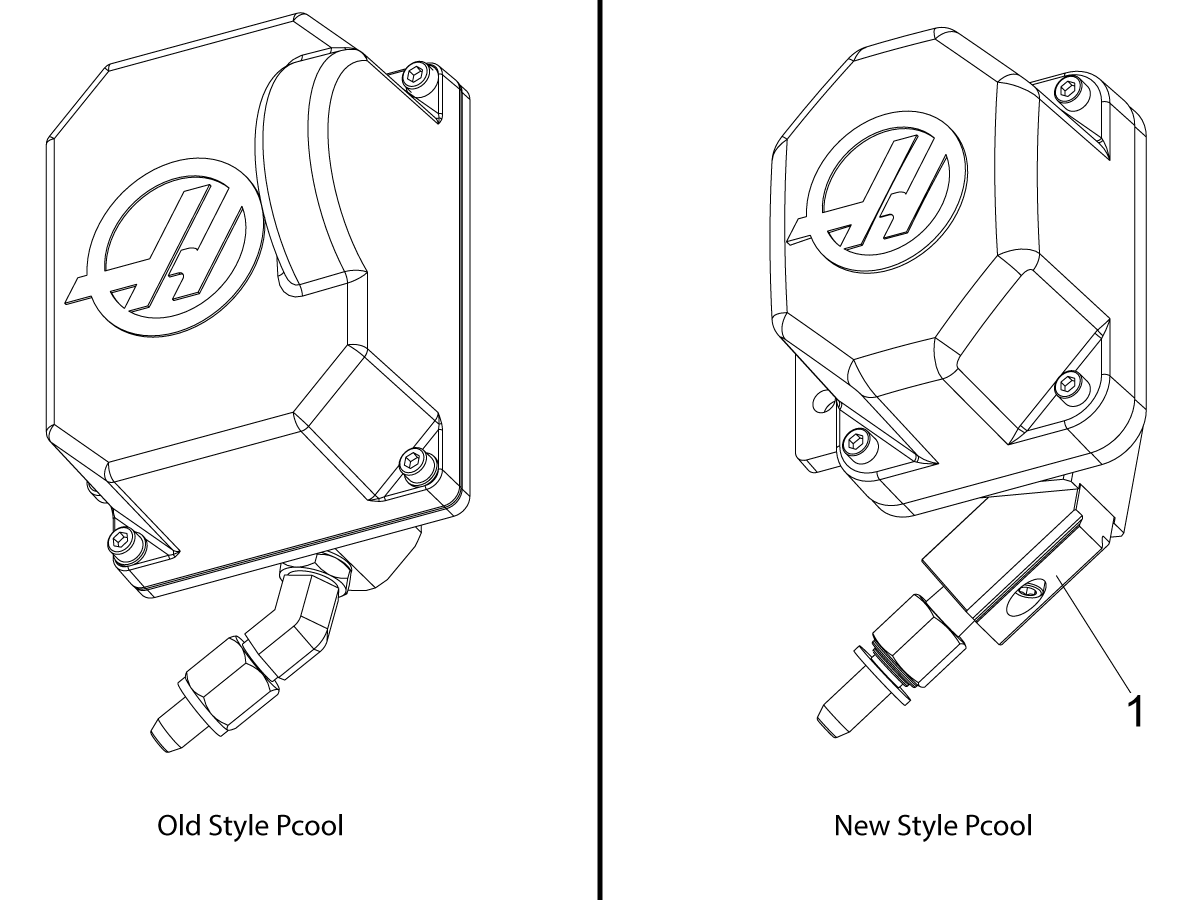

The machine must have the 2021 Pcool or newer. The dovetail [1] on the Pcool Nozzle is required to install the hole blaster. Older Pcools will not have the dovetail.
The machines with the older Pcool can be upgraded. The instructions for this can be found on AD0302.

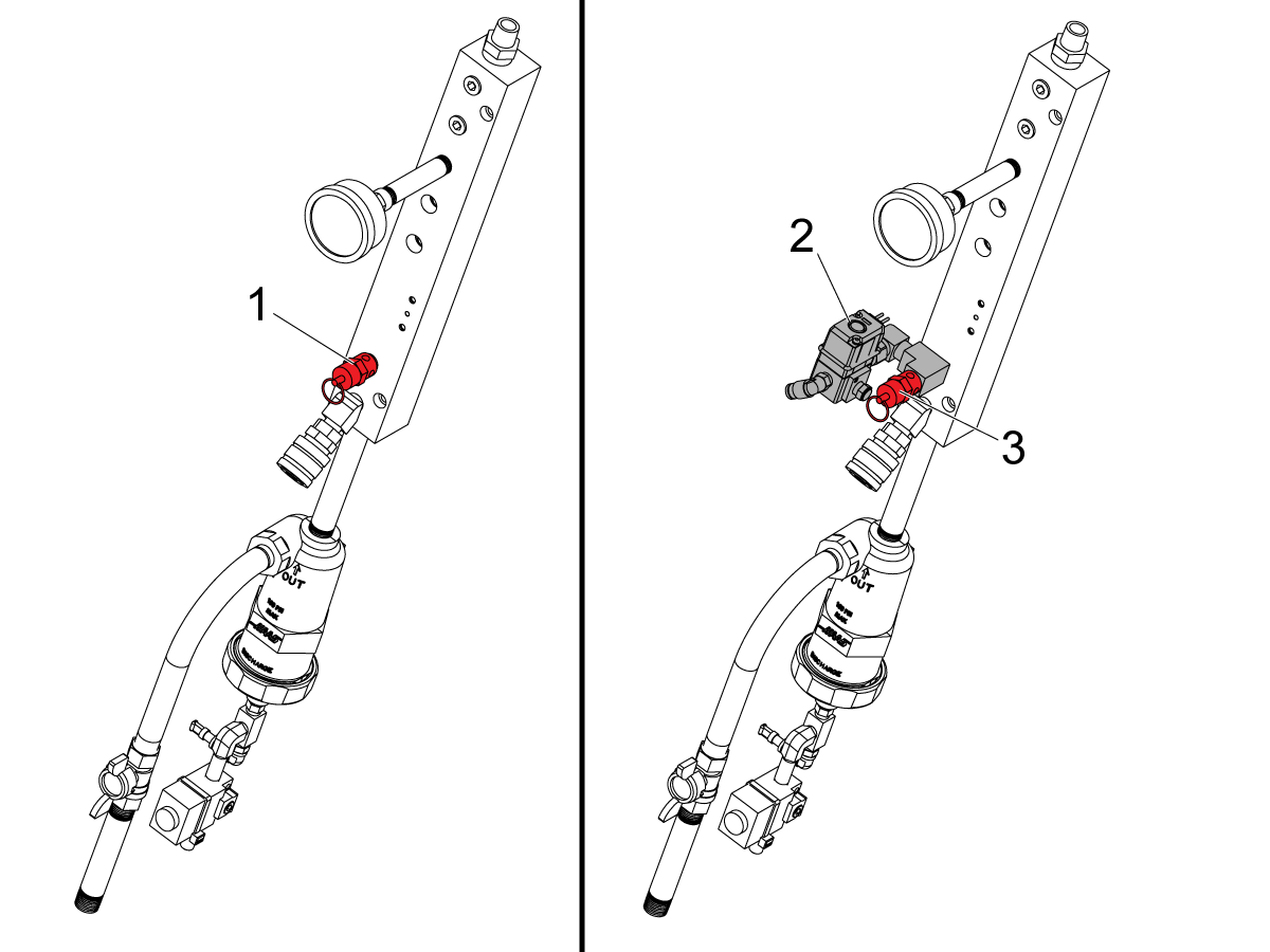

Open the air lube cabinet and close the valve [1] on the airline to the air manifold. Then, pull the pressure relief valve [2] to bleed air from the system.
Once all the air has been bled, remove the pressure relief valve [1] from the air manifold. Then install, the solenoid [2] the in the same place the relief valve was removed.
After the solenoid is installed, install the relief valve [3] on the back of the solenoid.

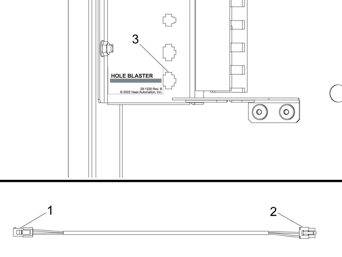

Plug cable (33-1159) into the IO board in port P33. The end with a three-pin connector [2] will go into the IO board. Route the cable into the air lube cabinet and mount and mount the end with two pins [1] into the cable bracket in the hole labeled for Hole blaster [3].
After the cable has been routed, plug in the solenoid.

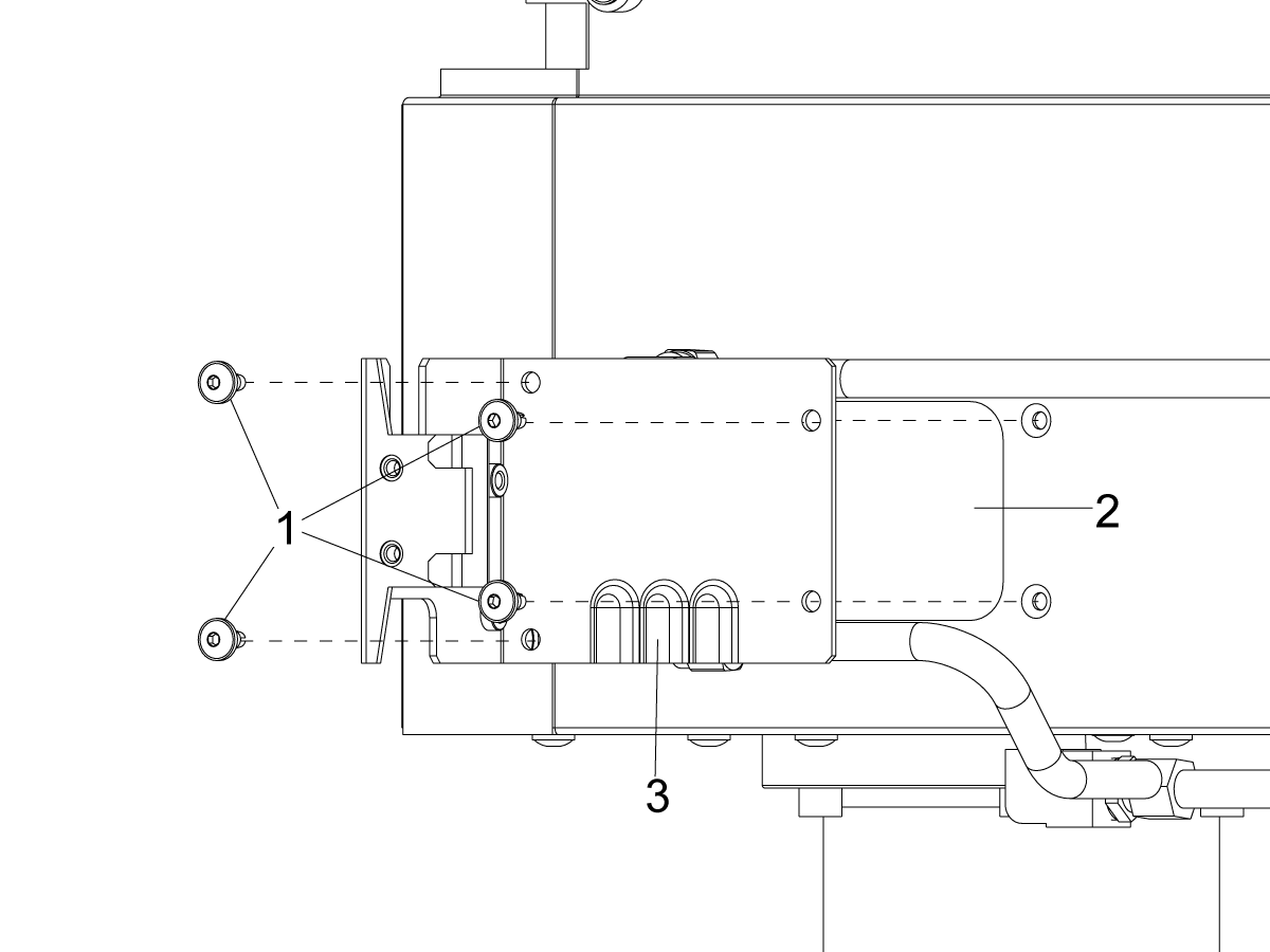

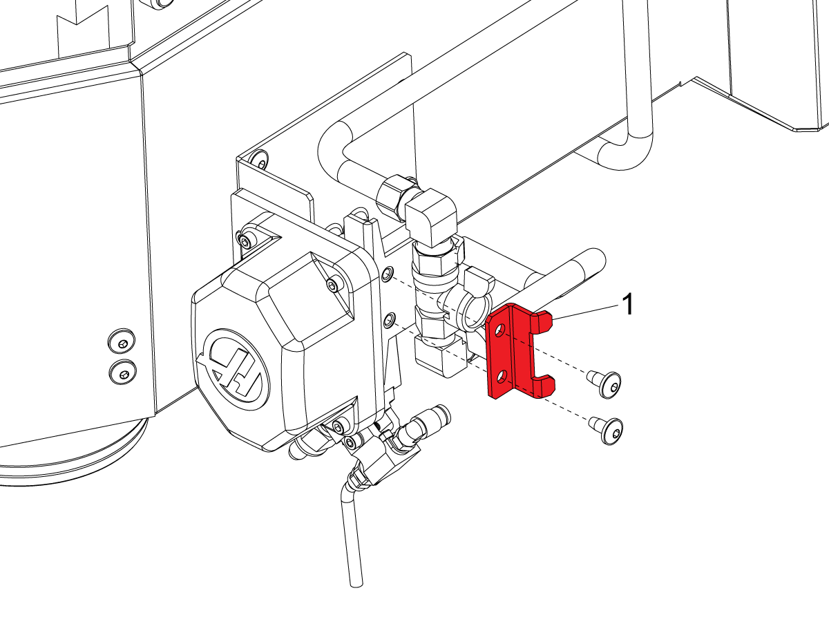

Remove the bracket around the coolant valve [1].
Undo the four screws [1] holding the P-COOL bracket to the machine and remove the bracket.
Behind the bracket is a hole for routing cables and tubes from outside the spindle head to inside [2]

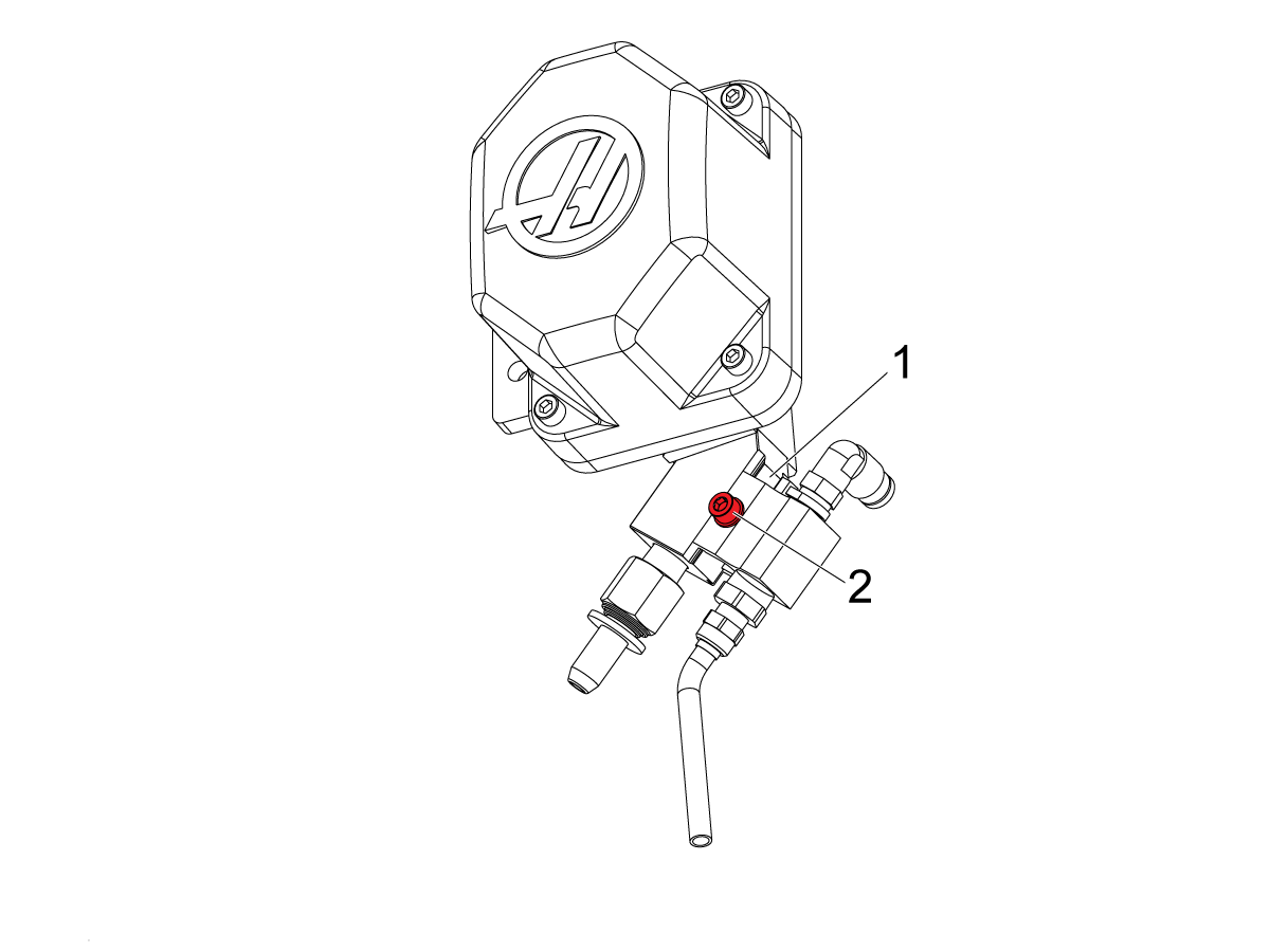

Slide the hole blaster onto the dovetail [1] on the P-COOL nozzle and tighten it down with the 5/32 screw. Connect the air hose to the hole blaster.
