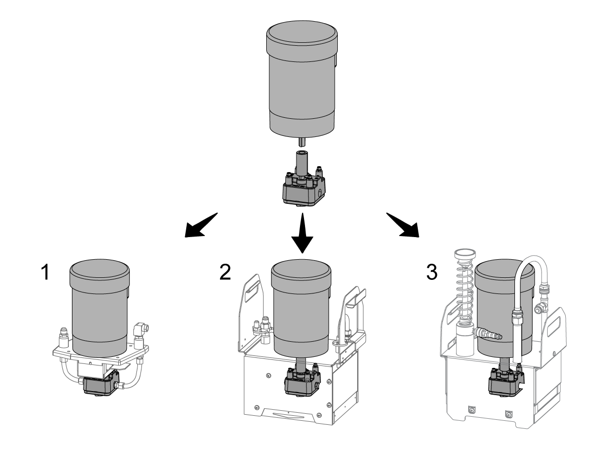

This illustration shows each coolant pump type that is in this procedure:
  • Lid-mounted HPC, TSC pump assembly [1]
  • HPC, TSC pump with stand assembly [2]
  • HPC, TSC Auto-Clean pump with stand assembly [3]

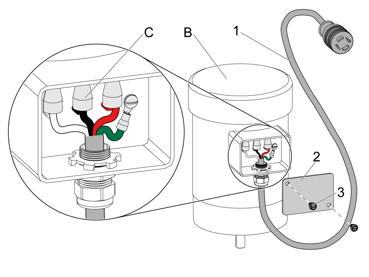

If you must replace the motor and the cable, or if the new cable is not compatible with the machine:
Remove the cable [1] from the old motor.
Remove the (2) screws [3] and cover [2] from the new HPC, TSC MOTOR [B].
Remove the cable from the new HPC, TSC MOTOR [B].
Install the cable [1] from the old motor to the new HPC, TSC MOTOR [B].
Connect the old cable to the motor. Use the (3) CRIMP WIRE NUTS [C]. Use crimp pliers and wire strippers to correctly connect the cable.
To replace a pump head or motor that is lid-mounted:
Remove these parts:
  • (4) socket head cap screws [2] and the motor [1]
  • If you only need to replace the motor [1], replace it now. If no other parts need to be replaced, the procedure is complete.
  • coupler [3] and (4) socket head cap screws [4]
  • (2) compression fittings [5] and pump head assembly [6]
  • (2) steel tube assemblies [7]
Refer to the "Pump Head Coupling Variations" section end of the document for procedure details on your particular pump/coupling/motor combination.
Note: Steel tube assemblies do not need to be removed if replacing the pump head coupling
To replace a pump head or motor that has a stand:
Remove these parts:
  • (4) button head cap screws [8] and the filter housing [9]

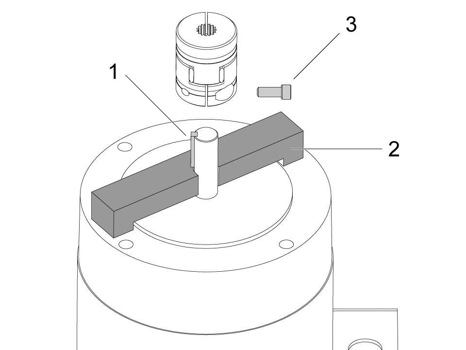

Note: This procedure requires T-0184: Gear Pump Coupler Spacer Tool
Install new gear coupling:
Turn motor so that surface with shaft is facing upward.
Tap new key into place on motor shaft [1].
Place spacer flush against motor. [2] Press new coupler onto motor shaft, with serrated hole facing away from motor.
Tighten set screw onto motor shaft and torque to 80 in lbs (9 Nm). [3]
Place lid or pump mount stand on top of motor.
Bolt pump mount plate onto pump head assembly  [1]
Place new spacers and pump mount assembly on top of new coupler. [2]
Use new screws and nuts to secture pump mount plate to spacers [3]
Tighten set screw onto pump shaft and torque to in lbs (9 Nm).
Reassemble any further hardware and parts in the opposite order that they were removed. See steps above for more information.

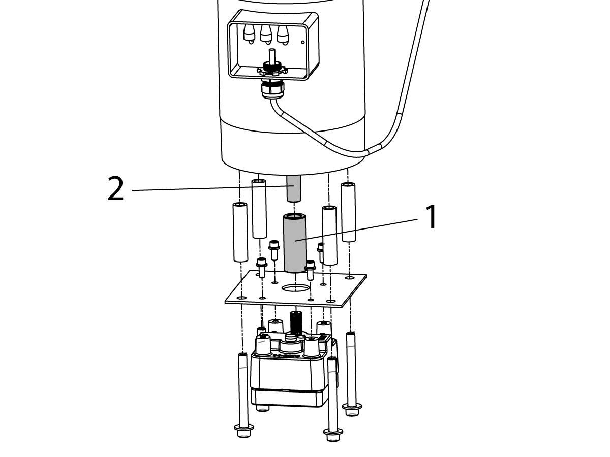

This section to be used with kit 93-1525B (TSC/HPC 300) OR 93-2589B (TSC/HPC 1K)
 NOTE: If your existing pump has the coupling pressed onto the pump head shaft, you must also order kit 93-2914A to convert your pump assembly to the current style.
 NOTE: If your existing pump has a floating coupling with a keyway on one side and a spline on the other side, you must also order 20-7846B to convert your pump assembly to the current style.

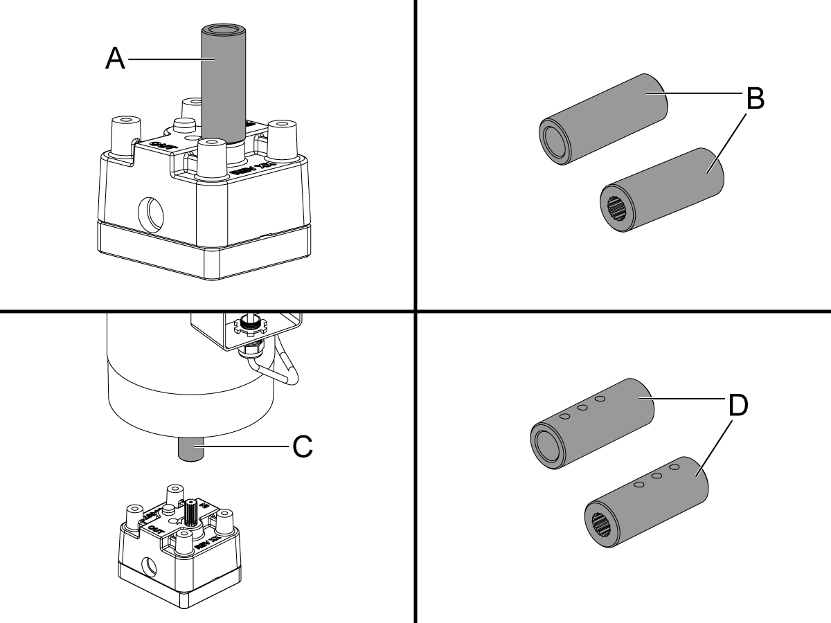

When the pump head is removed from the pump assembly, examine it to see which style coupling it has:
A)      Coupling pressed onto the pump head shaft
B)      Slip fit coupling with spline on pump head side and key on motor side
C)       Coupling sweat-fit onto motor shaft
D)       Set screw spline coupling
Coupling Pressed Onto the Pump Head Shaft
  • Discard the old spacers, screws, washers, and mounting plate. These will all be replaced with parts from kit 93-2914. Use the new screws, washers, spacers, and mount plate to install the replacement pump head into the assembly.
  • Remove the motor from the pump assembly and clean the shaft with a rag. Use scotchbrite and/or lightly stone to remove any burrs or dings on the shaft.
  • Heat must be applied to replacement coupling from kit 93-2914 [1] to fit on the motor shaft [2]. Due to the possibility of variation in motor shaft sizes, it is necessary to get the coupler extremely hot to avoid it sticking on the motor shaft before it is fully seated.
  • Using a timer, set the non-splined end of the coupling on a hot plate set to 1000F for 30 minutes.
  • Do not use a motor spacer when installing the coupling. The motor shaft will bottom out inside the coupling when it is fully seated.
  • Apply red grease onto the pump head splines and reassemble the pump assembly.
Slip Fit Coupling with Spline on Pump End and Key on Motor End
  • Discard the old slip-fit coupling and motor shaft key. Remove the motor from the pump assembly and clean the shaft with a rag. Use scotchbrite and/or lightly stone to remove any burrs or dings on the shaft.
  • Heat must be applied to replacement coupling from kit 93-2914 [1] to fit on the motor shaft [2]. Due to the possibility of variation in motor shaft sizes, it is necessary to get the coupler extemely hot to avoid it sticking on the motor shaft before it is fully seated.
  • Apply red grease onto the pump head splines and reassemble the pump assembly using the replacement pump head and original hardware.

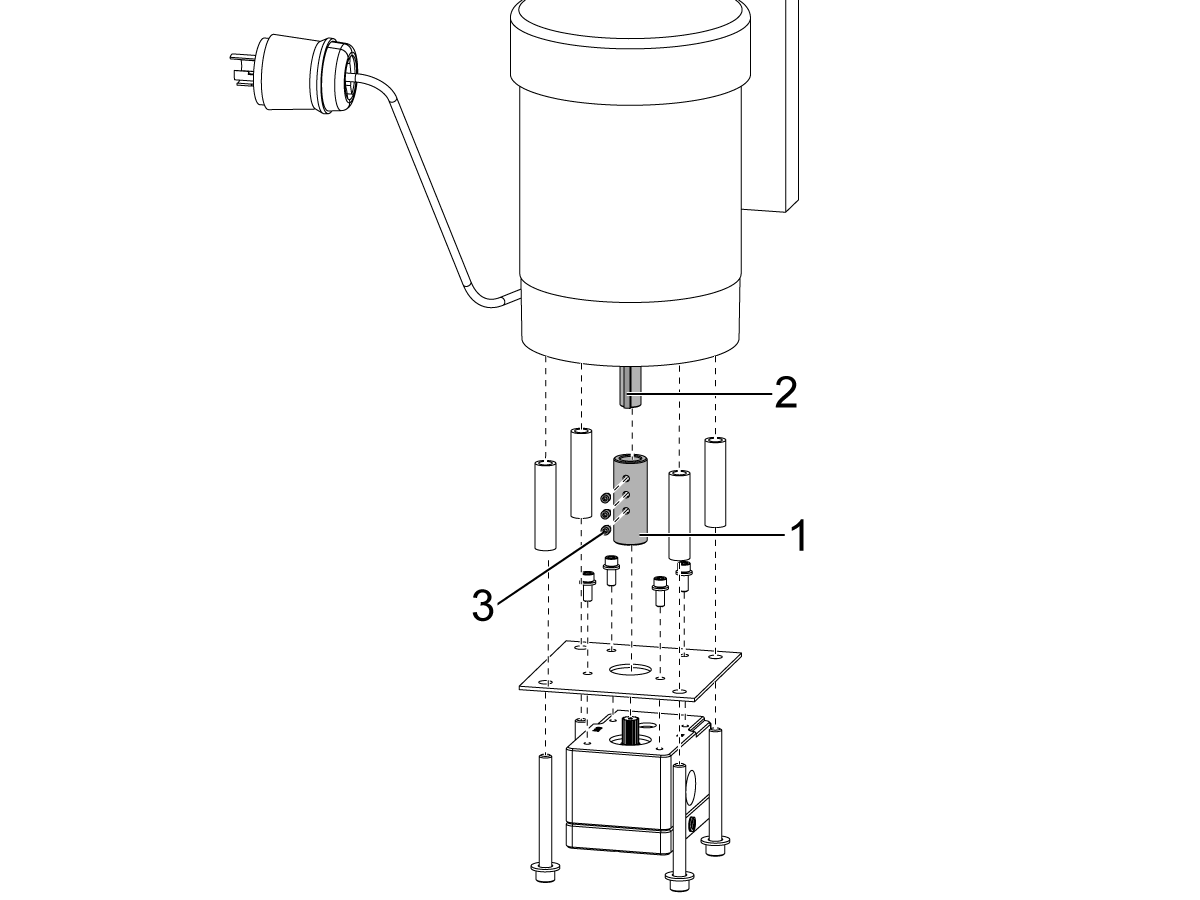

Set Screw Spline Coupling
  • Discard the old spacers, screws, washers, and mounting plate. These will all be replaced with parts from kit 93-2914A. Use the new screws, washers, spacers, and mount plate to install the replacement pump head into the assembly.
  • Use the coupling [1] from the 93-2914A kit, slide it onto the shaft with the threaded holes lined up to the key way [2] on the shaft.
  • Thread the set screws (44-0078)[3] in until they sit on the bottom face of the key way.
  • Apply red grease to the pump head shaft splines and reassemble the pump assembly.
