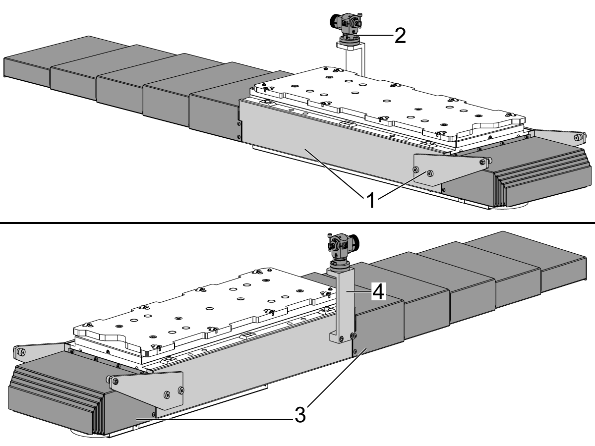

Remove the front and back sheet metal and bridge supports [1].
Remove the probe [2] and probe mount [4].
Pull back the waycovers [3].

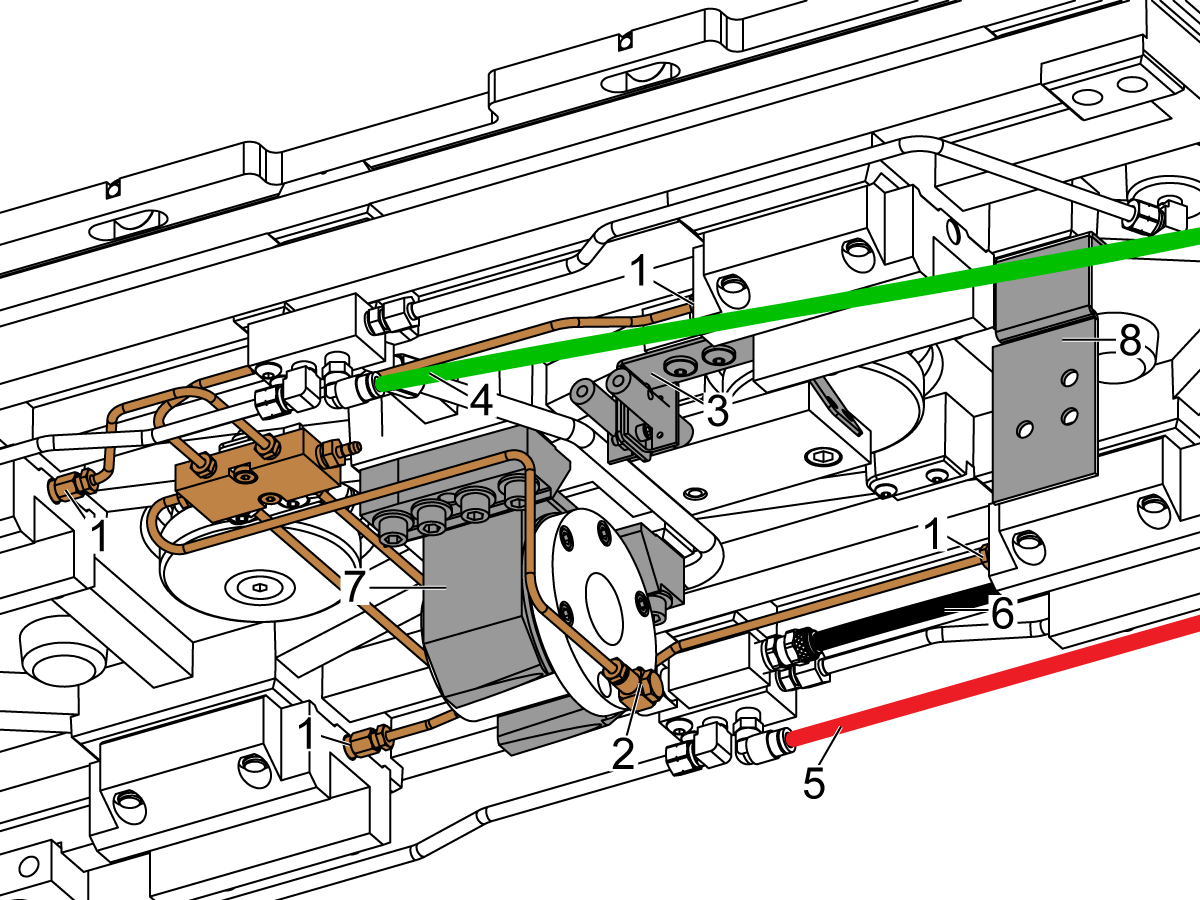

Disconnect the lube lines from the linear trucks [1] and the ballnut [2].
The clamp/unclamp switches and their bracket [3] will need to be removed form the receiver as well.
Disconnect the clamp [5] and unclamp [4] air hoses and the air blast hose [6].
Note: Take note of which hose was connected where for when re-installing on the new receiver later.
Remove the bolts holding the ballnut housing [7] to the ballnut, the ballnut housing will be removed with the receiver to aid in re-installing the new receiver later.
Remove the hardware holding the cable carrier bracket [8].
 Important: Keep track of all hardware removed as it will be re-used to install the new receiver.

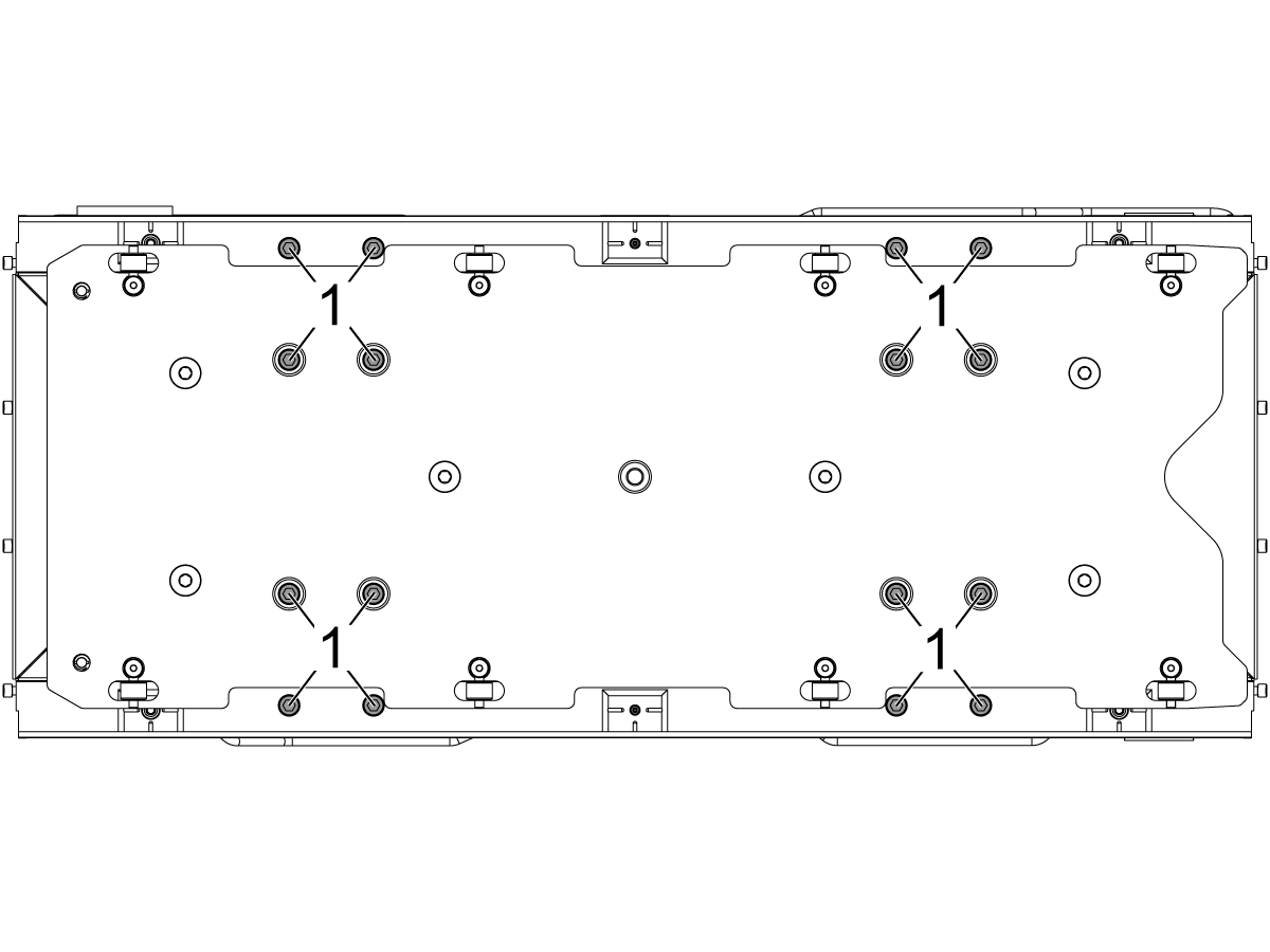

Remove the outer plugs [1] and remove the inner plugs [2].
Underneath the inner plugs [2] there will be smaller plugs like the outer ones [1] that were just removed, remove those at well.
Remove the plug from the middle [3] of the receiver.
Remove the linear trucks bolts [4].

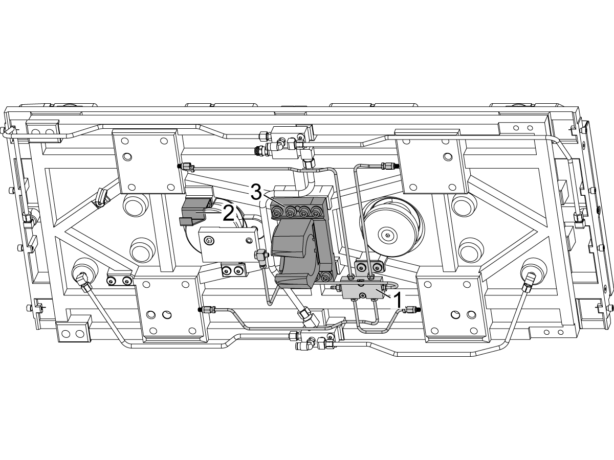

The following parts will need to be removed from the old receiver and reinstalled on the new receiver:
  • Copper lube line assembly [1]
  • The X-axis home switch trip flag [2]
  • Ballnut housing [3]

Install (16) small plugs [1] above the linear trucks bolts.
Then plug the (9) through holes in the clamp plate with the larger plugs [2]
