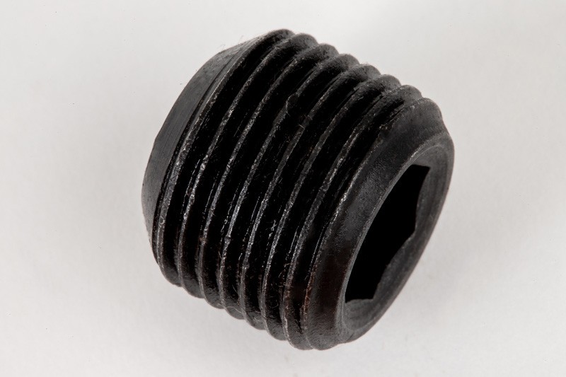

3/4-16UNFx5/8 Weldon Set Screw - Pack of 5
Part #: 06-0425
RETAIL PRICE:
$19.97
