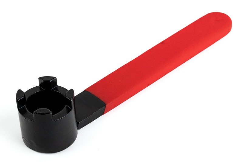

40mm Shell Mill Holder Spanner Wrench, HSEMC40
Part #: 06-0452
RETAIL PRICE: $40.95 $923.95 $274.95 $36.95 $166.95 $387.95
$22.97
649.97
193.97
25.97
116.97
272.97
