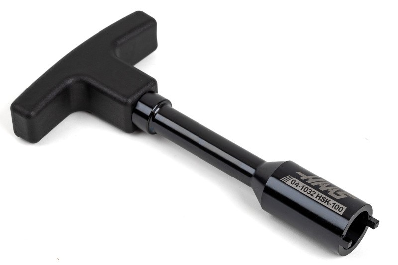

HSK100A ER16 Collet Chuck x 100mm Gage Length, TSC
Part #: 04-1014
HSK100A-ER16-100
Price: $239.95 ( / unit)
$131.97
Taper HSK100A
Collet Series ER-16
[ØBD] Body Diameter 28.0 mm
[GL] Gage Length 100.0 mm
[BL] Body Length 71.0 mm
Concentricity 0.003 mm
Balanced to RPM 25,000
Through Tool Coolant Yes
Spindle Drive Slots Yes
Weight 5.3 lbs \ 2.4 kg
