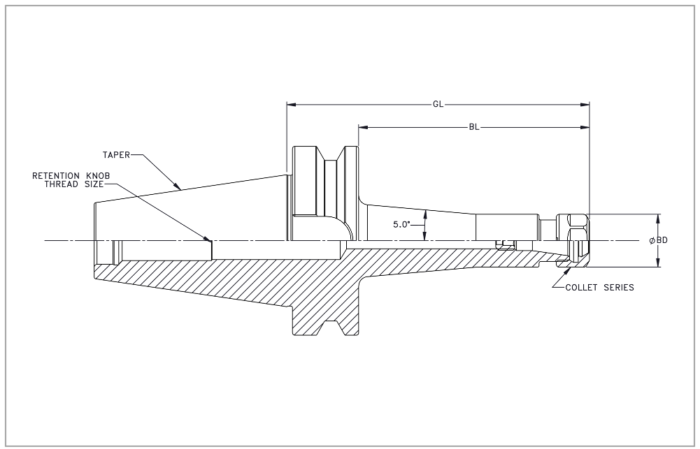

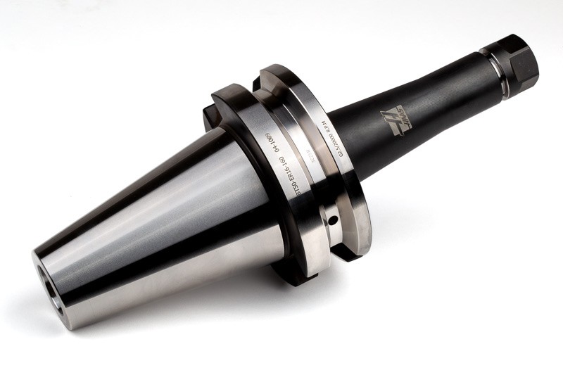

This BT50 ER16 collet chuck accepts a variety of ER16 collet styles, and has a 160mm gage length. The double-taper collet design provides high clamping force for round, smooth shank tools, and offers a wide gripping range with excellent TIR and balance. It is through-tool coolant (TSC) capable, with a M24x3.0 pull stud/retention knob thread.
Taper BT50
Collet Series ER-16
[ØBD] Body Diameter 28.0 mm
[GL] Gage Length 160.0 mm
[BL] Body Length 122.0 mm
Concentricity 0.003 mm
Balanced to RPM 20000
Retention Knob Thread Size M24X3.0
Through Tool Coolant Yes
Spindle Drive Slots Yes
Weight 9.5 lbs \ 4.3 kg
