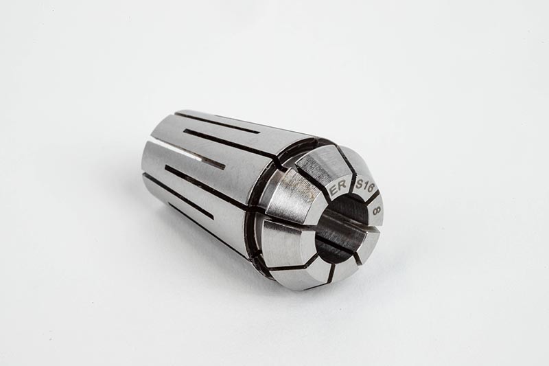

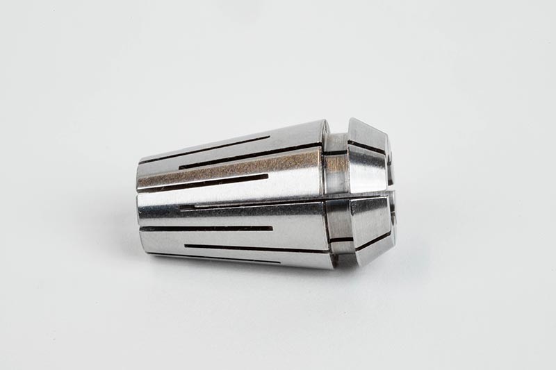

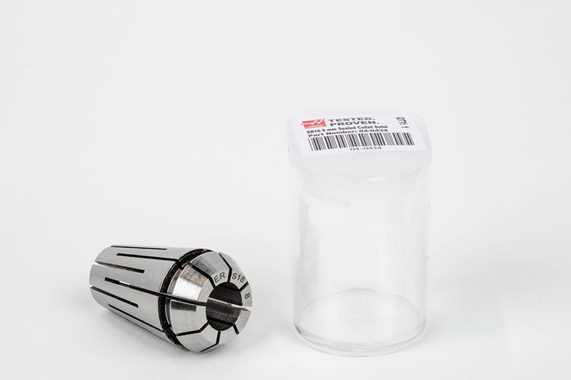

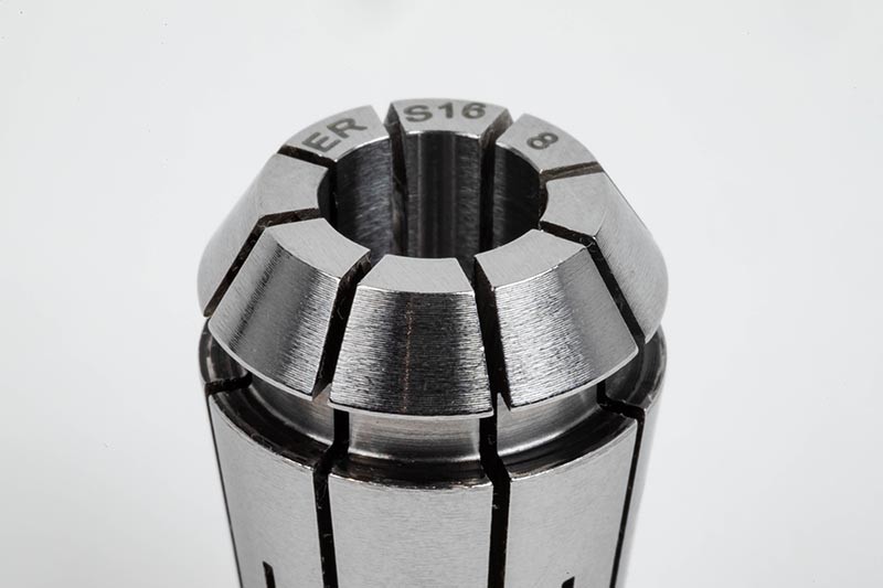

This 8mm ER16 straight-bore sealed collet for 8mm round shank tools ensures that 100% of through-tool coolant (TSC) gets to the tip of the cutting tool. It has a 0.01mm TIR, and is defined by collet class 1, per DIN ISO 15488. This collet has no clamping range; the tool shank must be the exact diameter of the collet bore.
Collet Series ER-16
Collet Class Class 1
Type Straight Bore Sealed
[ØD] Bore Diameter 8.0 mm
[MIN] Minimum Length 23.5 mm
Total Indicator Runout (TIR) 0.01 mm

Grind looks good, less than 2 tenths runout on a long carbide drill. Hard to say how much was the tool and the holder vs this collet but it's certainly good enough for a drill. Seals up really well too.
Jaukb Jaskowski
Feb 21 2023
What is the runout on these.
1 Answers
Haas Tooling
Feb 21 2023
Hi Jaukb, Our Sealed ER Collets have 0.005 mm or 0.0002" of runout. Thank you, Haas Tooling
