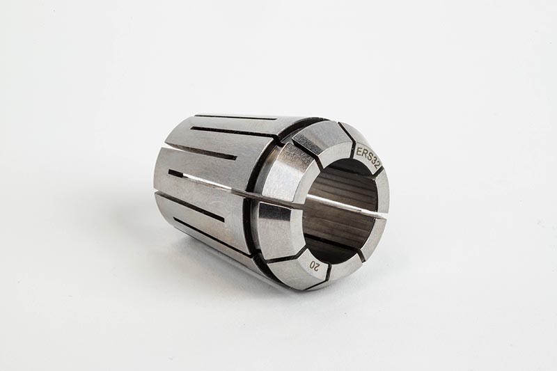

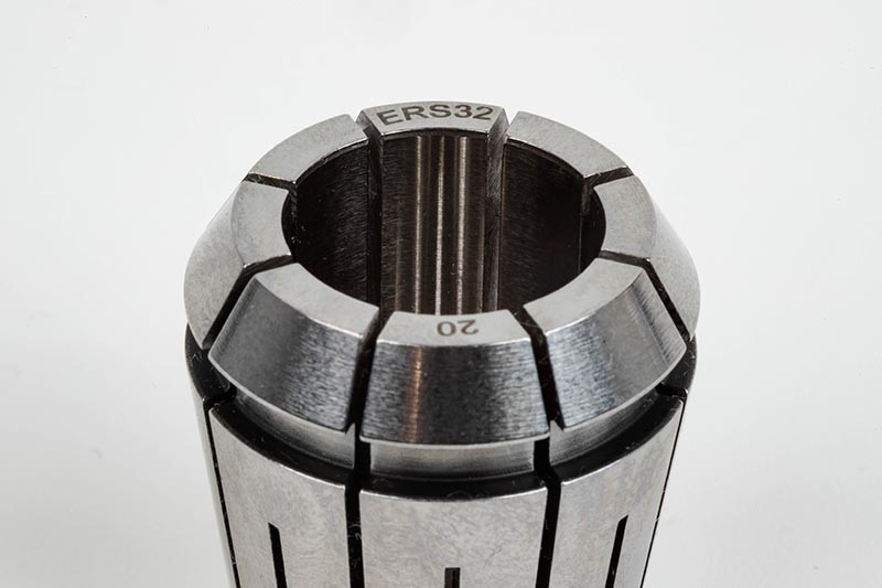

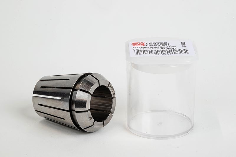

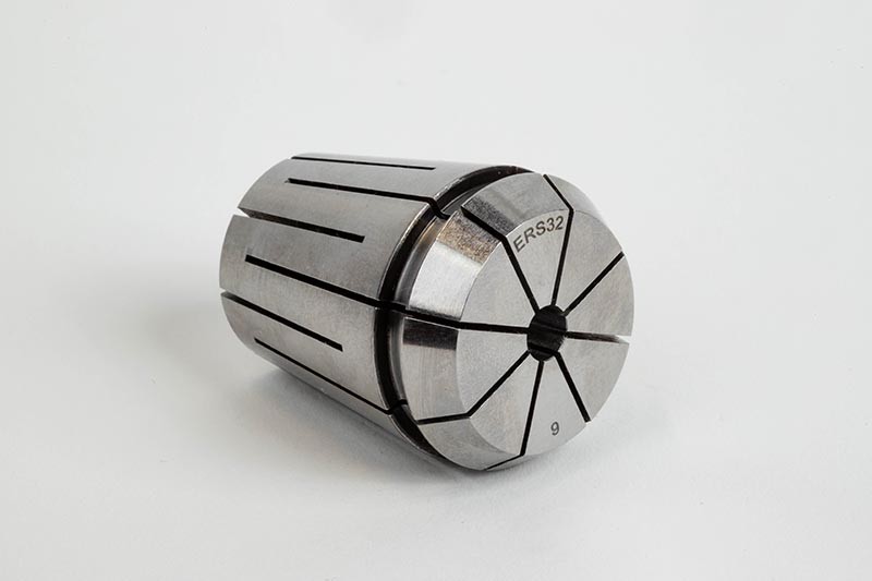

This 20mm ER32 straight-bore sealed collet for 20mm round shank tools ensures that 100% of through-tool coolant (TSC) gets to the tip of the cutting tool. It has a 0.01mm TIR, and is defined by collet class 1, per DIN ISO 15488. This collet has no clamping range; the tool shank must be the exact diameter of the collet bore.
Collet Series ER-32
Collet Class Class 1
Type Straight Bore Sealed
[ØD] Bore Diameter 20.0 mm
[MIN] Minimum Length 35.0 mm
Total Indicator Runout (TIR) 0.01 mm
Weight 0.2 lbs \ 0.1 kg
