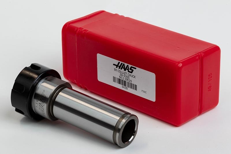

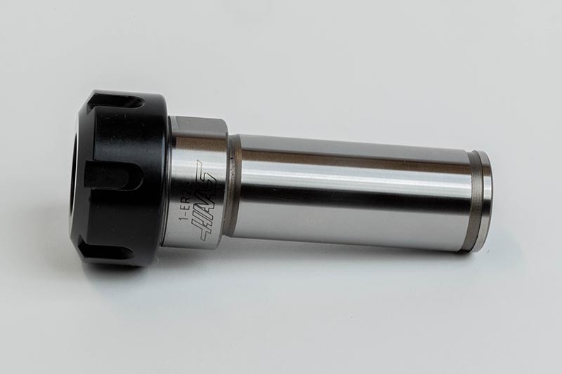

ER25 1" Straight Shank Collet Chuck, TSC
Part #: 04-0355
ST SHANK COLLET CHUCK 1" X ER25
Price: 80.95 ( / unit)
48.97
This straight shank ER25 collet chuck accepts a variety of ER25 collet styles, and has a 1.0 in \ 1" shank. The precision cylindrical shank has one flat, and will mount into any internal (ID) turning holder with the appropriate bore size and set-screw clamping. The double-taper collet design provides high clamping force for round, smooth shank tools, and offers a wide gripping range with excellent TIR and balance. The collet chuck is through-tool coolant (TSC) capable, and also may be used as an extended-length milling collet, by clamping it into the appropriate end mill holder.
Collet Series ER-25
[ØBD] Body Diameter 1.65 in
[ØDMM] Shank Diameter 1.0 in \ 1"
[LS] Shank Length 2.56 in
[LSCX] Maximum Clamping Length 3.74 in
[OAL] Overall Length 4.13 in
[FS] Flat Size 1.181 in
[TP1] Thread M16x2.0
Through Tool Coolant Yes
Weight 1.2 lbs \ 0.6 kg
