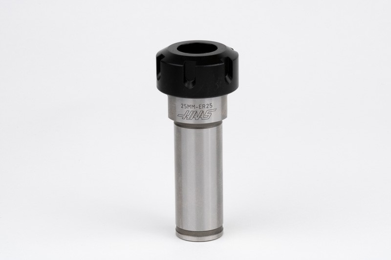

This straight shank ER25 collet chuck accepts a variety of ER25 collet styles, and has a 25mm shank. The precision cylindrical shank has one flat, and will mount into any internal (ID) turning holder with the appropriate bore size and set-screw clamping. The double-taper collet design provides high clamping force for round, smooth shank tools, and offers a wide gripping range with excellent TIR and balance. The collet chuck is through-tool coolant (TSC) capable, and also may be used as an extended-length milling collet, by clamping it into the appropriate end mill holder.
Collet Series ER-25
[ØBD] Body Diameter 42.0 mm
[ØDMM] Shank Diameter 25.0 mm
[LS] Shank Length 65.0 mm
[LSCX] Maximum Clamping Length 95.0 mm
[OAL] Overall Length 105.0 mm
[FS] Flat Size 30.0 mm
[TP1] Thread M16x2.0
Through Tool Coolant Yes
Weight 1.2 lbs \ 0.6 kg
