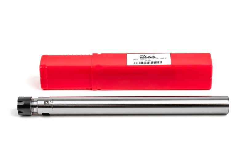

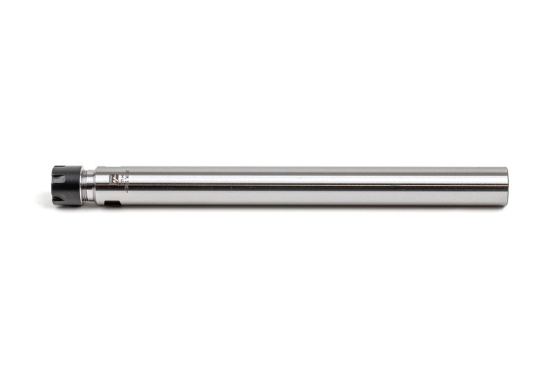

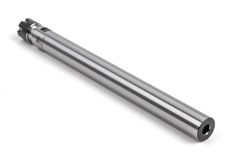

ER11M 5/8" Straight Shank Extended Collet Chuck x 6.5" Shank Length, TSC
Part #: 04-1225
COLLET EXTENSION, ER11M, 5/8x6.5"
Price: 57.95 ( / unit)
34.97

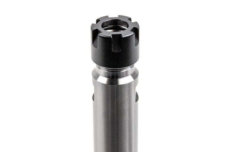

This straight shank ER11M collet extension accepts a variety of ER11M collet styles, and has a 0.625 in \ 5/8" shank, with a 6-1/2" shank length. It is primarily used as an extended-length milling collet, by clamping it into the appropriate end mill holder. The double-taper collet design provides high clamping force for round, smooth shank tools, and offers a wide gripping range with excellent TIR and balance.

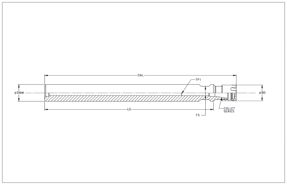

Collet Series ER-11
[ØBD] Body Diameter 0.63 in
[ØDMM] Shank Diameter 0.625 in \ 5/8"
[LS] Shank Length 6.5 in
[OAL] Overall Length 7.327 in
[FS] Flat Size 0.551 in
[TP1] Thread M6x1.0
Concentricity 0.0004”
Through Tool Coolant Yes
Weight 0.6 lbs \ 0.3 kg
